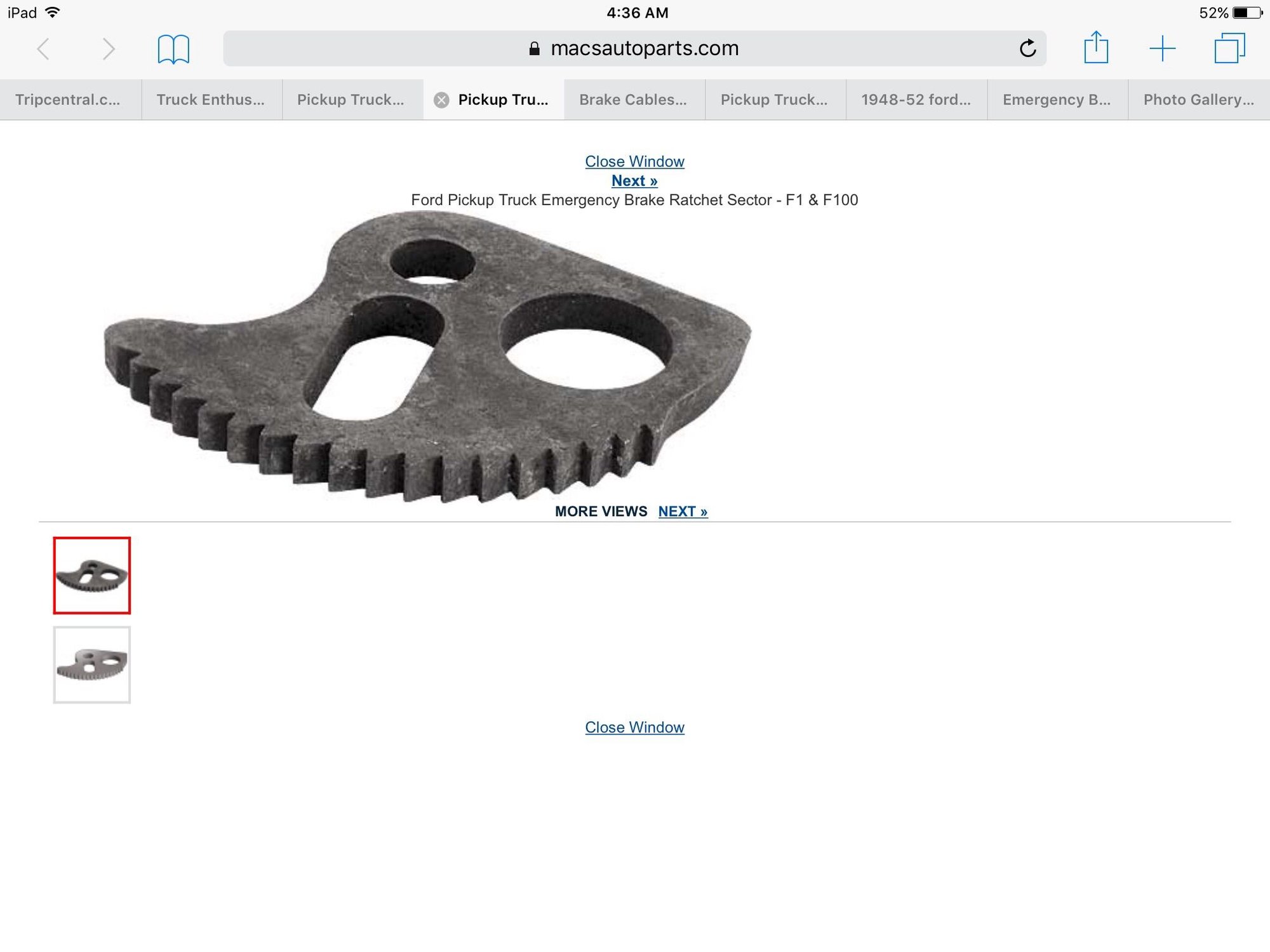

Many thanks for your reply. The picture you posted is the ratchet mechanism ?. Not sure if I can get one this side of the pond or not yet. Could you give me an address (website) where I might obtain the correct parts please. Until I take a look of course, I do not know which parts I require.

https://www.macsautoparts.com/ford_truck_late/fordpickup-truck-emergency-brake-ratchet-sector-f1-and-f100.html
https://www.macsautoparts.com/early_...kup-truck.html

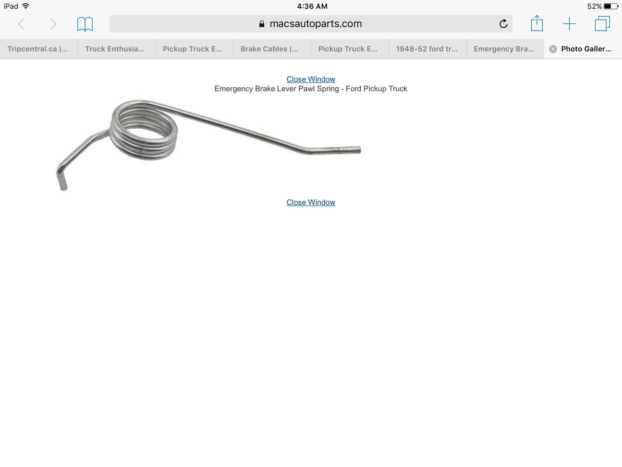

There is a small spring in the handle as well but I can't find who sells it. That could be the problem.
Ok, I found it.

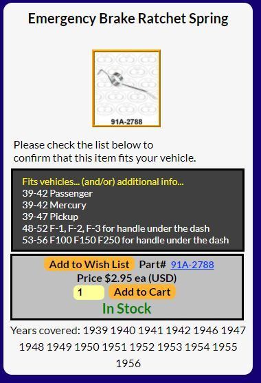

Many others have the part, which is Ford p/n 91A-2788, for instance C&G Ford Parts: https://cgfordparts.com/ufolder/ford...umber=91A-2788. Search around, you can do better! The part was used on many Fords from the '30's thru the '50's.

Thank you so much. This looks like the part. I may be able to get one this side of the pond. But at this price ...I think I know where I am going.

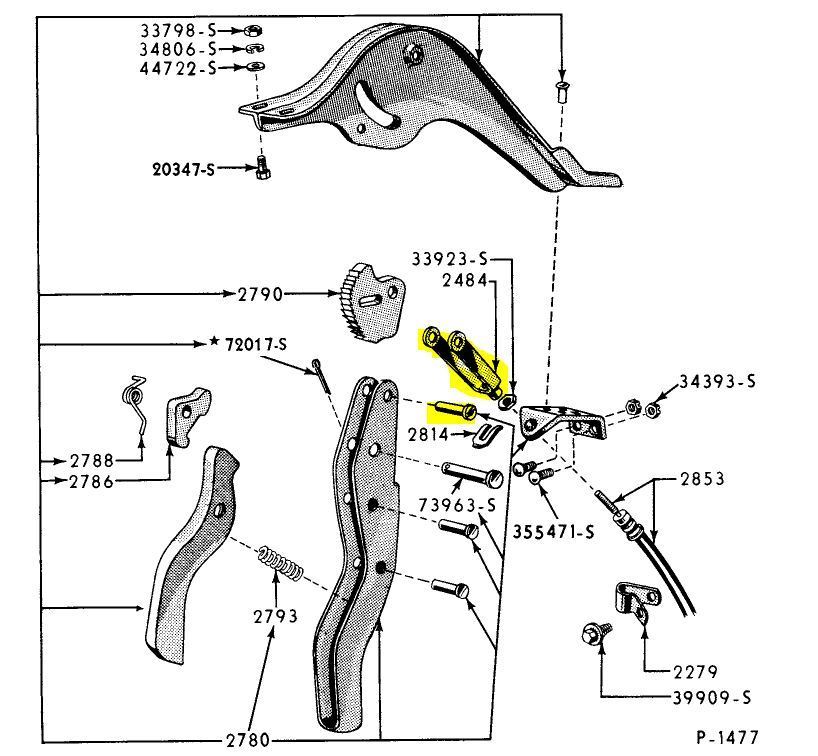

This morning I tried to remove the parking brake handle assembly. I removed the bolt that passes through the fork on the end of the brake cable, and then dropped the cable and fork away. I removed the two x 1/2" bolts holding the bottom of the handle assembly to the bulkhead. There is one more bolt holding the top of the handle assembly up under the dash, The p brake cable comes up through the cab floor and passes through a bracket with a hole in it at the bottom end of the handle assembly. I removed a circlip from the end collar. To me it looks like I now need to unscrew the fork on the end of the cable to be able to remove the handle assembly. BUT that fork does not want to unscrew, the cable appears brand new (just purchased truck). Am I doing something wrong. Any advice would be much appreciated.
After further inspection....The bolt that I removed that passes through the hole in the p brake handle and connects to the fork on the end of the cable is 5/16". This seem wrong because the holes in the handle are 7/16, as is the hole in the toothed ratchet piece. When I tried a 7/16 bolt all seemed much better, only trouble is the holes in the fork on the cable are only 5/16 so cannot connect the cable. Is it may be the wrong cable been used, or the wrong fork on cable ???

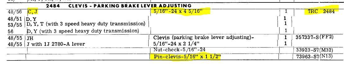

Someone has done some jury-rigging, or as we call it here, "cooty-bob'ing" on your cable. The clevis (fork) is supposed to have a plain clevis pin, 5/16" dia x 1-1/2", thru it to secure the clevis to the handle. The clevis 7RC-2484 shows to be available from MAC's, but likely others have it too. The pin should be a common hardware store piece, at least it is over here. You should be able to pull the whole handle assembly out from under the dash with the cable still attached to work on it, but probably have to remove the floor plates around the pedals to get some slack in the cable (or you could disconnect it at the back end). There is a jam nut against the clevis, make sure that has been loosened.

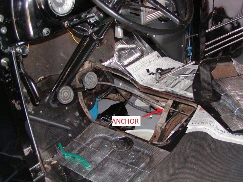

I fear whoever installed the clevis may have put one with the wrong threads on the cable. You can remove the whole cable but you'll have to remove the transmission cover from the floor of the cab, because there is a clamp holding the cable to the transmission. Then you have to disconnect a clevis on the back end of the cable, and also an anchor that is on the crossmember behind the transmission. None of that is hard, just time-consuming.
