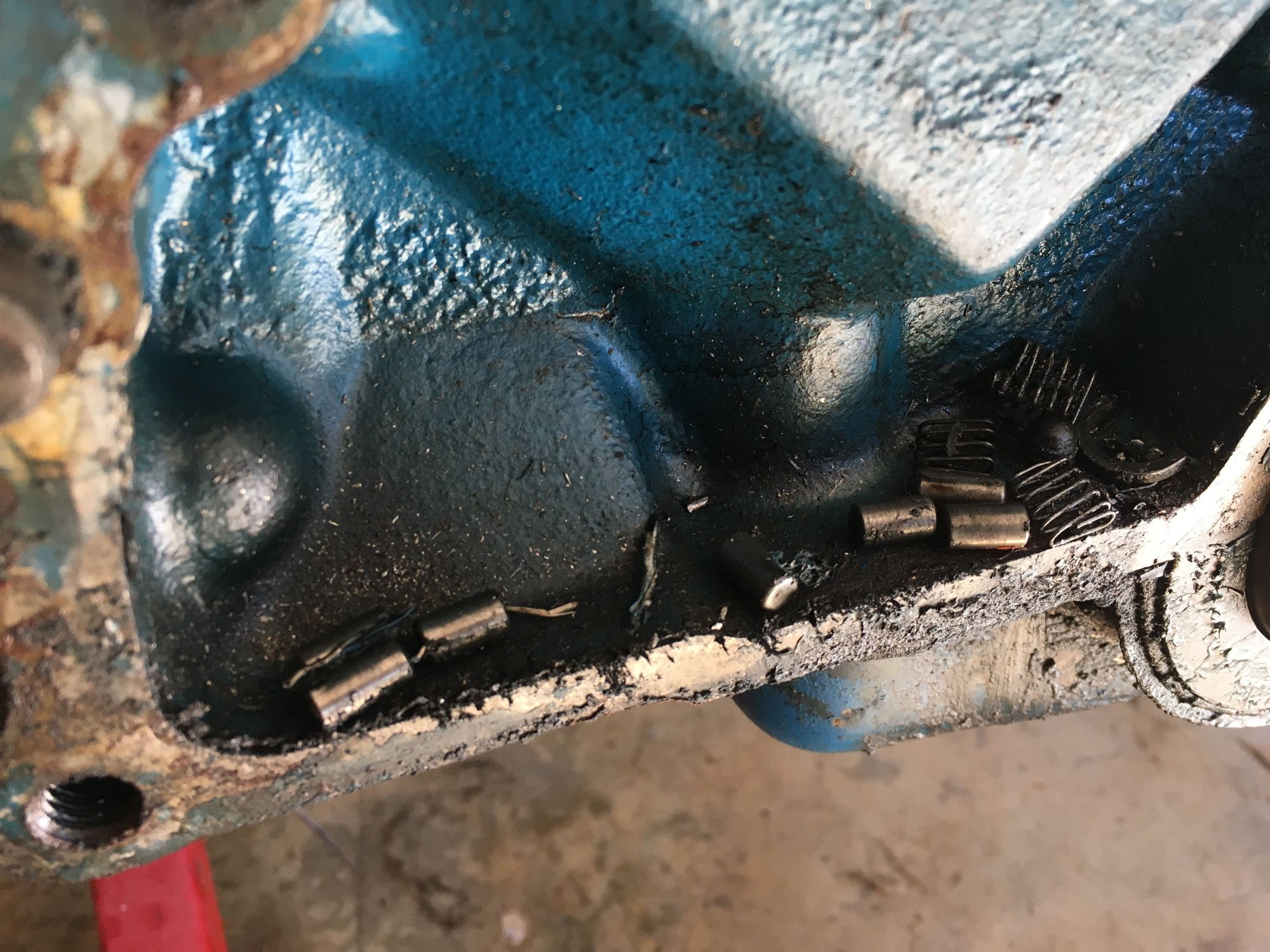

I removed my flywheel and the plate behind it and there were these strange pieces of metal. Anyone know what they are and why they might be there?

Someone may have been using this area to store parts. The cylindrical parts look like the needle bearings used on the trans' input shaft.
The curly Q parts look like the springs used on F100/150 parking brake levers (one per side).

They do look like a spring from a drum brake but they are a little smaller. People really “store” parts in this area?!

Numberdummy, Not sure either but looks like the reveres pieces inside the tail of the c6

Probably not. The rollers look about right but my rear Sprague used thin metal corrugated pieces for springs

What trans is the sprag from?

the springs are from behind the brushes in the starter.

My 74 has a C4. I could see it being pieces of the starter. Very interesting... thanks guys.

Brushes shown as basic part number 11057 .. Where are these springs? No see um .. Click on the pic twice to enlarge it.

This happened to me about a year ago! Drove me batty trying to figure it out. I found those same pieces, but mine were in the C6 bellhousing area. I finally settled on the assesment that they had come from the starter. I cant remember what had convinced me though...

11059 is the springs for the brushes in the starter pics
could they be out of the starter Bendix?? I never had one apart, so I don't know.

http://www.idmsvcs.com/2vmod/starter...e/PICT6601.jpg
the look a alot like the brush springs, https://www.amscovf.com/SPRING-BRUSH..._p_309707.html
but with the presence of the pins, most likely bendix guts...as seen in the pic above...

Looks like bendix (starter drive) guts to me as well.
Brush springs are unlikely since they are located in the rear of the starter and would be unable to get past the armature to the drive end.
