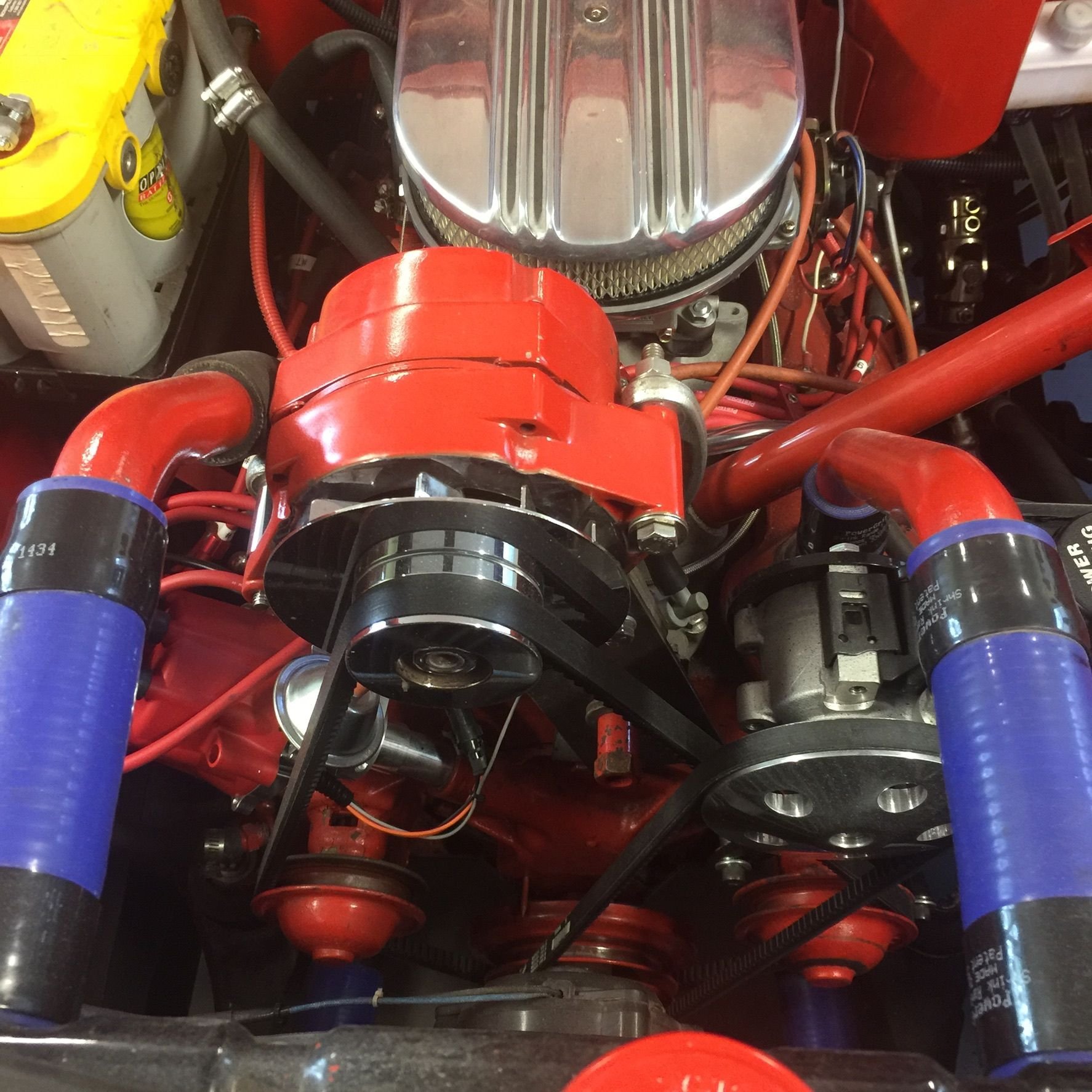

I am using silicone hose for my vacuum runs. My pump pulls between 22 and 24 inches of vacuum and so far no collapse of the hose. Silicone is very durable and impervious to temperature extremes and chemicals. I chose blue to match my paint but there are other colors available.
I am a huge fan of silicone, used it on the heater and upper and lower radiator hoses. I am not sure how it would work on a long run for vacuum 6' and longer. Unless it is a different product with some support within the walls.
