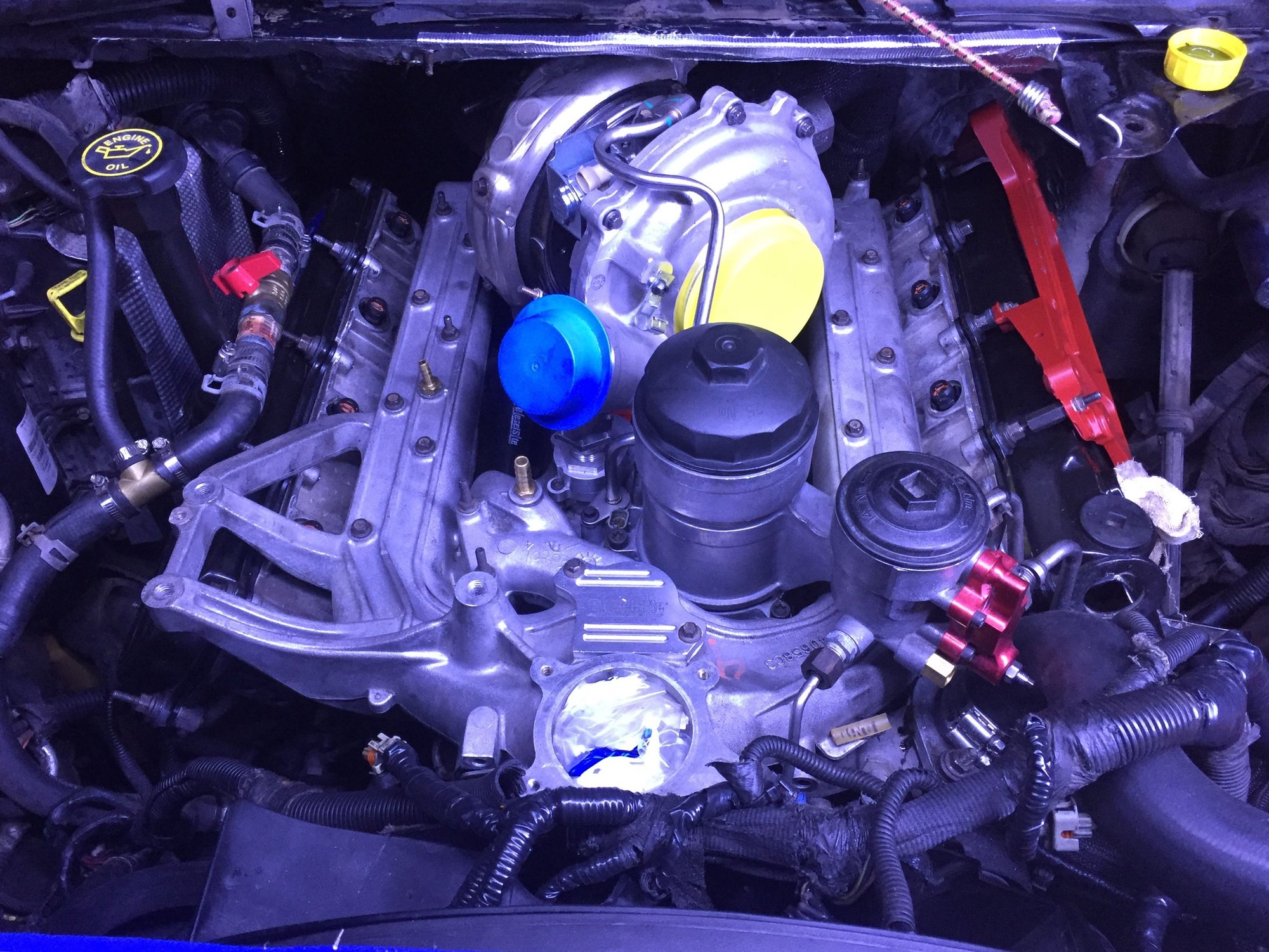

I just installed a new Powermax and RiffRaff billet wheel on my Excursion as part of a major string of upgrades. I rebuilt my stock injectors with new spool valves, 30% over nozzles, solenoids and new o-rings. I kept my stock fuel system other than a blue spring and adjustable fuel pressure regulator to crank up my fuel pressure to 65-68psi. I already had Gearhead SRL+, unlimited towing and 8k tow tunes from Matt.
