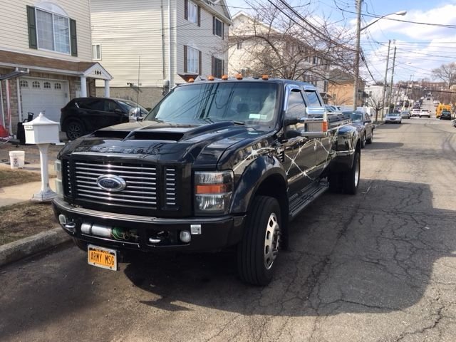

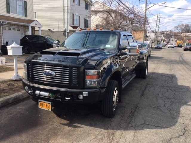

so I took the day off to install.
you get special windshield washer nozzles so Im glad I did not buy any extra.
needed a hoist to take off the old, but the new one was lighter so I was able to get it installed with out the hoist.
took a few hours.

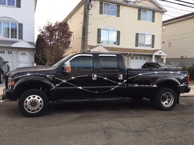

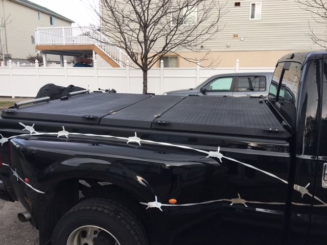

like how the hood looks.. but 2 questions.. can we get a pic of the custom job you have there on the side?? and whats the green and silver thing hiding in your bumper there above your plate?

green thing is an oil pre-luber. when you turn the key it sends 50 PSI of oil into the engine oil system. by the time the engine spins once, the oil system is fully pressurized.
goal is to ensure all rocker tips , bearings...lifters...get lubed .
normally when you crank the 6.4, only 12 psi of oil is generated at startup....with only 12psi...it takes a wile for lifters and rockers to get lubed up.
Let me see if I can get side shots.

ahh i had heard of those but hadnt seen one other than the one Stacey Davis did when he was still on the TNT's show TRUCKS.. he did it on a jeep if i remember right.. was thinking maybe it was your oxygen storage tank for rescue work or something lol.
Edit for the new pics: Like the barbed wire pattern down the sides..

Barb wire look?

I actually need to move it under chassis.
I got stopped a few times before going into tunnels and get questioned if its compressed gas...since no compressed gas is allowed in tunnels.
I tell them its oil tank and have to show then where it connects to the oil filter cap.
