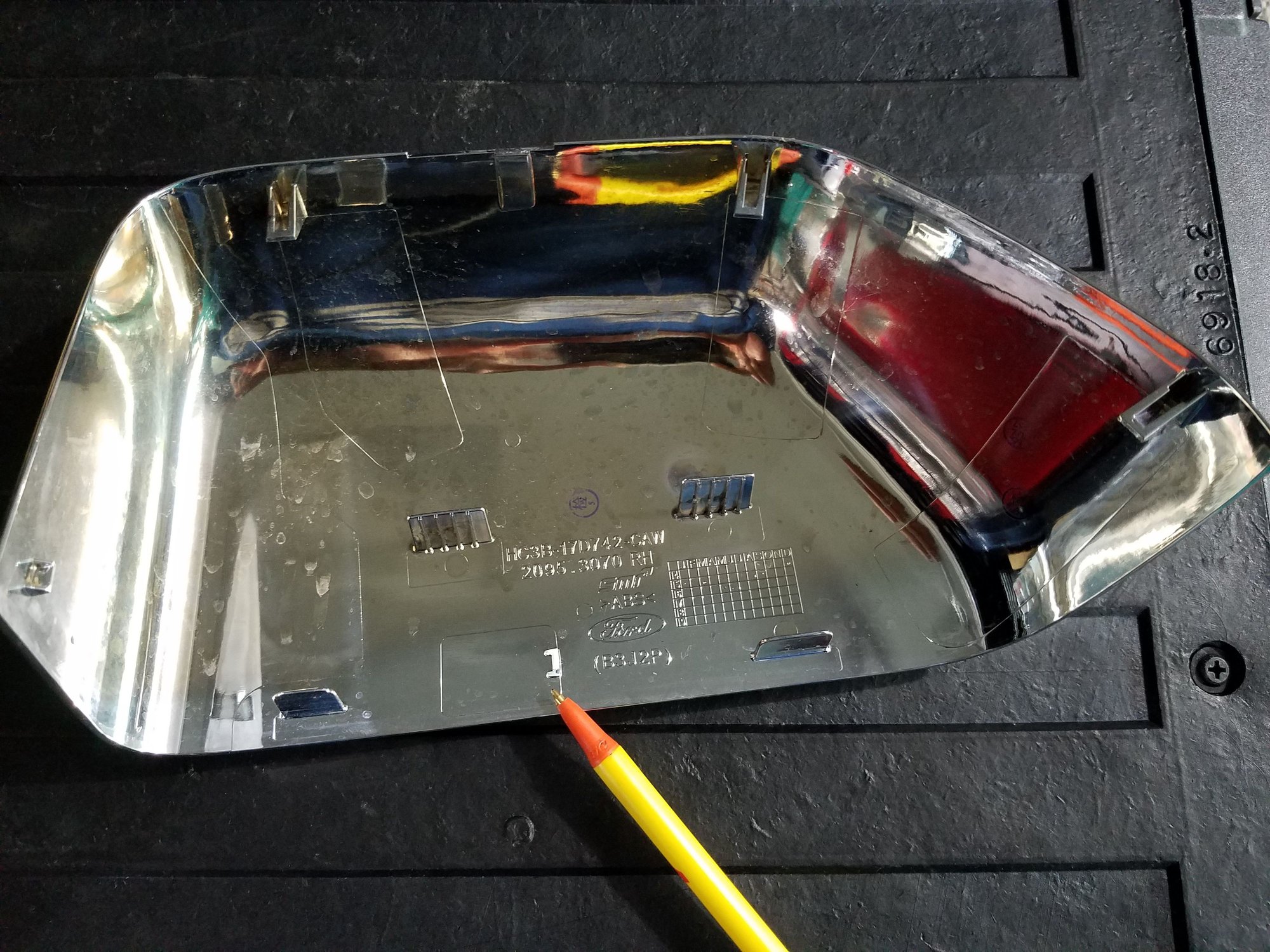

Originally Posted by acelefty
Do the chrome caps just pop off and those black caps pop right on?
Here is a pic of the chrome cap.
This is the right side mirror cap. If you tilt you mirror down and to the inside, using a flashlight, you'll see the 3 clips that need to be released. Looking at the pic above, you'll note 2 stand-offs at the top, and one at the bottom right. These stand-offs are secure by clips visible behind the mirror. The 3 clips are relatively easy to release with a flat blade screwdriver, reaching in behind the mirror..
The pen points to the "sacrificial" clip that is nearly impossible to release without major mirror disassembly. Once the other 3 clips are released, pull the mirror toward the front of the truck in a sharp controlled manner, allowing the cap to pivot downward slightly. This allows that sacrificial clip to snap off pretty easily. Take a small screwdriver and pop out the remnant of the clip. One of mine fell inside the mirror and I didn't worry about it. Snap the new caps on. Easy-peasy. Chrome sucks, nobody wants used caps.
