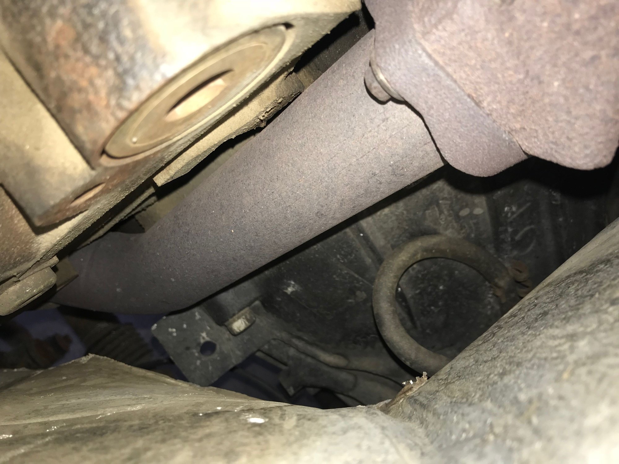

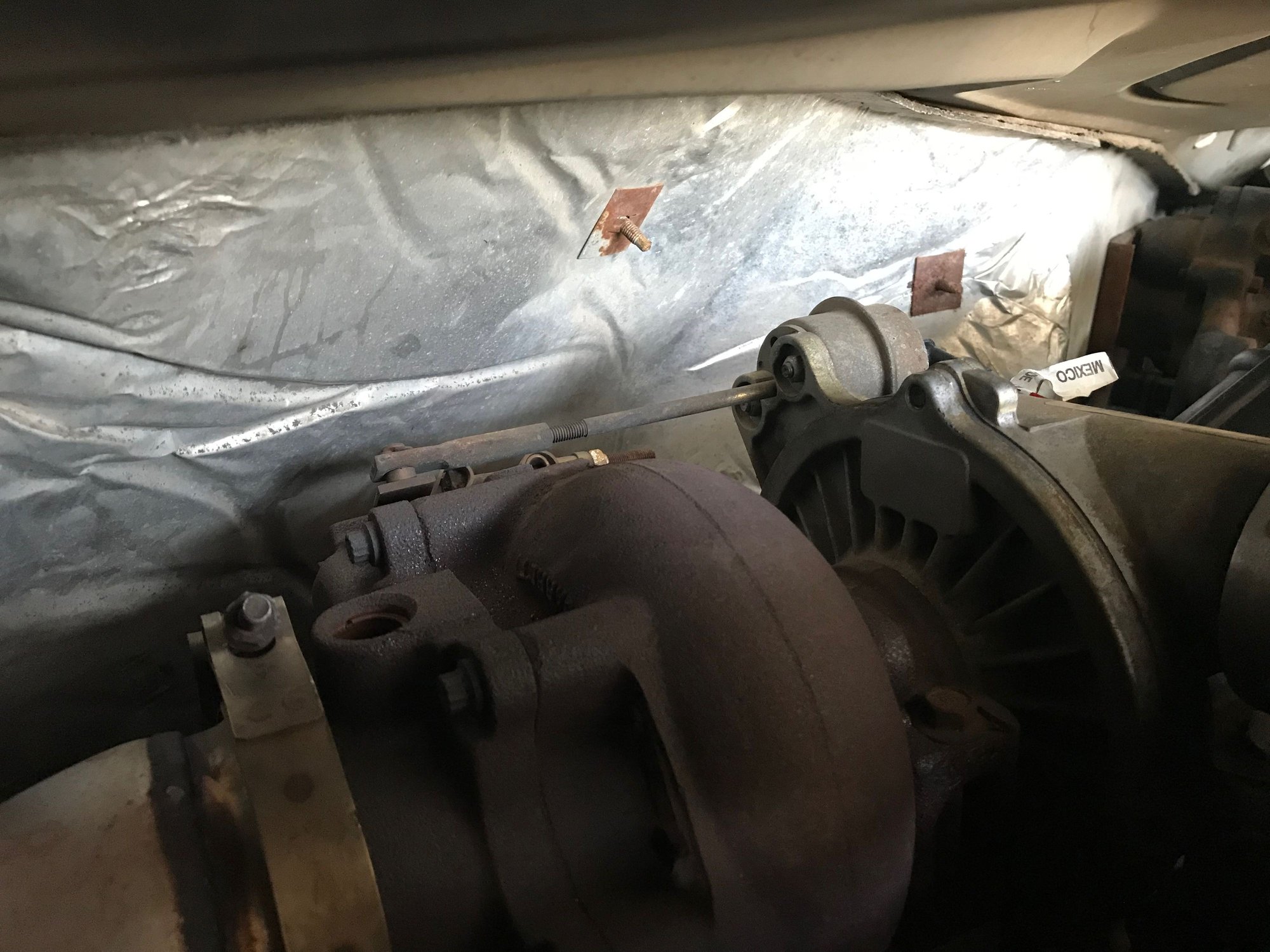

I crawled under it last night and tried to take some pictures, I wasn't able to get a good one of the passenger side, but I believe they are original. No signs of black soot either.

It doesn't look like you have any huge leaks.
The place where soot would be most evident would be at the connection of the 2 up pipes and the back of the turbo. Looks like some black in the one picture but hard to tell. The original design was a couple of doughnut style gaskets and they wear over time. This can be a source of lost pressure to drive the turbo. Try to stick the camera up close and get shots of that area.

Yep there is nothing obviouly leaking, but you need to do a boost leak test first.It the tubo intake drive side is not pushing much the exhust side will be doing a lot less work.
If you can build 20pig of boost, you are much more likely to find the up pipes leaking than if you can't break 10 psig!
