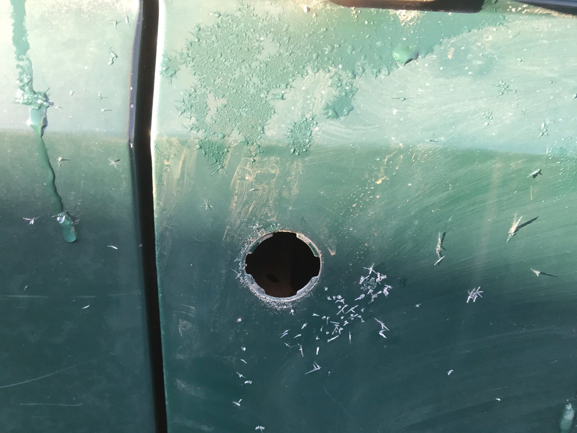

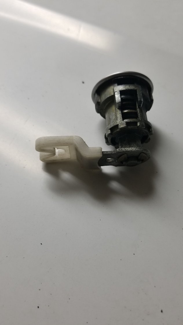

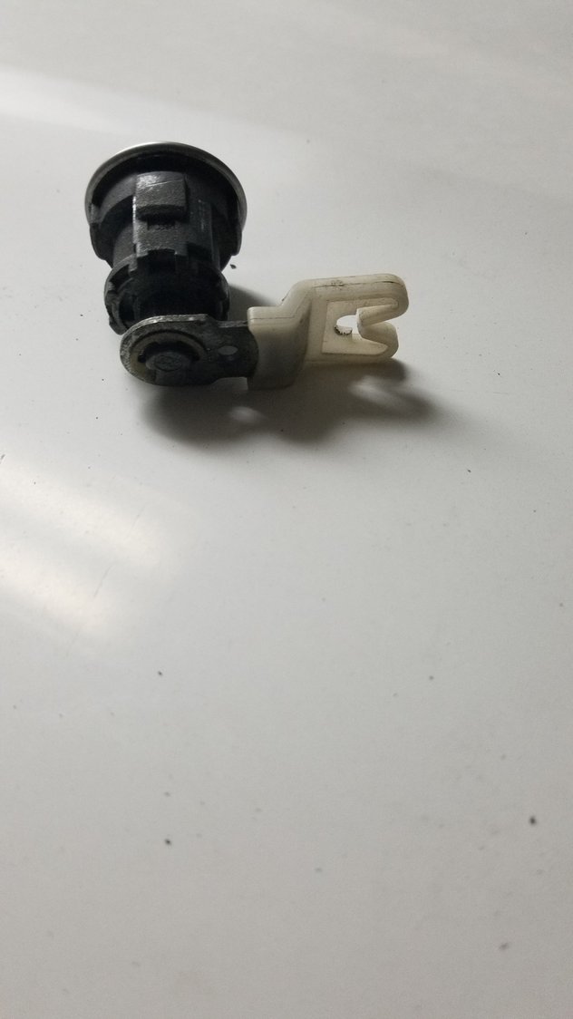

Pics
Here are some pics
Here is the door to the other truck. My truck doesn't have this pattern cut in the door.

Yeah they are different - learned this the hard way myself. I think 96-97 are different than previous.
