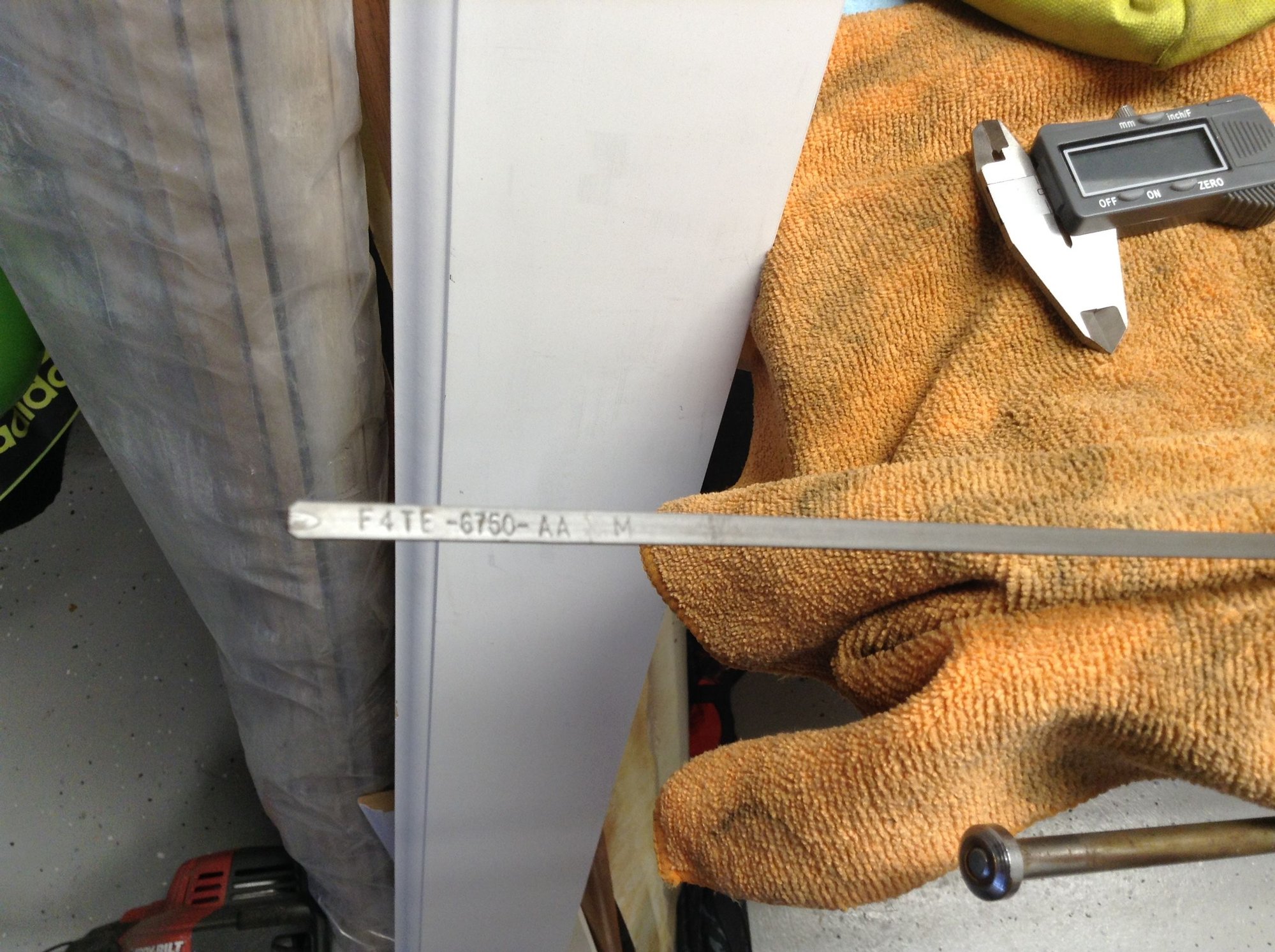

I bought a dipstick and tube from JBG several years ago for my 351M/400 4x4 rear sump oilpan with (if I recall correctly) 5/8-20 thread into the drivers side sump. It is on my 400 and reads exactly full with 6 quarts of oil. I checked today and the part number on the dipstick is F4TE-6750-AA M.
The dipstick is 24.25 inches from tip to bottom of grip and is 28 inches in total length.

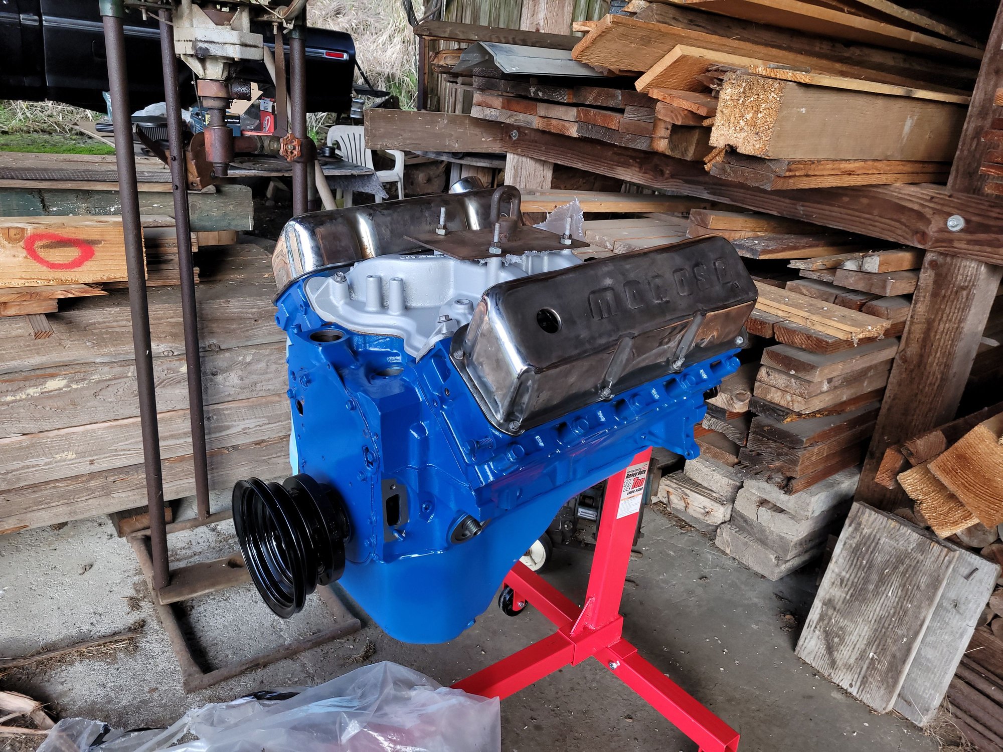

I just so happen to have an oil pan on a 351/400 on an engine stand. Maybe someone needs to make a trade for a dipstick.

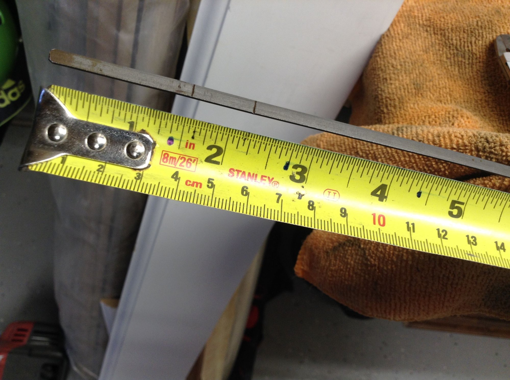

It is 2.25 inches from dipstick tip to the full line and 6 quarts lines up exactly at the full line.
2.25 Inches From Tip t Full
Part# F4TE-6750-AA M
351M/400 Dipstick 4x4 Rear Sump Pan

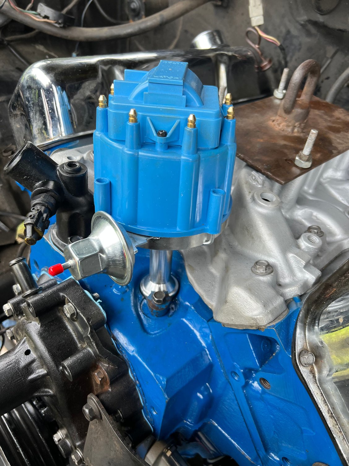

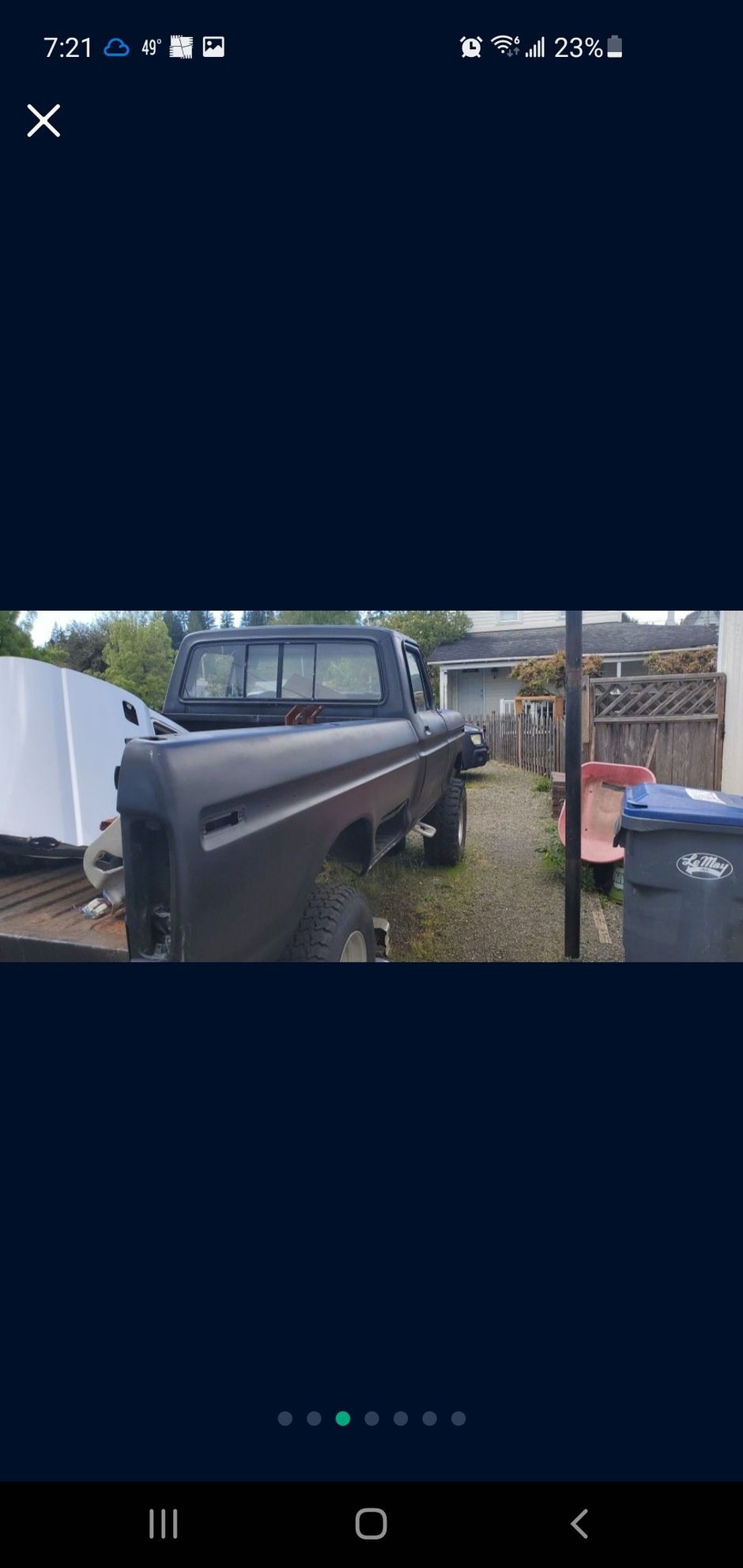

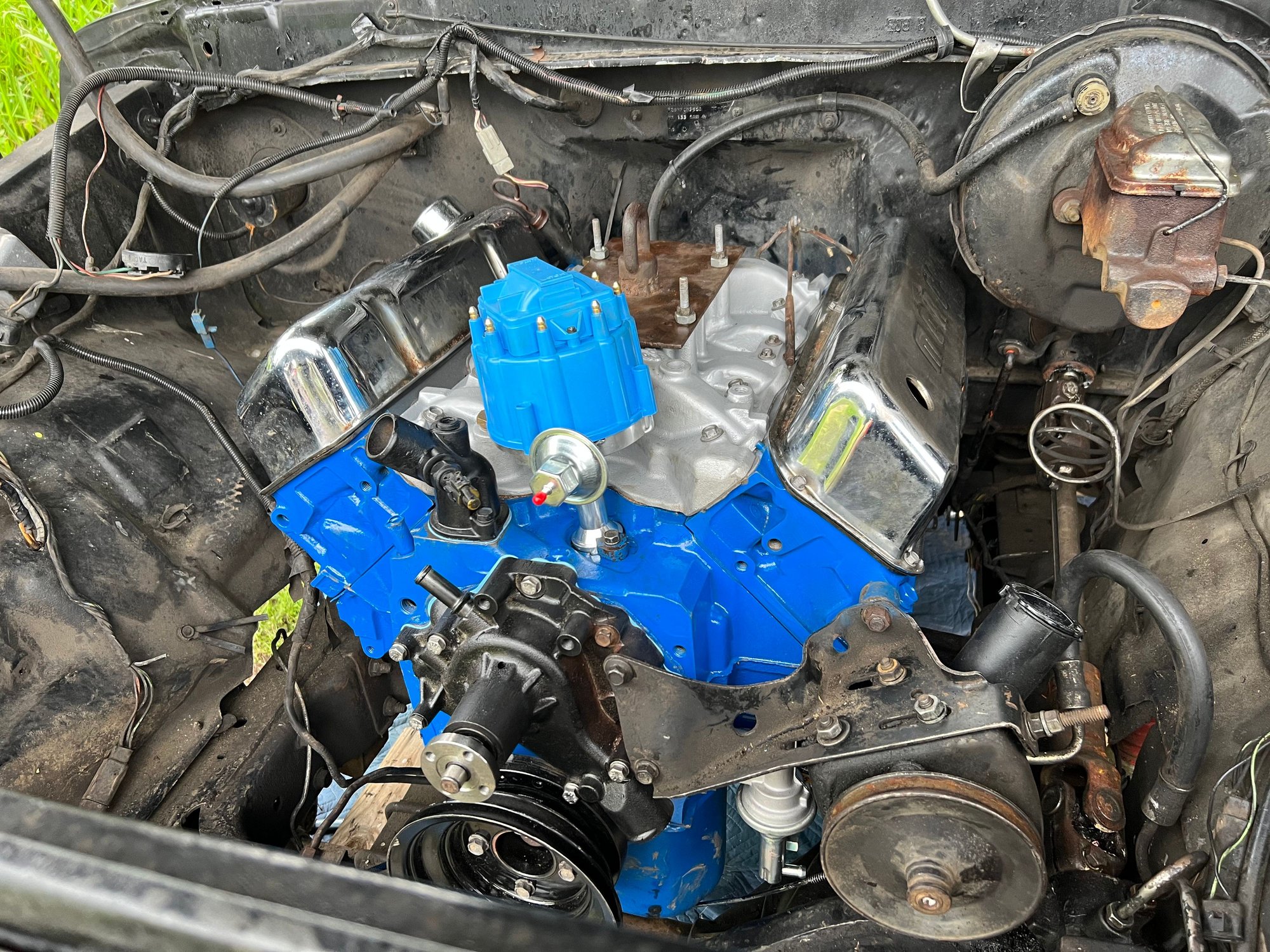

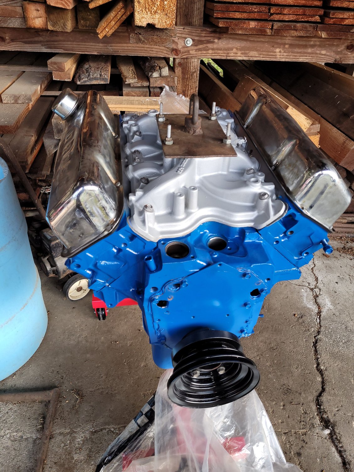

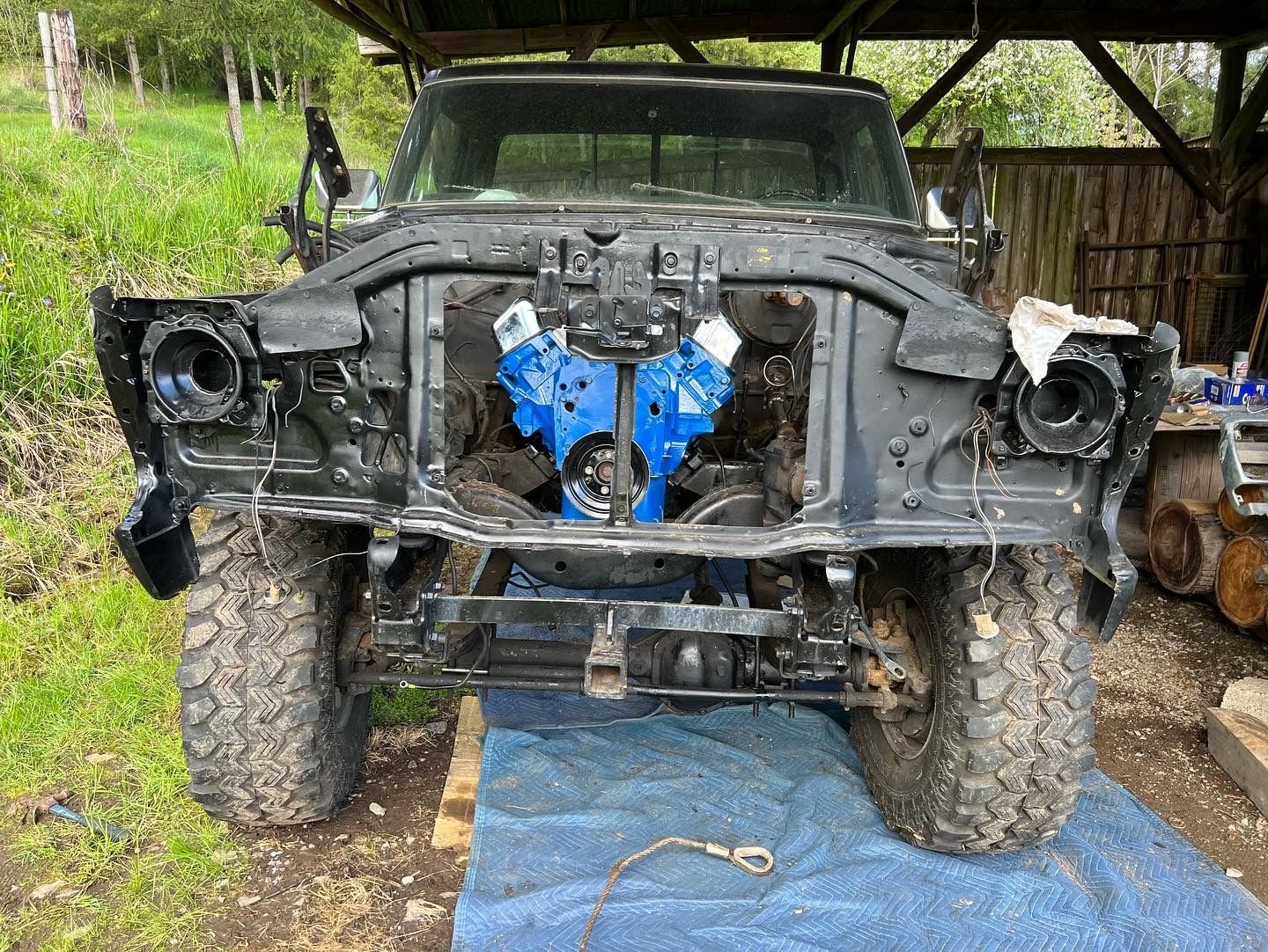

I have a 78 351 that I made into a 400 and I put it in my truck and There is a plug in the front where
the oil dipstick goes and it’s a 78 f250 4x4

Originally Posted by BD2064
I have a ......
Looks like a front sump 2wd oil pan up there, my '77 351M has rear sump with dip stick over on driver side of engine .. it's a 4wd. Takes 6 quarts to bring to full, but if I change filter, I use 7. If ever a dip stick goes missing, drain the oil in a clean container, measure, pour 6 back in, use a dip stick kit and mark it.
