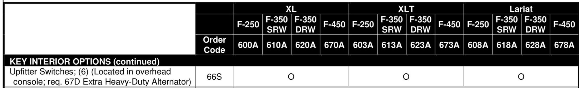

The first issue probably has something to do with alternator dependencies. Certainly no restriction with that combo. What engine? There is a chart in ordering guide that explains the base computer selected alternator based on electrical options to include both snowplow and upfitter switches.

OK, that combo would require the largest alternator (67E, Extra, Extra heavy duty), Verify he had checked that and not just 67D.
Yes, SYNC 3 in XL does force UT camera system , which would also force CHMSL camera

For 2017 & 2018 trucks, Upfitter switches only tied to having extra heavy duty alternator. Re-check with your dealer again.
