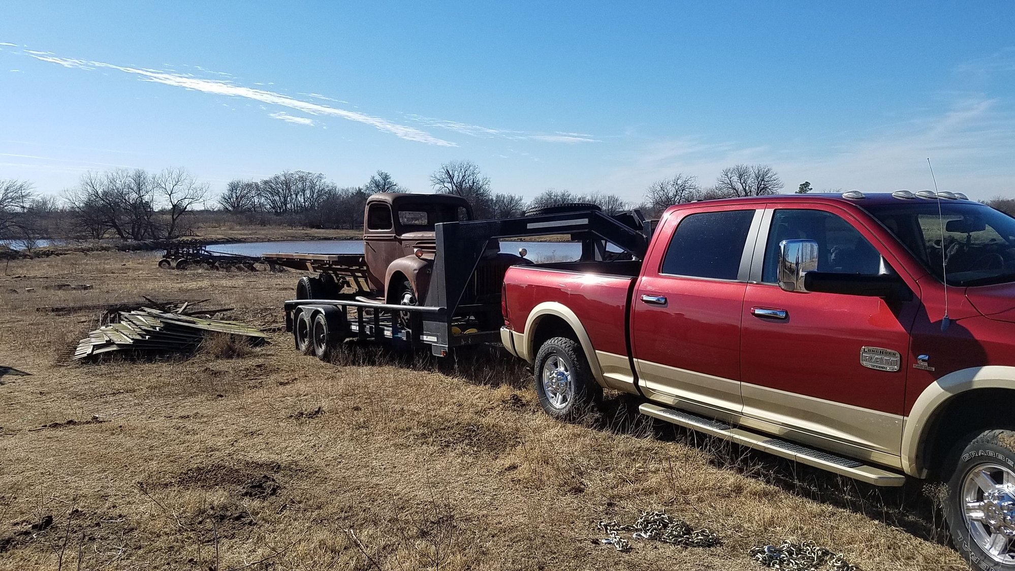

Hello.
Does anyone know if the cab of the 47 Ford pickup is the same size as the 47 Ford 1.5T flatbed truck?
Or, is there another year model cab that would work on the 47 Ford 1.5T flatbed?

The cabs are the same on '42-'47 1/2 ton thru 2 ton truck.

One thing to keep in mind is the fenders look the same as pickup fenders and will bolt up, but the big trucks have a larger wheel opening. Many have failed to notice this and bought some at a swap meet that didn't work out. Where are you located? And of course we all like pictures.

The fenders are usable so I will reuse those. I just need a cab. I'm located in Deridder, La.

My father purchased in Oklahoma in 1999. He passed away in 2014. I drove to Oklahoma and hauled it down to Louisiana.
The usual rust spots are on it: lower part of door and lower cab corners. The worst rust is the floorboard. It is nearly 80% gone.
