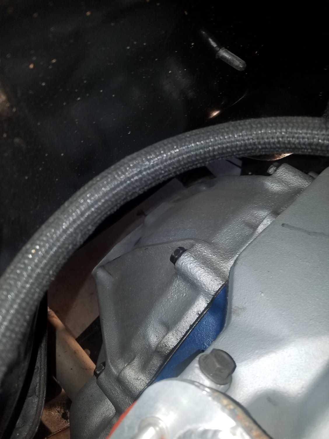

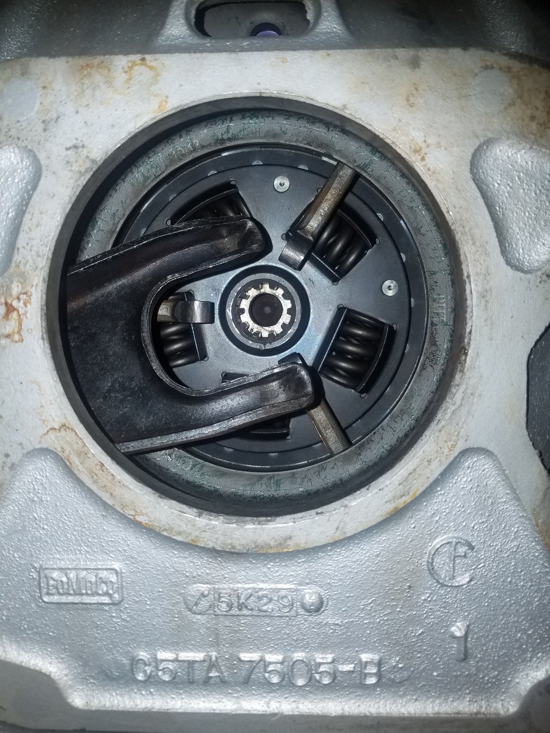

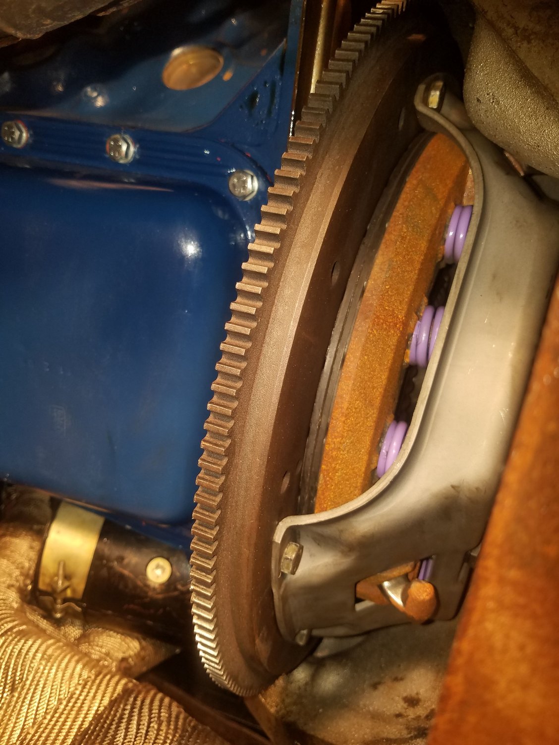

Old Jun 12, 2018 | 11:58 AM
hollywoodusmc's Avatar
hollywoodusmc
Joined: Mar 2016
Posts: 17

I see from your pictures that you have a bell housing from a 65-66 truck maybe you should be using a clutch and pressure plate for 1966, 352 truck.
Also make sure the centering flange on your transmission is the same diameter as the hole in the bell housing.

Originally Posted by hollywoodusmc
T10H-1: Borg-Warner T-10 4 speed from a 1965/66 Mustang/Falcon/Fairlane/Comet 289.
C5TA-7505-B = 1965/76 F100/350 FE bell housing.
D0TZ-7505-A (replaced C5TZ-7505-B) .. 352/360/390 Bell Housing / Marked: C5TA-7505-B / Obsolete
5K29: Bell housing cast October (K) 29, 1965 (5).
1965/66 F100/250 2WD; 1966 F100 4WD; 1967/76 F100/250 2WD/4WD & F350.
