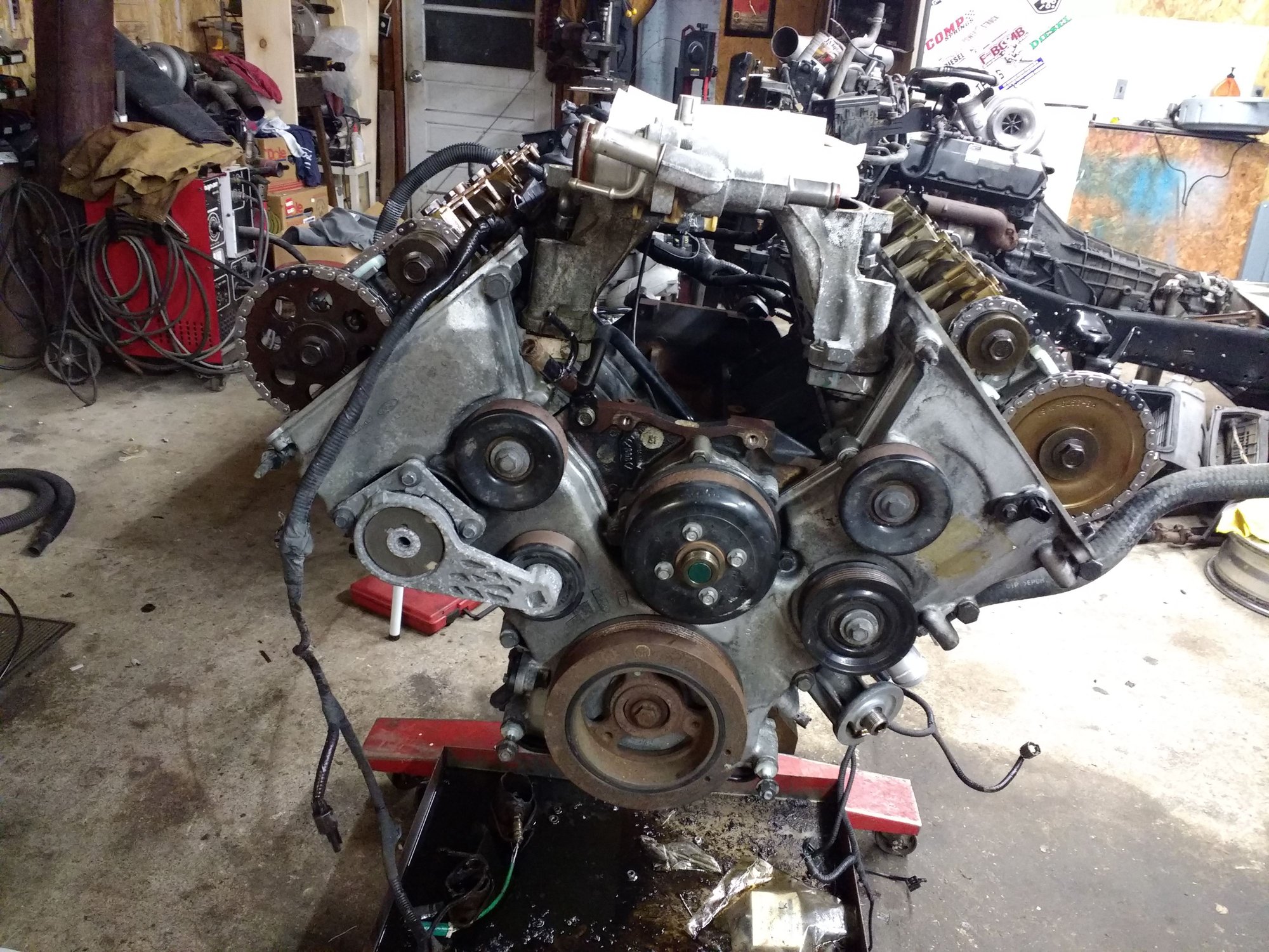

As I expected. One chain guide has zero plastic material and the other has a good start on falling apart. Hopefully Thursday I will get parts ordered...

How does the valvetrain look? Rollers and adjusters good?
Yea as far as I can tell the engine is very clean and seems to have been well kept. I may pull a couple cam caps off but I don't expect to find anything out of place.

Here we go. Let's get this party started.

Not that I did much today but I did flip it over right side up. I spun the engine over and it lukily has not jumped time. Hopefully my buddy will ring the timing chain tools tomorrow.
Ummm, what timing chain tools? In my years of working for various Ford dealers since 2000, I have never needed to use any tools to time any 4.6/5.4/6.8 engine. I simply fold each chain in half and align the two copper links to cam sprocket alignment mark and the single copper link to the crank sprocket mark at the 6 o'clock position and we're timed. That is unless you are referring to the tool that secures the crank?
The cam clamp and the tool that lines the cams up from the rear. I'm going to do secondary chains and tensioners along with primaries. I didn't do the secondary tensioners on my 97 cobra and of course one of them wouldn't keep tension. I had to tear back into it in the car. Not the end of the world but something I shouldn't have had to do. I could do this without the tools but I'm going to be extra safe since they are 3 blocks away lol.
Thanks. I really want to stab this back in this coming weekend. I pushed the body outside but it's blocking my only open bay. Aannddd I'm ready to be driving it also.

As it turns out the tensioned side was worn badly also. I am very surprised for as clean as it is inside.
new hardware installed. Tc installed, manifolds removed,clean surfaces,new gaskets,studs,nuts torqued to oe spec. These suckers had better not leak..

Oil filter gasket split and detoriated,intake gaskets detoriated. New manifold parts /resealed manifolds.

I need a drain plug,oil,filter and a few tidbits installed tonight and it'll be ready to stab in.
im hoping tomorrow night to shove the body back in and work at pumping the fuel tank empty of the nasty old fuel.
