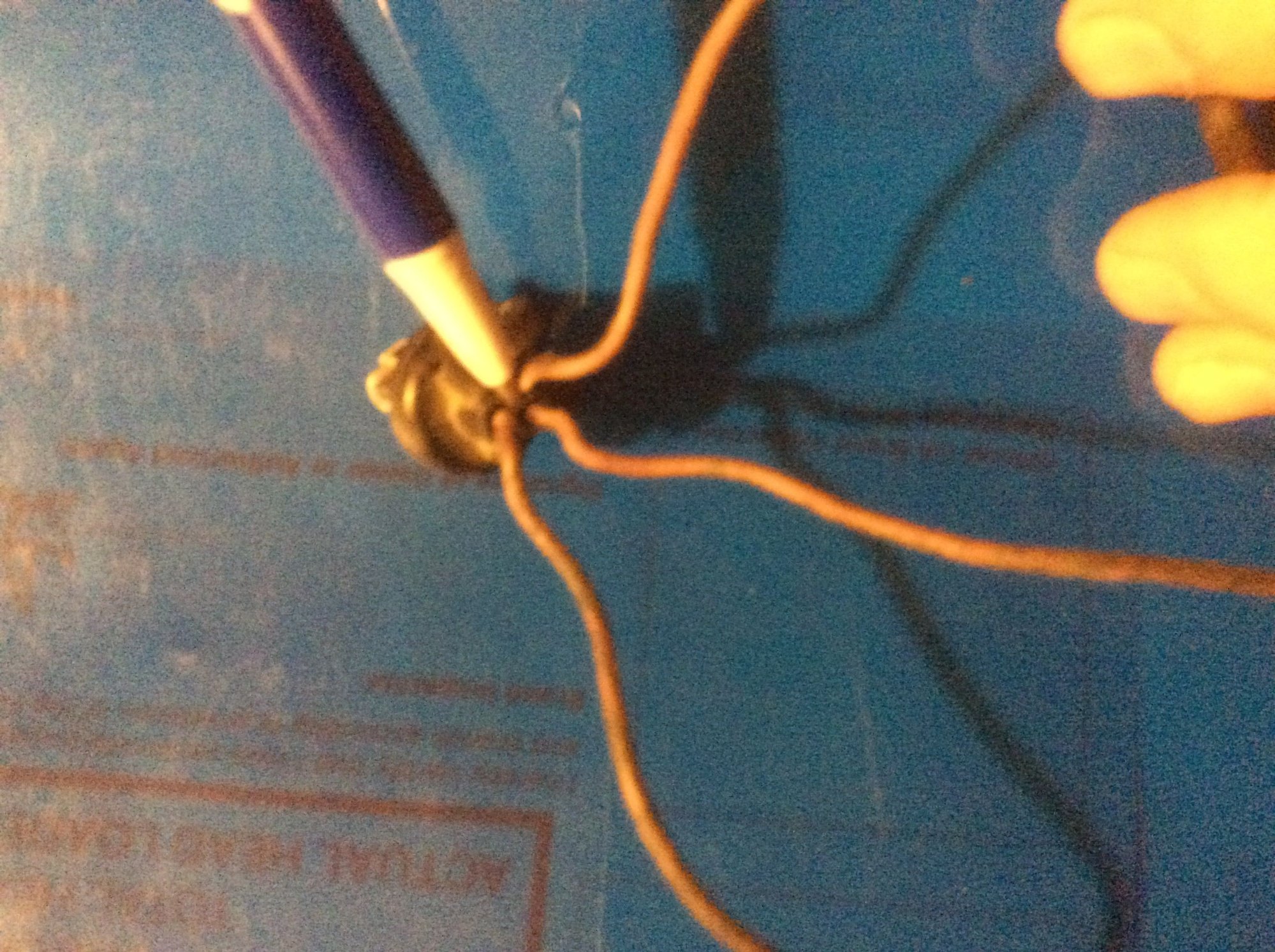

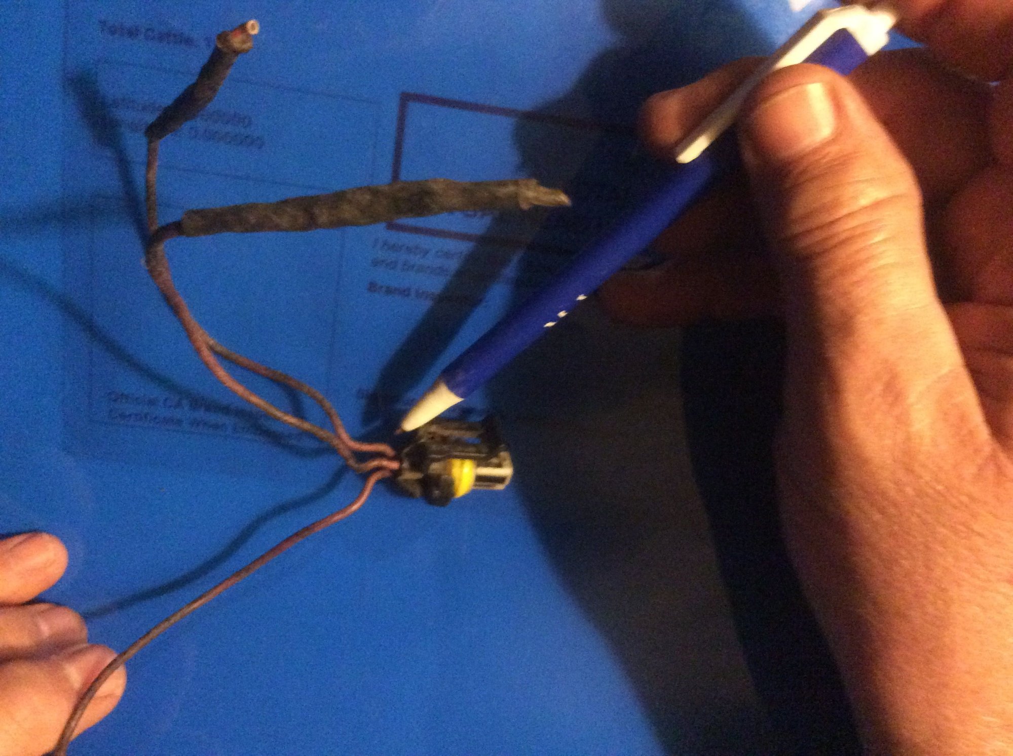

I found little white marks on the three wires after taking the clip off , those were shorts in the wiring , ended up replacing the pig tail, not hard to do , just pay attention wire for wire , I’ll try and post up a picture , may not be your issue but most common in our trucks

Hard to see the white spot my pen is pointing to , but when looking at the wire with out the photo , I can see better , very Visable.

I started up the truck and messed with the pigtail with no effect and did my best inspecting it. Afterwards took it for a drive and ran great. I may just replace the pig tail next week after paycheck hits.
