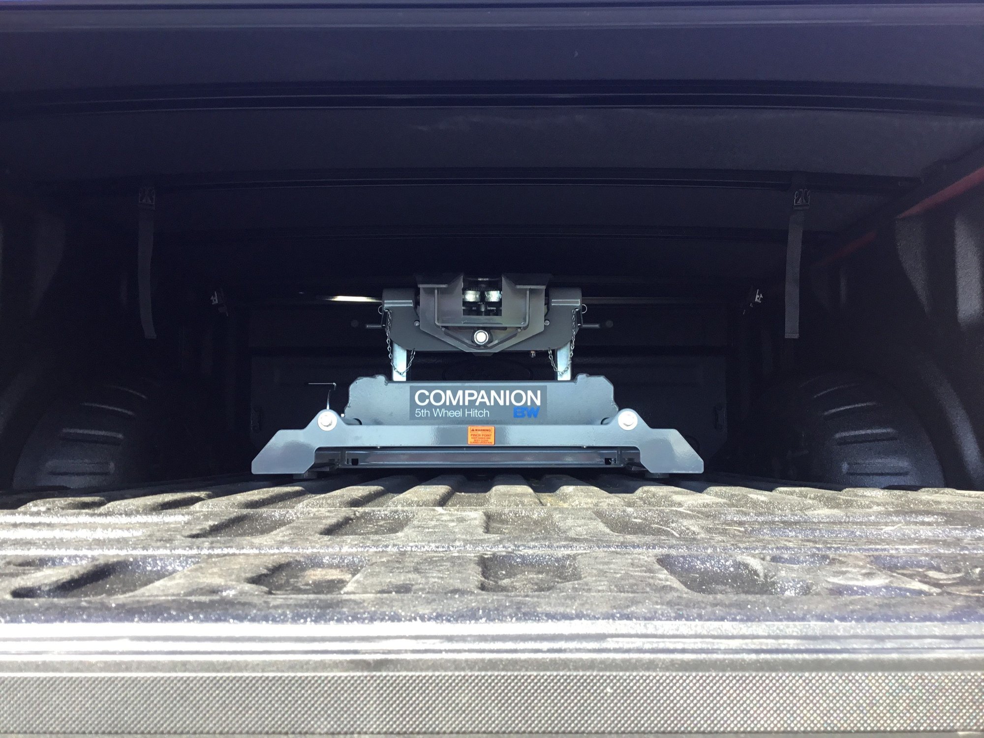

Andersen just came out with a safety chain plate that slips over the trucks gooseball before installing the hitch.
The safety chain plate is sold either by itself or in a kit with chains
https://andersenhitches.com/Products...ith-plate.aspx
The other option is to cut 3-1/8” holes in the base of the hitch like I did to enable use of the ford pucks.
If you decide to cut holes measure the placement of Your Hole Locations before cutting. Some have reported slightly different locations.
