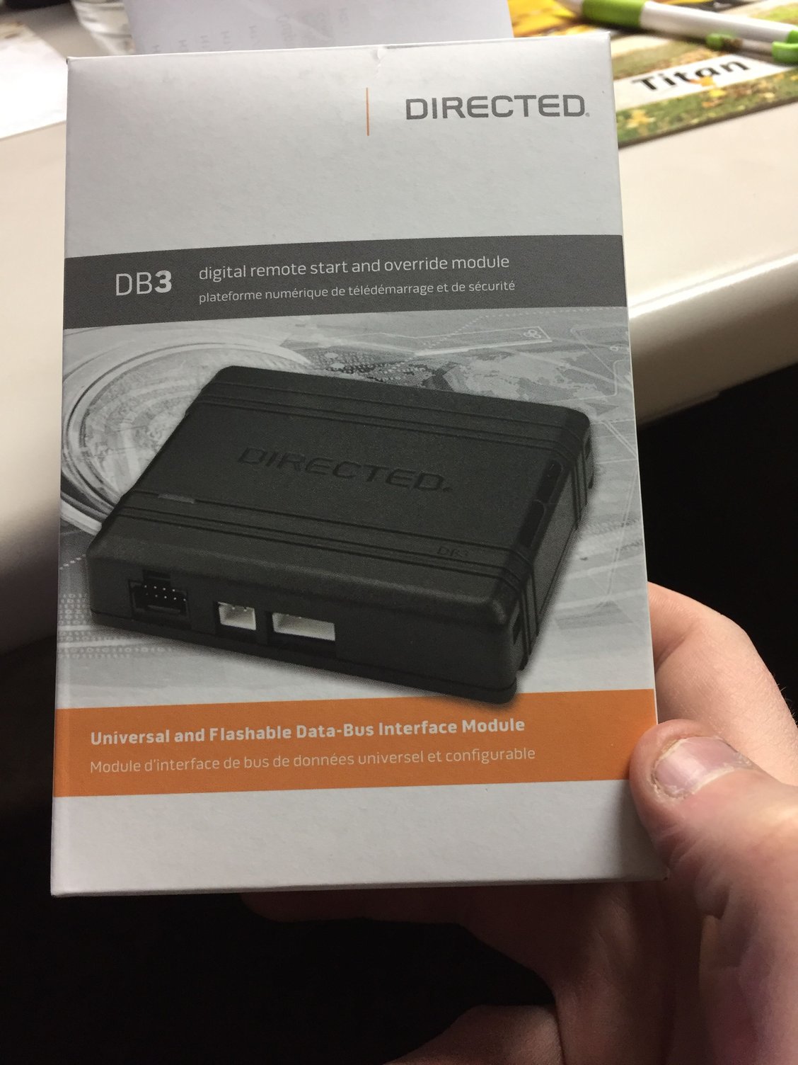

I have the facotry remote start on the key fob.
Now my brother truck did not have it from facotry but for 60$ he added remote start to facotry key fob! Pretty sweet just hit the lock 3 times and it starts and if u hit the brake pedal the truck shuts off without the key in the ignition.

do we have a parts list with numbers for those that may want to add as well? Does the dealer or Forscan have to activate?

Seems like it would be as simple as a new Key Fob and turning something on with IDS or Forscan.....

The factory remote start 4 button key fob is 902mhz, if your truck did not come with remote start from factory your remotes are 315mhz so getting a 4 button remote will not work.

it was a directed remote start unit. It’s 6 wires to the obd2 port, and 3 wires to the headlight switch. Wire it all up and turn the key to on and it programs the box. Shut it off and your in business. I’ll get part numbers later or make a post about it. It’s very easy to install and take about 20 mins. Hit Lock 3 times on factory key and she starts. If you want to unlock more options on the dash you can fordscan to change run time, auto or manual climate control. I didn’t do that because it automatically turns the defrost/heated mirrors on or in the summer it turns on the ac with out the scan.

That sounds so easy. If you make a post about it, that'd be gravy

Any update on the parts needed for this upgrade? Picked up my F250 Today and want to add this ASAP. Thanks in advance.

Here is the part .. now pricing will be different my buddy hook up my brother on this
