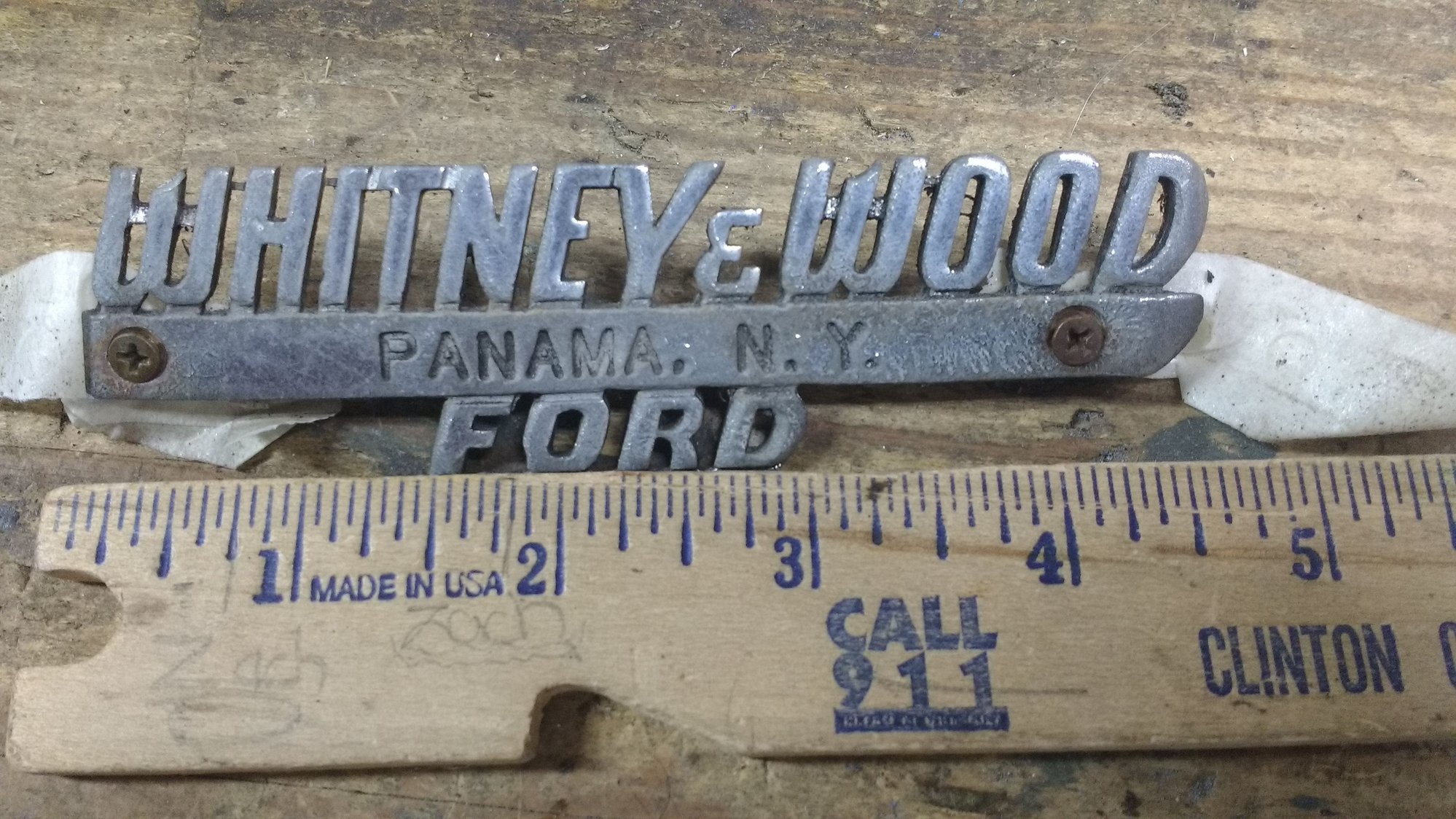

Originally Posted by abe
I am taking my 55 F350 to the body shop on Sunday. I took off the emblems in preparation. There is a rechrome shop in Middletown, PA about 2 hours away from me. I called and spoke to a guy and then emailed him pictures of the V-8 grille emblem, and the F350 hood side emblems. I am waiting for his estimate. When I get it I will post it here.
The chrome shop got back to me....
Here are pics of the pieces I wanted an estimate on:
Here is a portion of his email:
"The F350 emblems will be in the $200 range each, possibly less. The v-8 emblem will be in the $135 range and the dealer emblem will be in the $115 range. Our turnaround time is pushing 12 weeks."
Well it looks like I will just have to put up with some pitted F350 emblems! I knew it would not be cheap but, Wow!
Yesterday I bought a new Seconds '55 V-8 grille emblem from Carpenter on ebay for 29.95.... half the price of the good ones Carpenter sells. I figured it is good enough for a work truck. I will show pics of it when I get it. Here is the ebay link with pics: https://www.ebay.com/itm/1955-FORD-T...72.m2749.l2649
