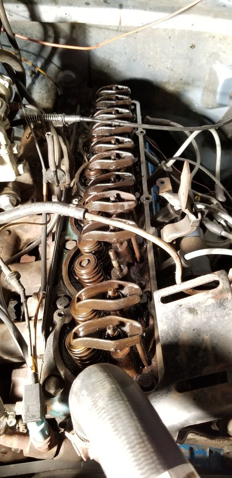

Ok went ahead and removed valve cover tonight to have a look. I notice a couple rocker arms loose so I tightened them. Then I started truck to see if they all was moving as they should. One was not moving. It appears to be on the number 2 cylinder so I pulled plug wire on that cylinder. It idled ruff but backfiring through carb stopped. Any ideas why that rocker wasn't moving.

Here's a pic of the one that wasn't moving.

Could be a bad lifter, bent pushrod or worst case a bad cam lobe

Ok so now here' the big question. How would I determine which one it is?

Long as the push rod looks straight its ok, the lifter is cheap and worth a try though everyone will tell you that tha cam and all the lifters have to be replaced together i have replaced just one with no issues of course you may get the side cover off and find pieces of lifter every where. If everything else looks ok then you will need a cam which is not a bad job just time consuming and you have to remove the radiator, condensor and the grille to slide it out.

Ok I read on another post to put the push rod back in hold finger on it while cranking engine to see if it moves. It did so that' good not a flattened cam lobe. So could be dealing with a bad lifter or bent push rod.
