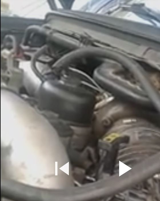

anyone know what is causing this squeal? New pulleys, reconditioned turbo both done after this squeal started. can't pinpoint where it's coming from but it's really getting on my nerves. hopefully this link to my you tube of the sound works. https://www.youtube.com/watch?v=jB6K...ature=youtu.be
So far have checked running without the belt to eliminate possible pulley issue. checked degas bottle. check out the turbo and no apparent issues with that. checked intake of possible leaks. checked heat shield on turbo.

Have tried it. no good. sounds like coming from the rear of the engine but hard to tell for sure. the turbo and bearing in it are all good so not from that either.

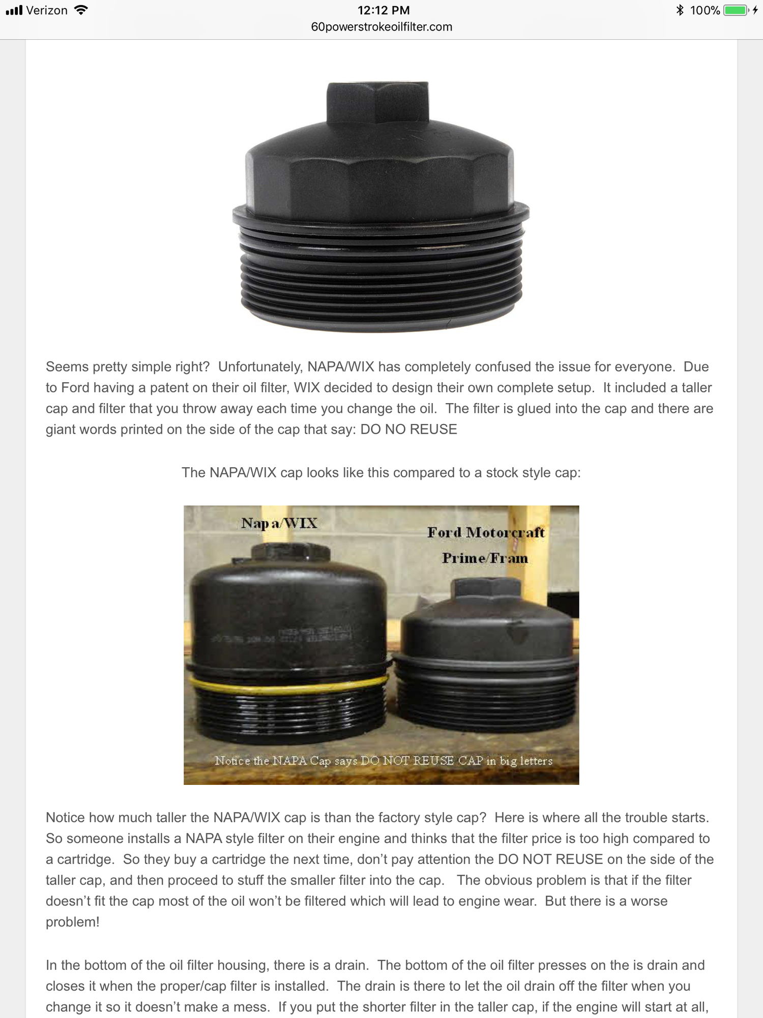

On a side note, nobody would advise running the oil filter you are using.
The noise was going on before the turbo was recon'd. What oil filter are you referring to? I use only a ford OEM filter or are you refering to the coolant filter kit i show on my truck. if it's that it's to filter the coolant of debris. when the oil cooler went a few years ago i put it on to filter out the oil that had gotten into the coolant.

That oil filter cap doesn't look OEM to me, maybe it's the angle of the camera, looks like the taller NAPA or similar cap.

Originally Posted by calvinbabb
....... What oil filter are you referring to? I use only a ford OEM filter .......
Then that’s a real problem because that’s a tall cap used with aftermarket filters and putting a Motorcraft or Racor filter with that cap won’t be filtering correctly.
Nope, got the filter from ford and new cap each time.
