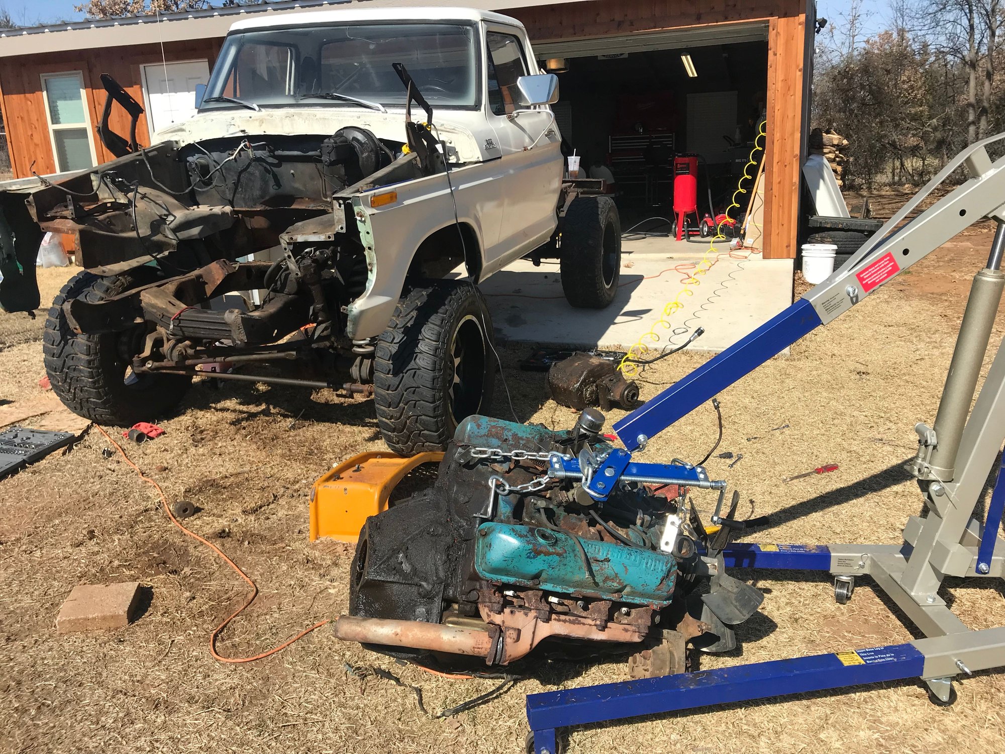

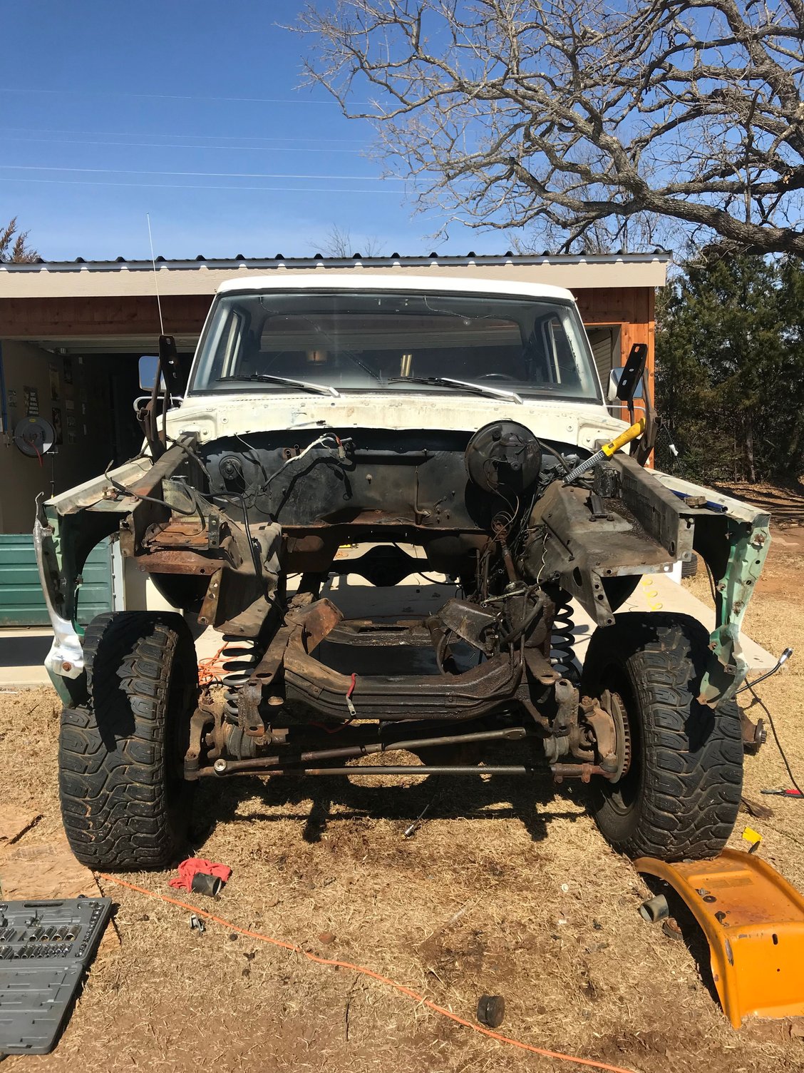

i’m doing a frame off restomod. The VIN on the title indicates it’s a 1979 F150 FWD with a 351. However, it has a ‘77 or earlier grill and round headlights. During the tear down, I noticed that the front clip and bed (short box) were originally green, while the cab was a dark blue color. Once I got the cab off, the VIN stamped on the frame indicates it’s a ‘76 F100 4WD, which indicates the motor should be a 360.

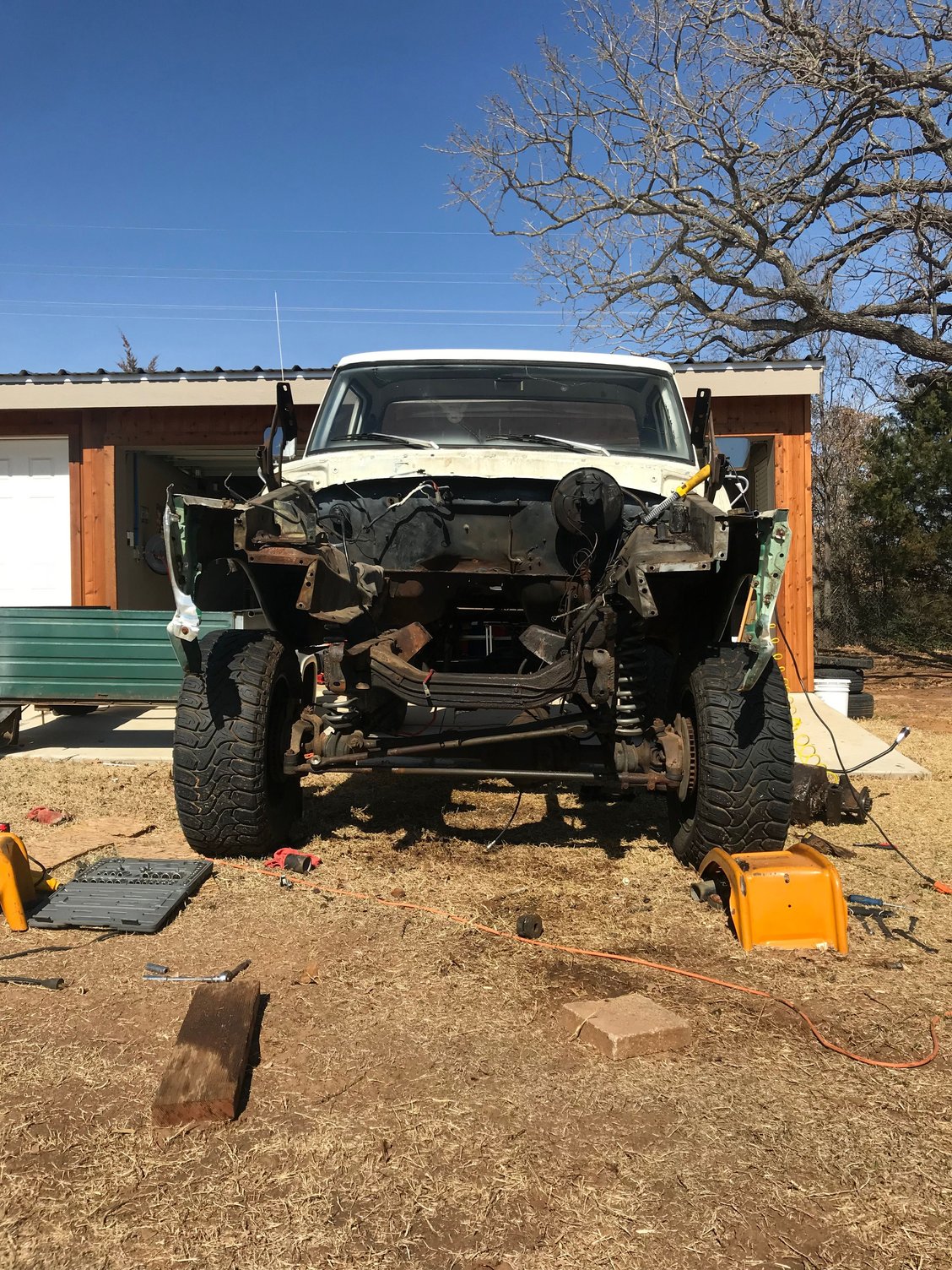

So where does this leave me? Can I reasonably restore this on the frame I have? I have since taken off the cab so tomorrow I can post pics of the frame and motor, hoping someone tell me if this is a 360 or 351C.

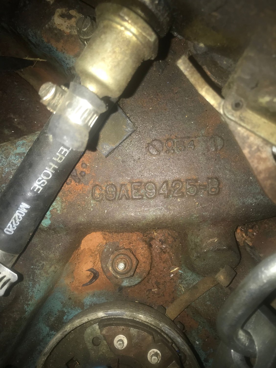

Got a better pic of the engine from the front? From that angle, it does look like an FE, but it could be 352, 360, 390, etc...

I agree it looks to be a FE family motor, but to verify, there are numbers on the block to help narrow it down some.

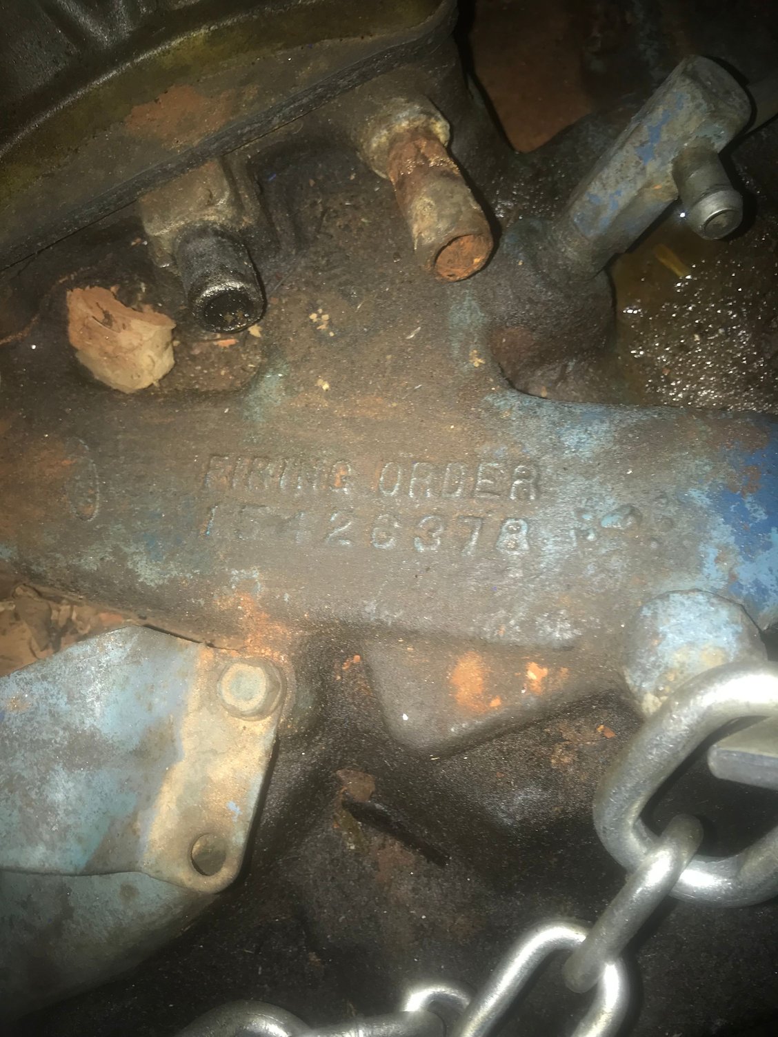

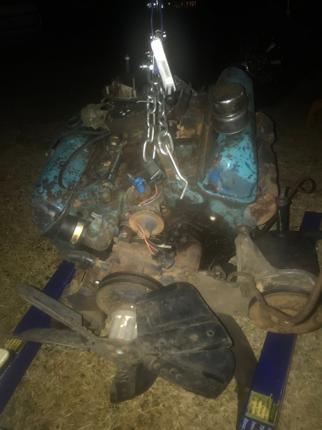

Here’s the best pics of the motor I can take at night

That is definitely a FE. As for which one, I'm not the greatest with casting numbers, but the intake has a 69 Casting being C9AE from a car. The 360 and 390 share the same block, but different stroke. So hard to tell exactly which one w/o measuring stroke or getting the numbers off the crank.

You have to measure the stroke to see which engine you have.

So, based on this thread Ford V8 Engine Identification - FORDification.com, it looks like a 360 (or 390), since I have a 5 bolt pattern on the valve covers. I'll be rebuilding the engine, so it'll be interesting to see what I have there.

As a note, all FE's share the same valve cover bolt pattern. the only way to truly know which you have, is by measuring stroke and bore.

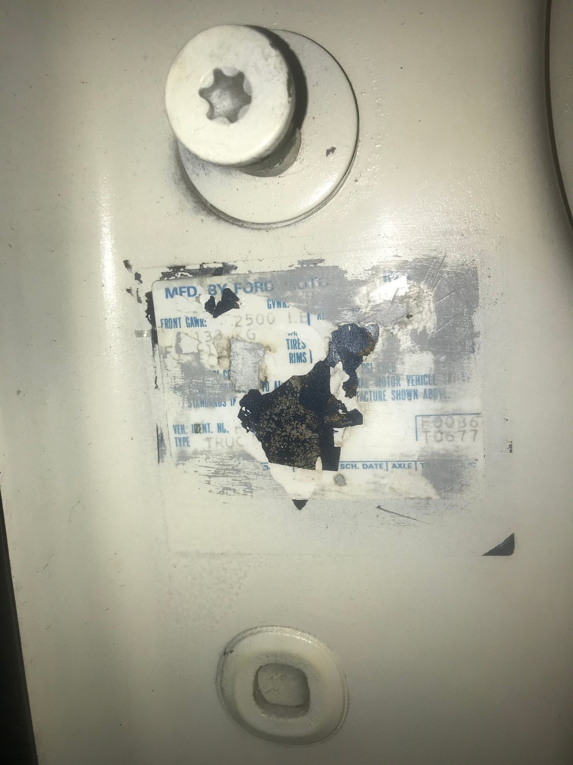

Here is what’s left of the warranty sticker. Now I’m beginning to wonder if it was intentionally defaced

There is a possibility your truck had a lien on the title and was never paid off. Somehow a 1979 title was acquired and the door vin was destroyed, and the 1979 title used to sell the truck.
My guess is that is what happened, or the truck is stolen and the 1979 title was used in the same way described above. Everything points to that truck being a 1976, except the title.
What vin number in inside the windshield on the dash?
