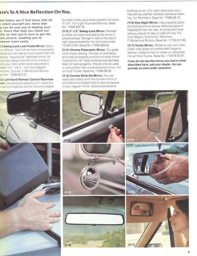

Here is data listing the mirror options in 79.

It looks to me that 79time's data listing image, the upper left mirror is what you have,
and that comparing your mirror to that one in the data listing, your's is mounted too low causing the lower hanger to be in the dent
in the data listing image, you can see the side trim forces the mirror to be mounted higher

Looks like a case of "re- engineering". The pic in the upper left in the listing shows the arm at an upward angle from the door. Pic in post #1 ,the arm is straight out from the door, moving the lower mounting bracket down into the channel.

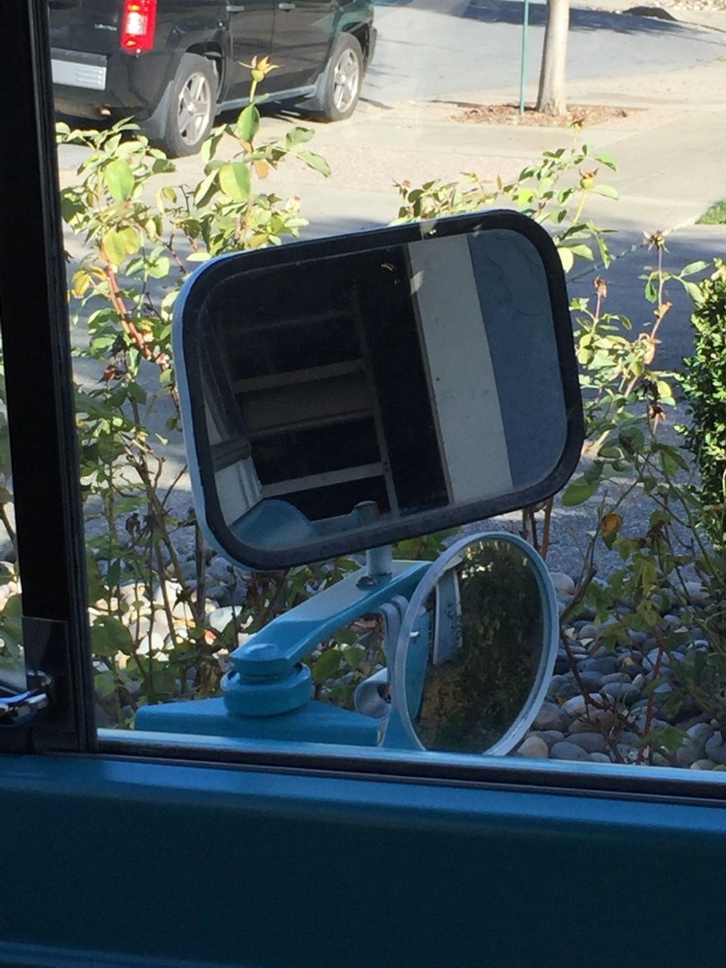

Yes, those are the Delbar brand of mirrors, and yes the customs did not automatically come with trim. The picture shows how mine are mounted too.
Although, it looks to me like the installer of yours went to the extra effort to spread the hoop so they could be mounted higher up on the door and the lower mount would still fit into the dent. Nice.
Also used the same model in black, but painted Peacock Blue and Wimbledon White to match the paint on the Bronco.

Interesting. Is that a Ford brochure, or something else?
Notice that the Swing-Lock mirrors in the upper left are in fact the same Delbar style as ours. Same mounting feet and arm shape that put the upper bar at an angle, instead of being level like the factory Ford mirrors were.
The actual Ford type-9 Swing-Lock mirrors have different mounting feet and are obviously shaped for the trucks. With the Delbars right out of the box you have to tweak the arms for a better fit. And even more if you have the trim and can't mount the lower foot inside the dent like in the brochure's pic.
Interesting.
