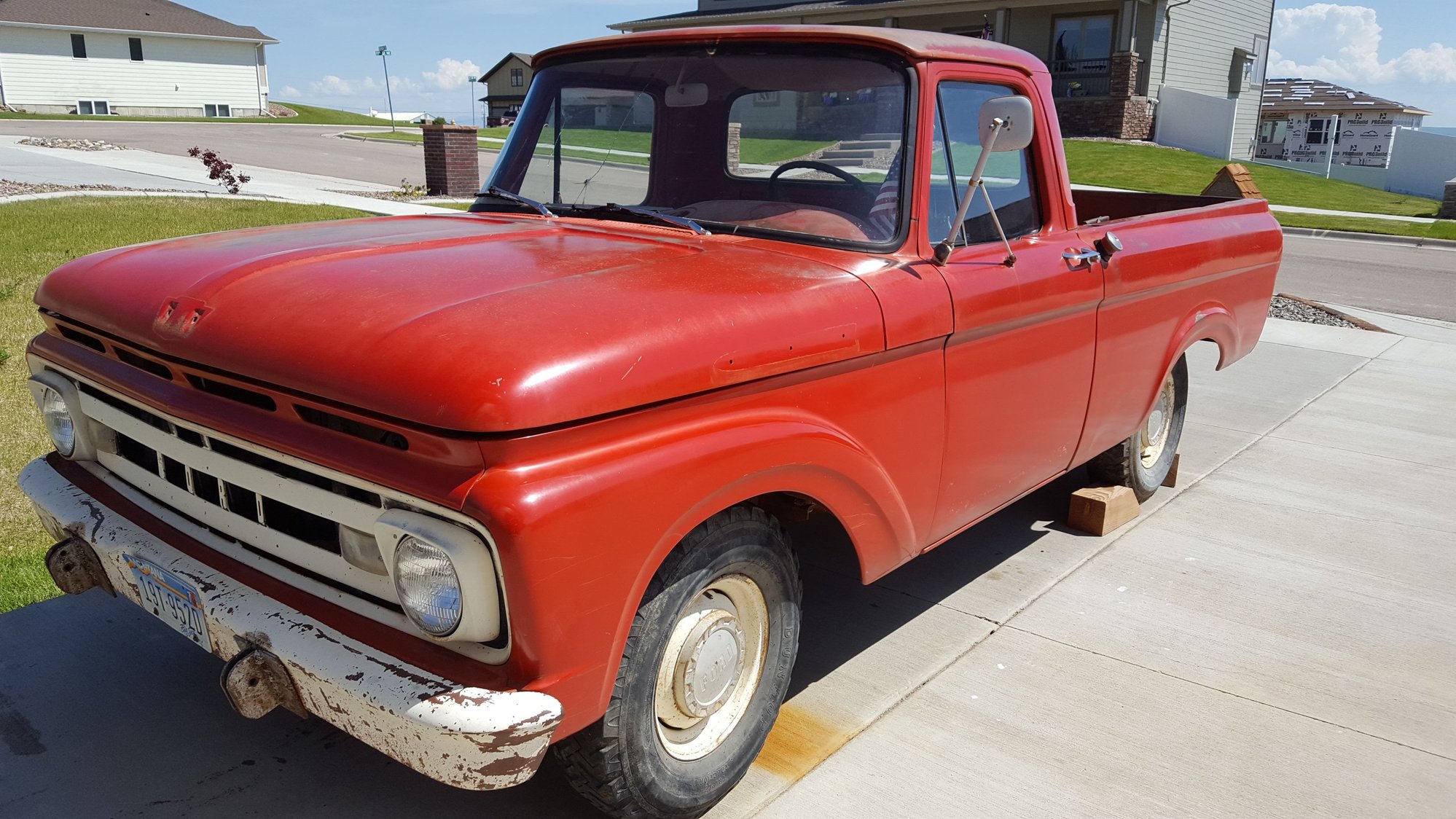

Hello all. My boy and I are getting ready to install a new clutch/pressure plate in his 61, 223 4 speed.
We do not have a manual (yet) and can't find the torque specs online. Does anyone have the pressure plate and flywheel specs? Thanks,
