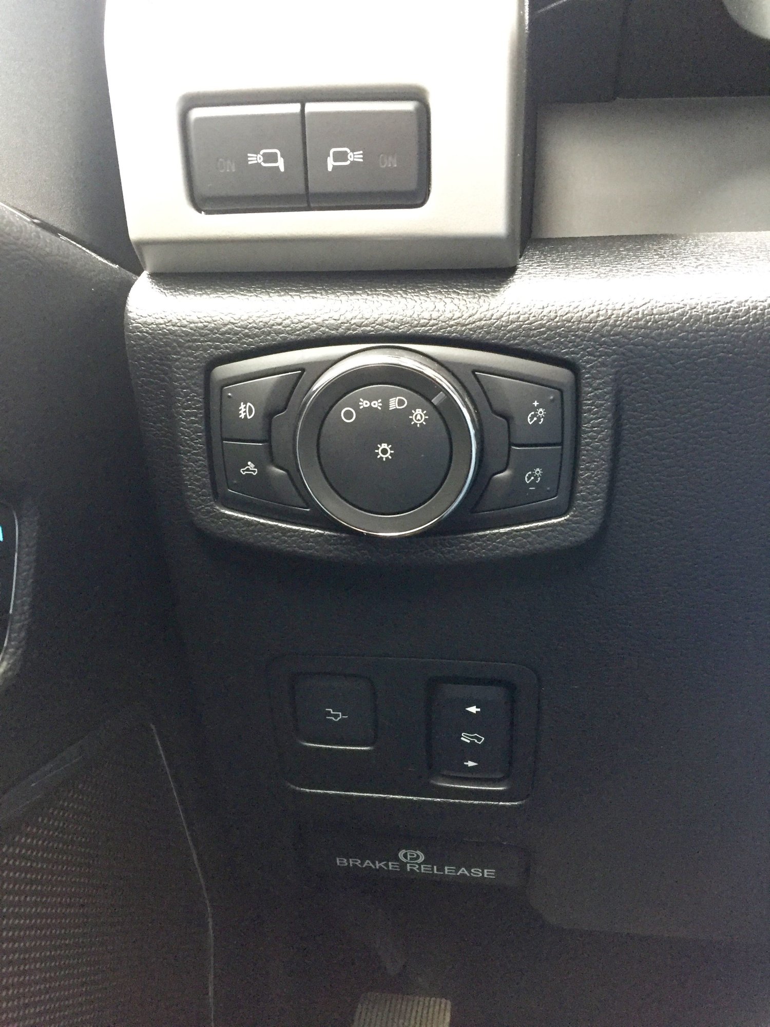

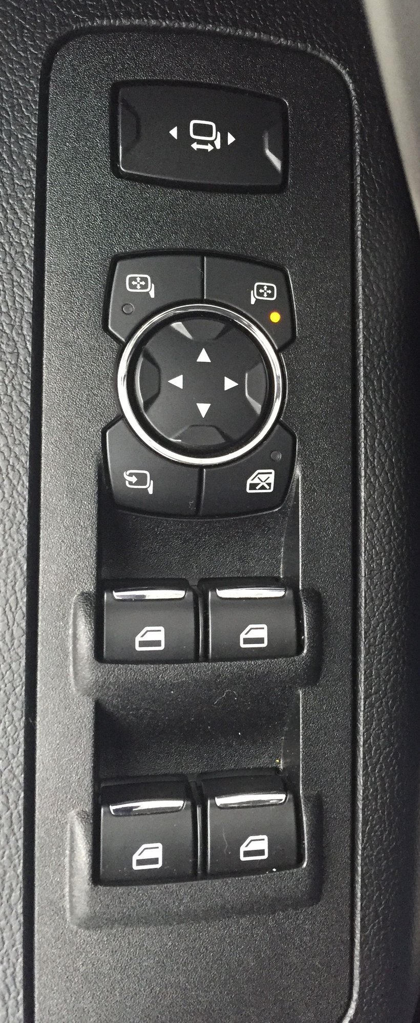

I had one of my power telescope / fold mirrors fail on my 2017 dually. It did have the blind spot warning light in the mirror, but no 360 camera...the dealer replaced under warranty but told me the cost of the mirror was over $1000.
If you did the mod, you'd also need a new power window bezel which has the buttons for the power telescope and power fold. Also, no truck was ever equipped with power telescope / fold mirrors without having the side mirror spot lamps. This would also require a new trim piece around your left-most HVAC vent. This is assuming you have all the harnesses in place to support these features as well. Anything is possible, but sometimes it takes more money than we'd like to spend. Here's the added switch gear you'd need:
