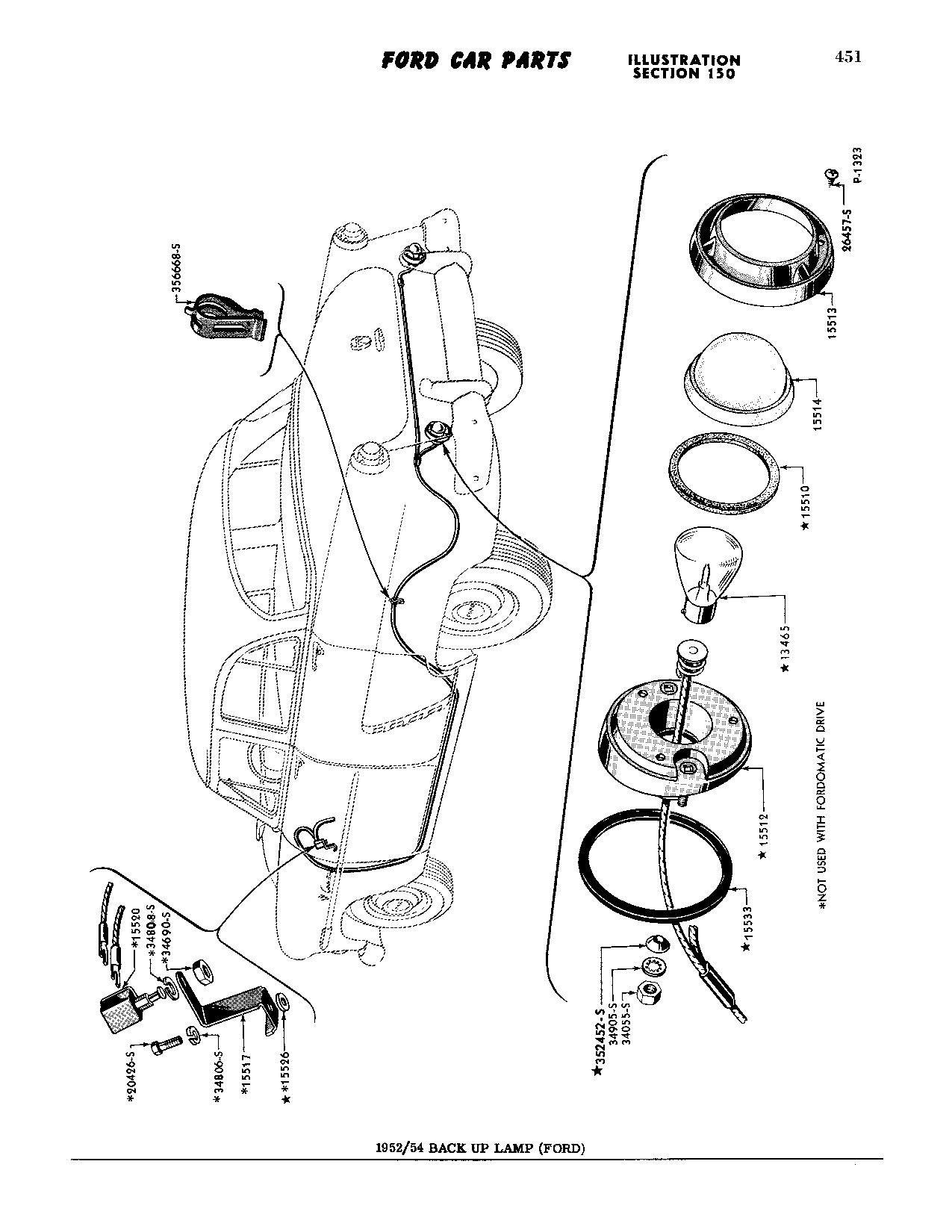

Originally Posted by zolav8
I'm rewiring the '54 Panel and thinking of hooking up a backup light. I have a standard three on the tree.
Is there a way to automatically operate the backup light with the shift lever in reverse?
Yes, if you use the parts from a car (see pic at lower right), because backup lamps weren't available for trucks until 1967.
Wow, Bill, thanks!
You have great knowledge on even the smallest details.
Just noticed your location. I doubt you'll find these parts in Buda or Pest.
But you might find them on ebay...let me know if you do...before you buy, because I'll need to verify what they're from.
