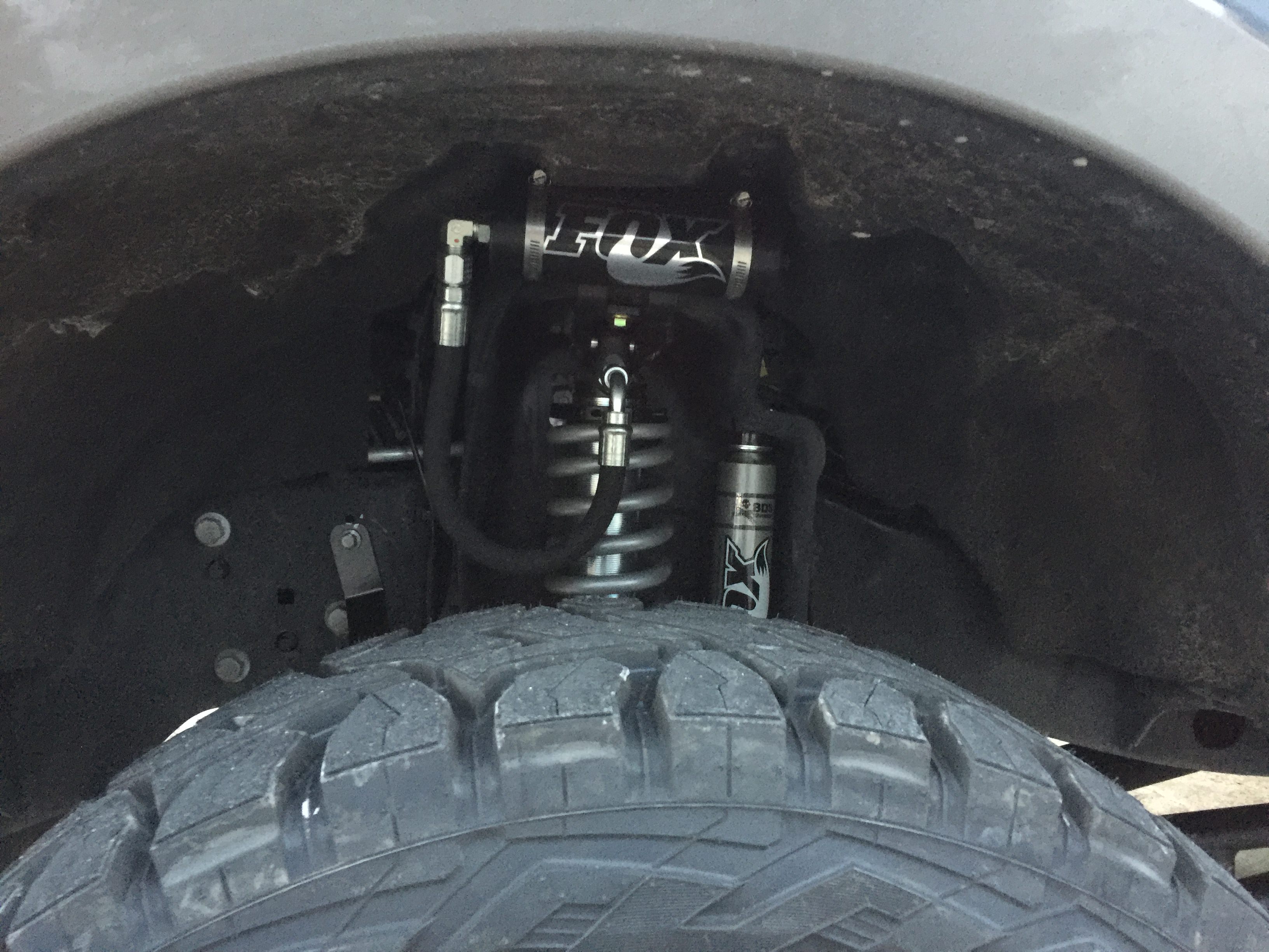

Originally Posted by Gary E
do the bds fox shocks have a BDS sticker on it? I want just the standard fox sticker.
They have a large Fox logo with a small BDS wrap above it.
See pic below.
Attachment 286233

You are literally the only person I have heard make such a claim. Please elaborate on what exactly about them you dislike and in your opinion, what is better!? I have to whole heartedly disagree with you and I have run factory Fox, Icon, and King in the past, this system is the best riding I've ever owned.
