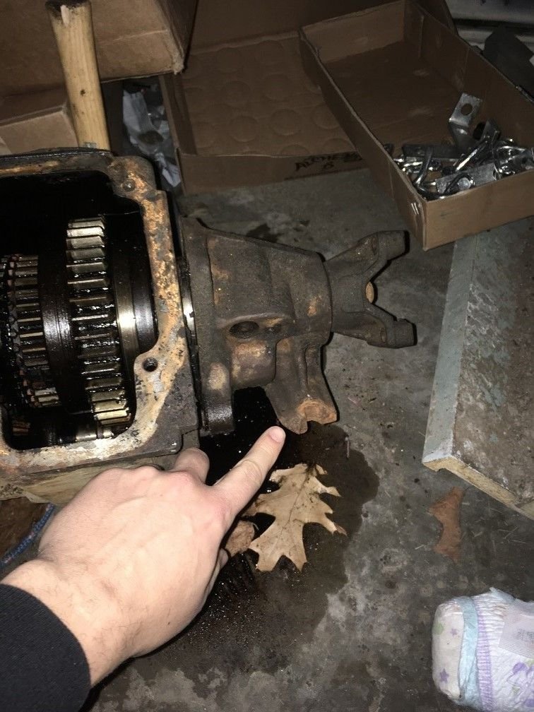

Also... any idea what this piece is called and where I can find a new one? It's the housing of the rear (output?) shaft that sits on the crossmember and connects the driveshaft.

I did a swap to a 5 speed and had several bookmarks to transmission parts.
Is this what you're looking for?
https://www.allstategear.com/T18-T19...g-p/t18-7g.htm
If your T18 was like mine you may want to get the grease off and double check the number of bolts.
I don't remember mine being difficult to seperate. But the engine was still in the truck. I remember it being heavy.

I took the trany off the bell housing first then the bell housing off the motor.
Mine I am sure mine has been apart before, missing bolts & cross member brackets, but yours should not be hard to come apart.
As for that housing most of the time its called a tail shaft housing. They also come in different sizes & types.

From my Google-wandering, it looks like tail housing or tailshaft housing is what it is. I see a few for 4wd, but I haven't found one that looks like it's a match for my 2wd. I'll try to pull a casting number off it today and see what I can find. Thanks!
