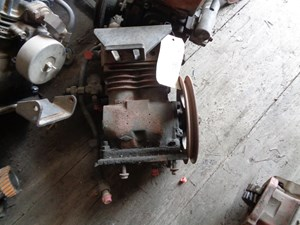

Don't think there is anything "cheap and easy".
In the early days of med duty trucks there were single/twin cylinder compressors that were V belt driven to supply air for brakes.
Typically not very small. About the size of your std home compressor pump.
