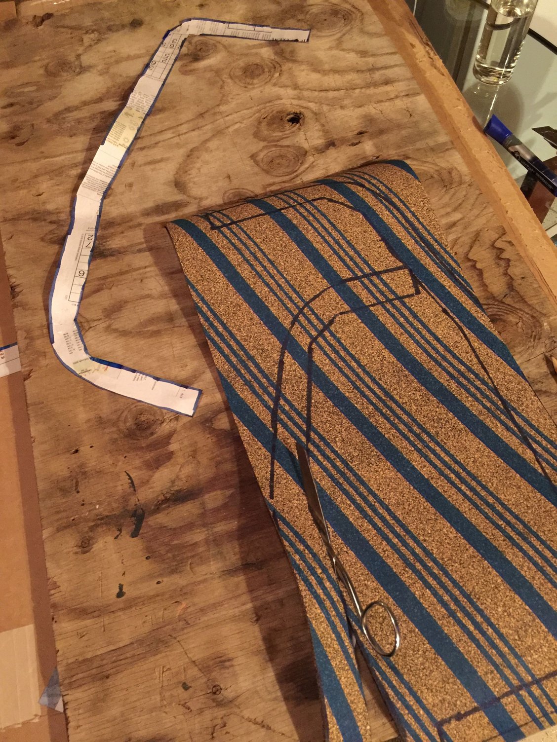

Trans access hatch gasket
I know this can be bought from Macs but I have some cork kicking around and decided to make my own. Used some news paper and tape to make a pattern and then transferred it to the cork with a felt marker that I ran carefully over the edge of the pattern to leave a good sharp edge to cut along.
I will use a contact cement to hold it on the hatch.
