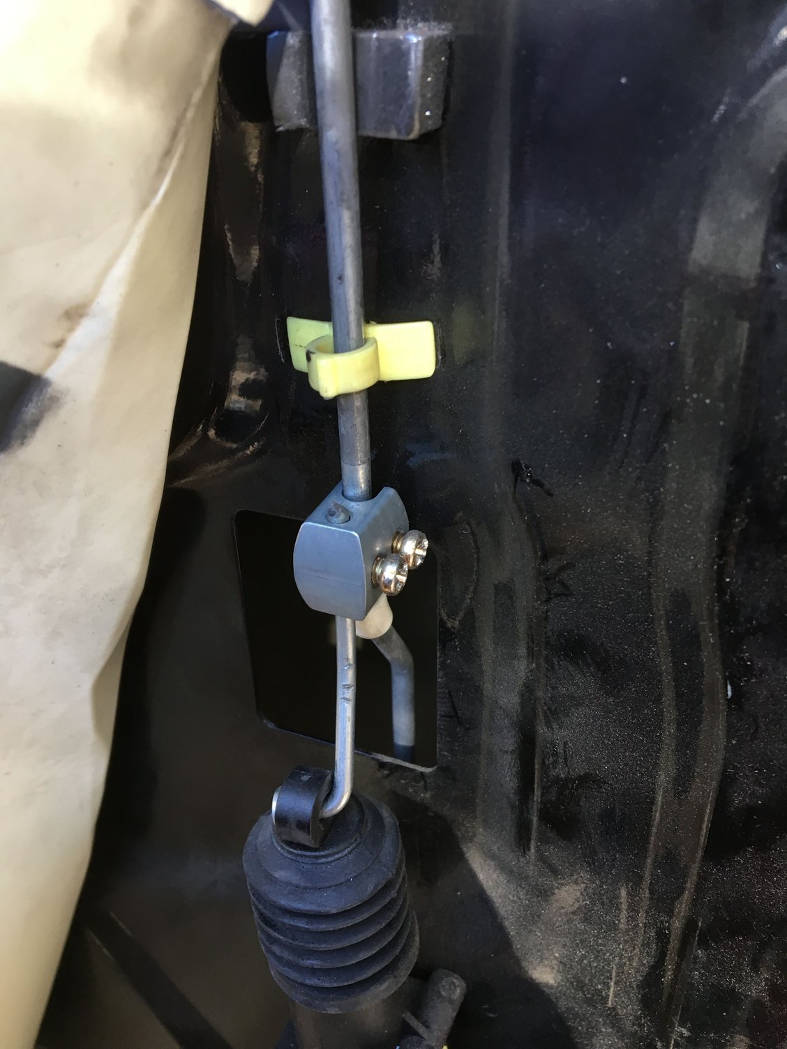

OK, so the rod coming down to the actuator is slipping, The little metal bracket that secures the two rods together loosened up. I realigned the rods and tightened as best I could with the 2 little screws. I don't think it will hold for very long, I'm going to try to use a cable clamp to hold the two rods together better.

This is where it was slipping and wouldn't unlock
Cable clamp and tweaking rods to clearance the inner door
3/16 cable clamp

What the heck is that contraption? Someone installed aftermarket door locks instead of just replacing the OEM unit?

I guess, when ya'll said it might be the actuator, I looked them up. The ones I found look nothing like this. I'm just making due with what is there. Yes, it had me scratching my head for a minute. That's when I took a closer look to see what was wrong. It works, just don't look under the panel.
