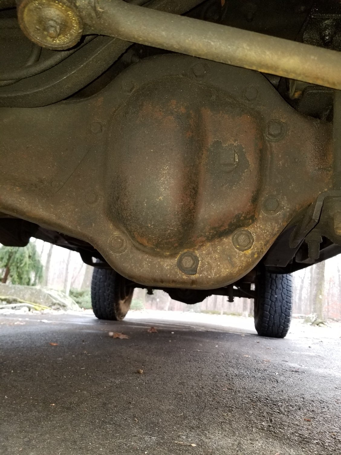

My '85 IDi is a Dana 44 (I guess it's technically a "Dana 44 HD"). I thought all the '83-'86 F250s were either 44 or 50 TTBs.
So does your truck have an actual diff cover in the front? Is it a solid axle and not a TTB? If so, it's definitely not stock, and a nice bonus.
My dad custom ordered the truck new in 86 and i dont know if he had it built as it is or replaced the front axle. I'l have to dig through the files and see if I have a build sheet.
See pic.
That's either a Dana 44HD or a Dana 50. In either case it's a Twin Traction Beam (Dana 60 was only a solid axle).
Yes, there are 8 lug Dana 44s. All F-250 4WDs before '80 had them (solid axles) and from '80 to '96/'97 they had either Dana 44HD or Dana 50 TTB.
To tell the difference between the Dana 44HD and Dana 50 look at the hub. If the locking hub body is almost as big as the hole through the center of the wheel it's a Dana 50. If the hub is about 1/2" smaller in diameter it's a Dana 44HD.
