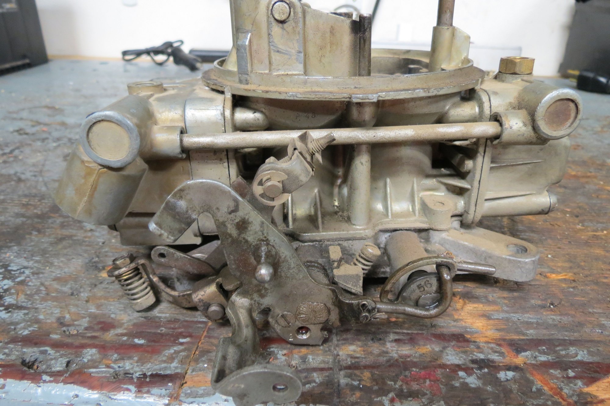

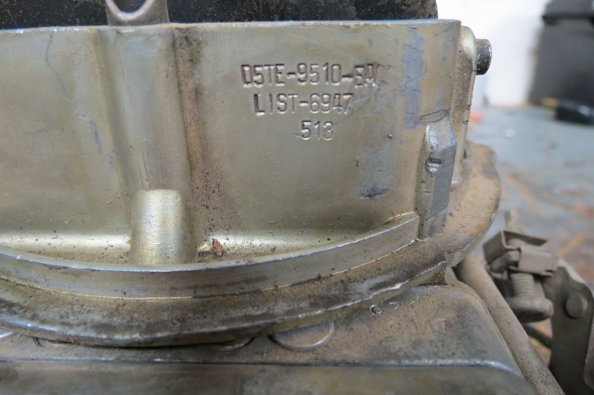

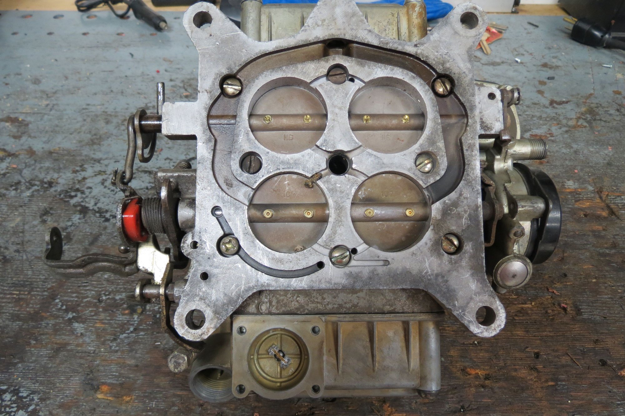

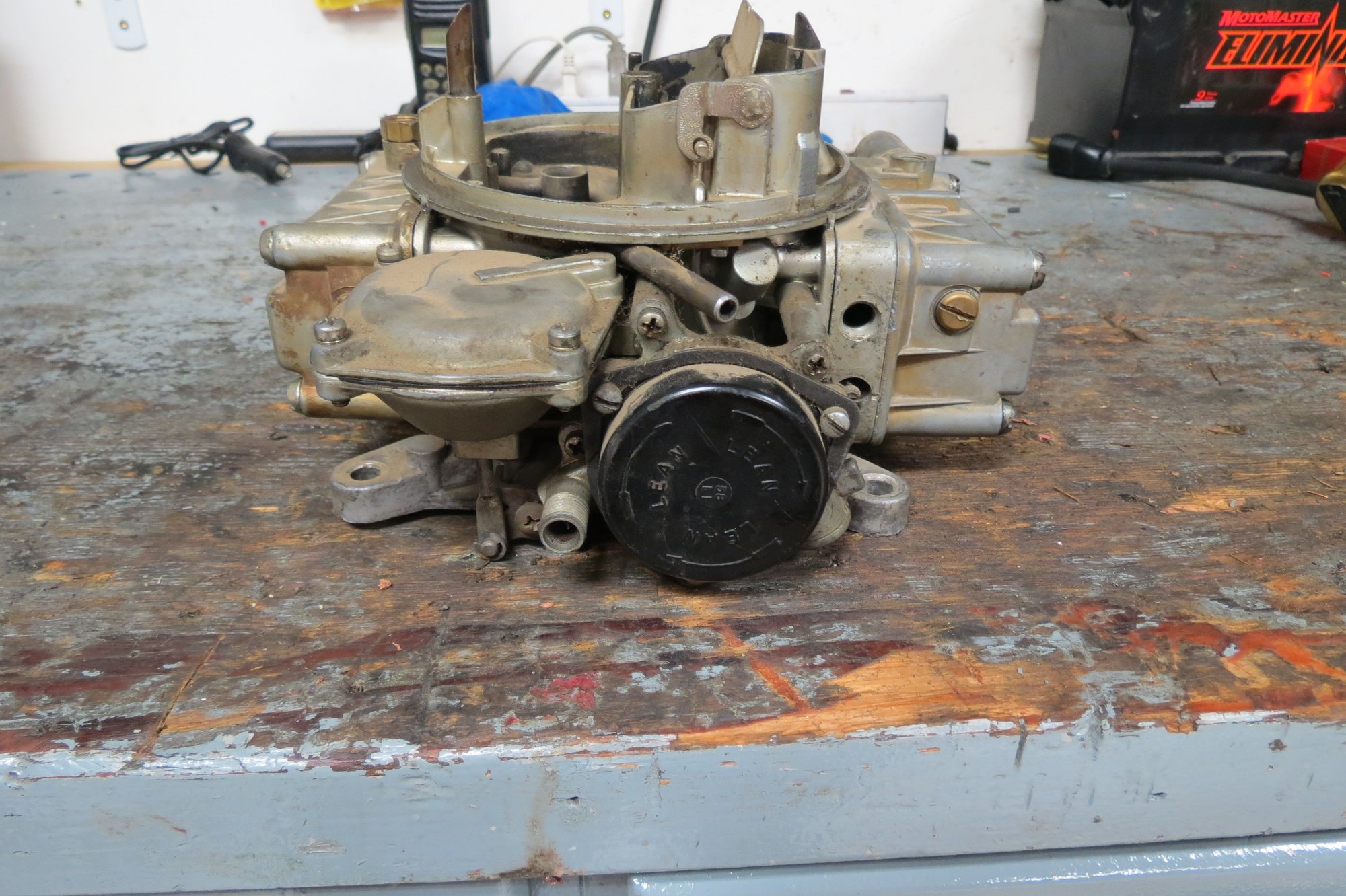

You're in luck I have a Holley 6947 collecting dust Casting number D5TE-9510-EA
Carb is 95% complete. Missing primary jets, Accel pump housing, and primary fuel needle and seat. Throttle shafts are tight free and smooth, every thing operates as it should. IIRC the carb has low miles (less than 40K) and was pulled off in 77 or 78 and had been rebuilt once before being swapped out. Shoot me a PM if you're interested.
See below pics.
