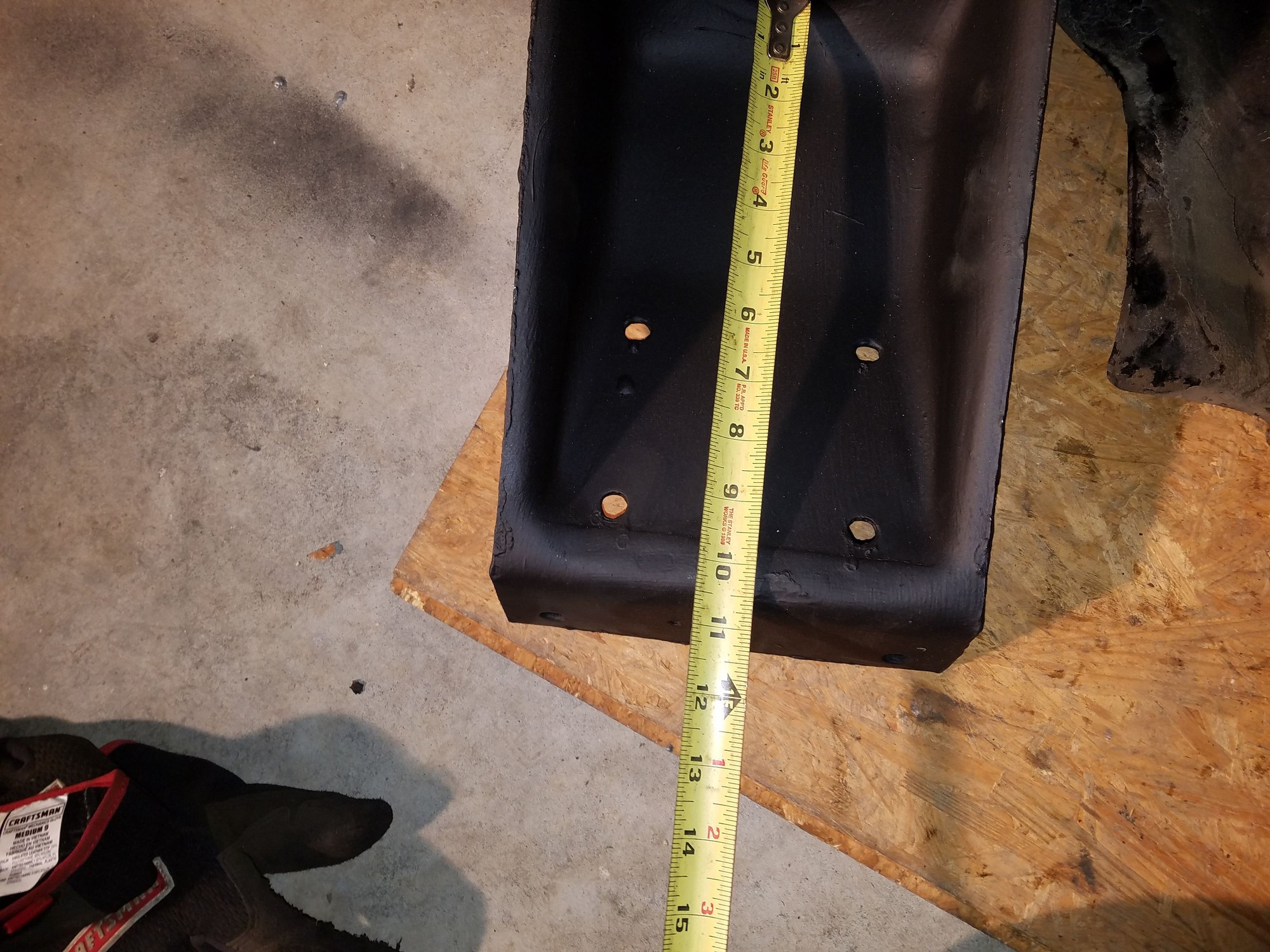

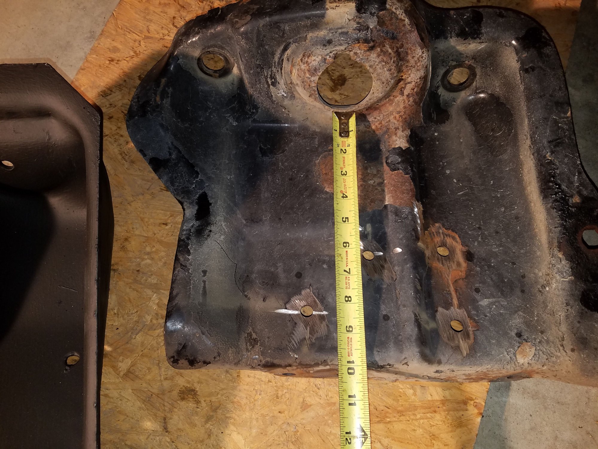

Originally Posted by LittleBlue79
You got 4" lift coils from JBG and only got 2" lift?
I got 2" lift coils from JBG and got 0" lift.
I'm noticing a trend.
Interesting, I'm wondering if I should call and ask them whats going on then.
Old Jan 11, 2018 | 05:09 PM
PRIMERED79 SHORT BED's Avatar
Joined: Jan 2012
Posts: 1,106
Likes: 25
I will try to throw a tape measure at those buckets after work today.
Ok tossed it at it and it came back and hit me in the chin. lol
1979 Bronco XLT all stock, 351M auto. Buckets measured from the bottom of the bucket itself, then going straight up the frame and inline with the top of the bucket, not following the angled angle of the bucket, they are 12" tall.
1976 F100 2wd 9" tall.
Hmmm.
So even yours differ from mine then.
If I remember right the guy I bought the axle from said it came out of a 78 bronco.
Here are some pictures of mine and I'll throw one in of the ttb bucket.
