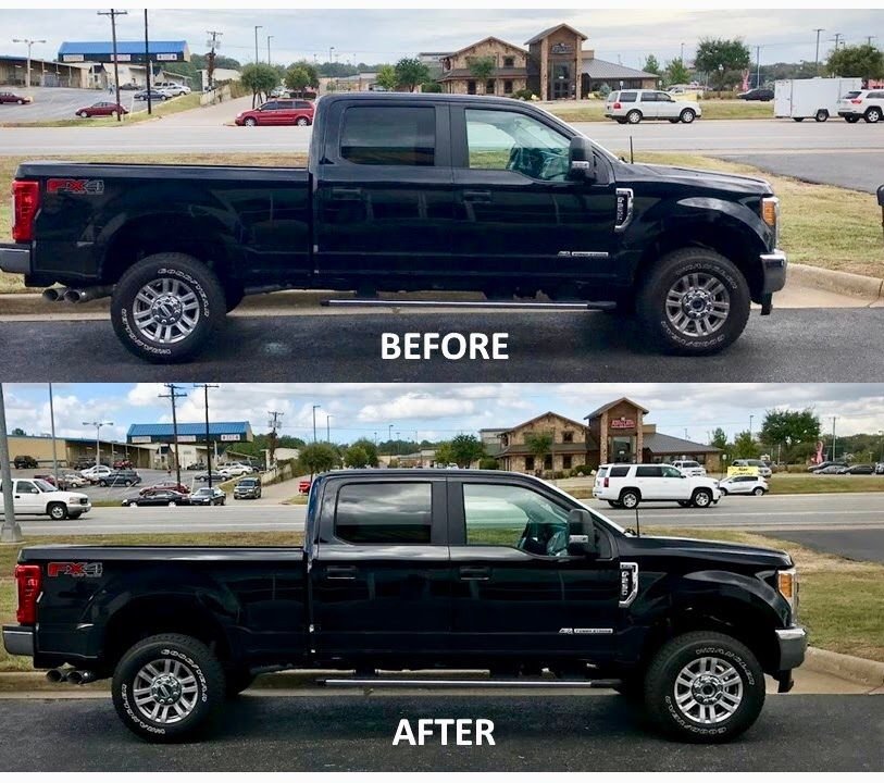

2.5” ReadyLift
I wouldn’t go for the cheapest kit out there. There are kits under $100 all over the web. Anything over 2” needs the track-bar relocation bracket. I’m 100% happy with it. Ride height is not too high for family either.

From: DFW

[QUOTE=CBEllis;17707868] CBEllis, looks nice! Do you know what amount of rake in inches you had stock before the level install??
