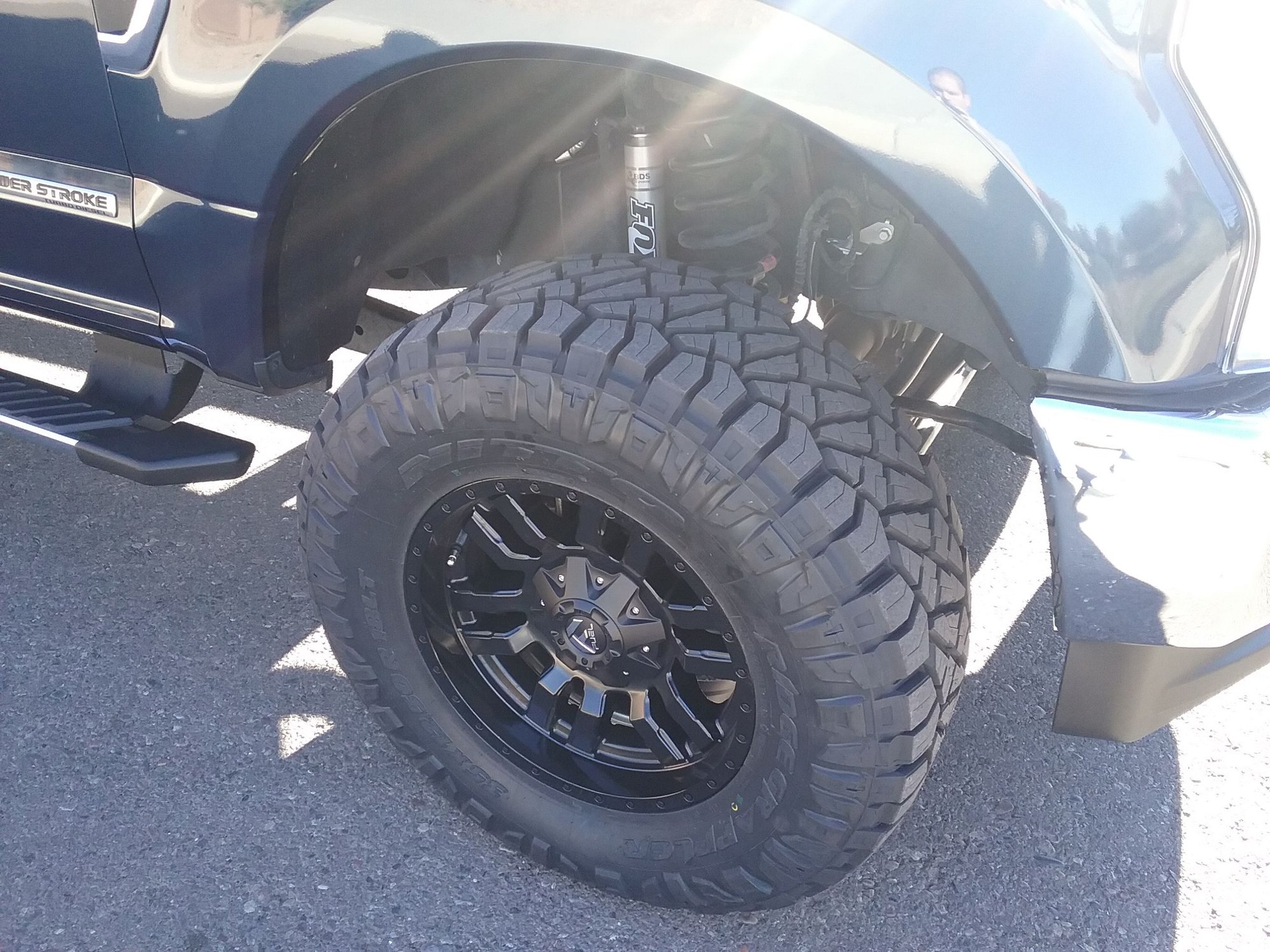

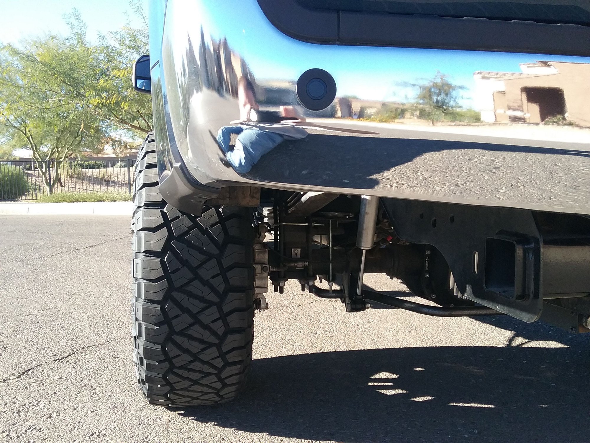

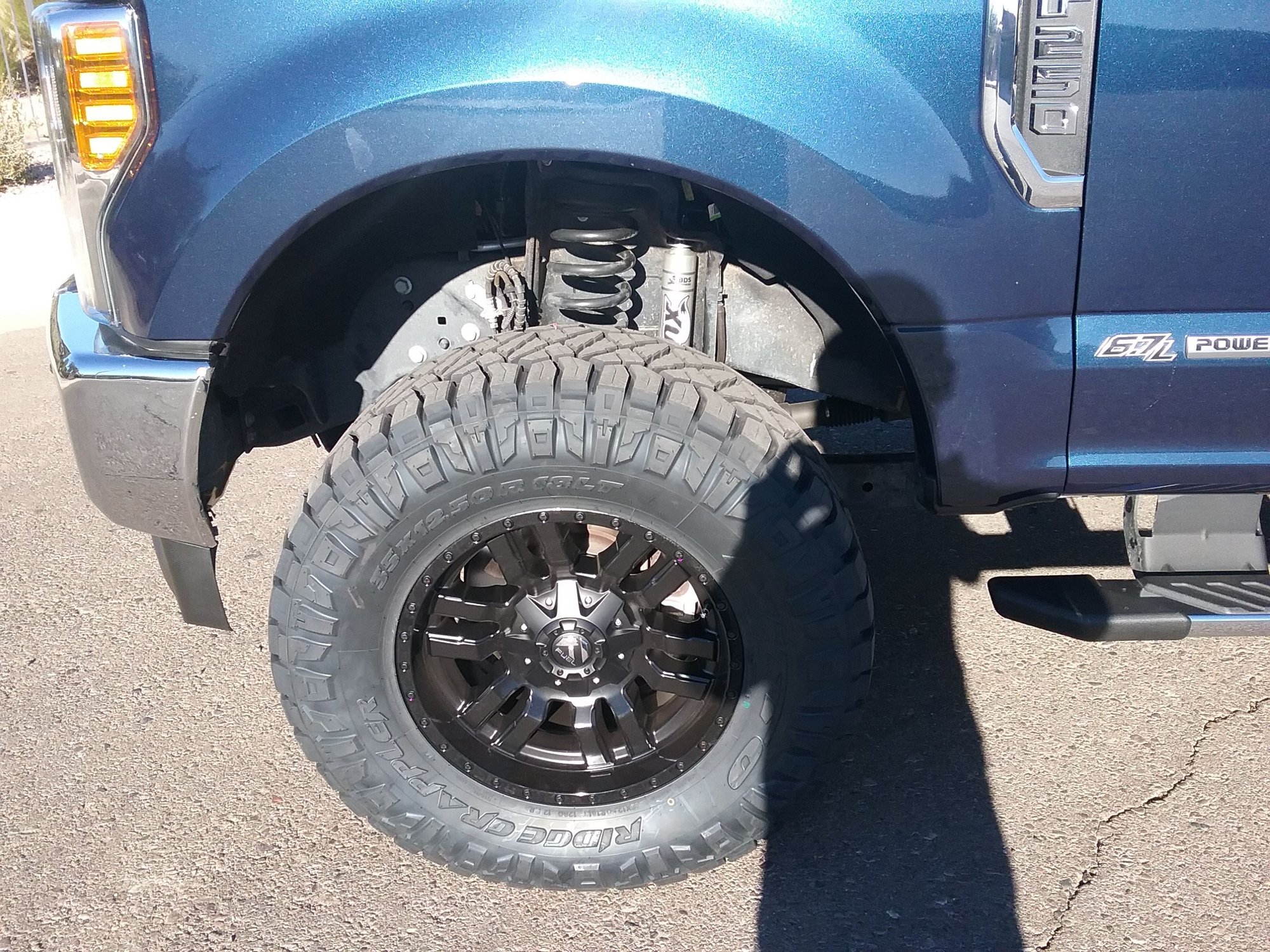

2" BDS level (no rubbing)
35x12.5 Nitto Ridge Grappler (70lbs, Load Rating F)
18x9 Fuel Sledge D596 Wheels (40lbs, -12 offset, 4.5 backspace, 3700lb load rating)
6.7L with 4.10 gears installed.
These tires are no louder than the Goodyears (same as yours) that came with the truck. In regards to MPG I don't pay any attention, but my mileage probably took a 2 mpg hit. But I also have a heavy foot, especially after I had the gears done.
My truck is also set up for towing so I wanted both wheels and tires to have a high load rating. I'll sacrifice weight over getting a weaker wheel or tire.
