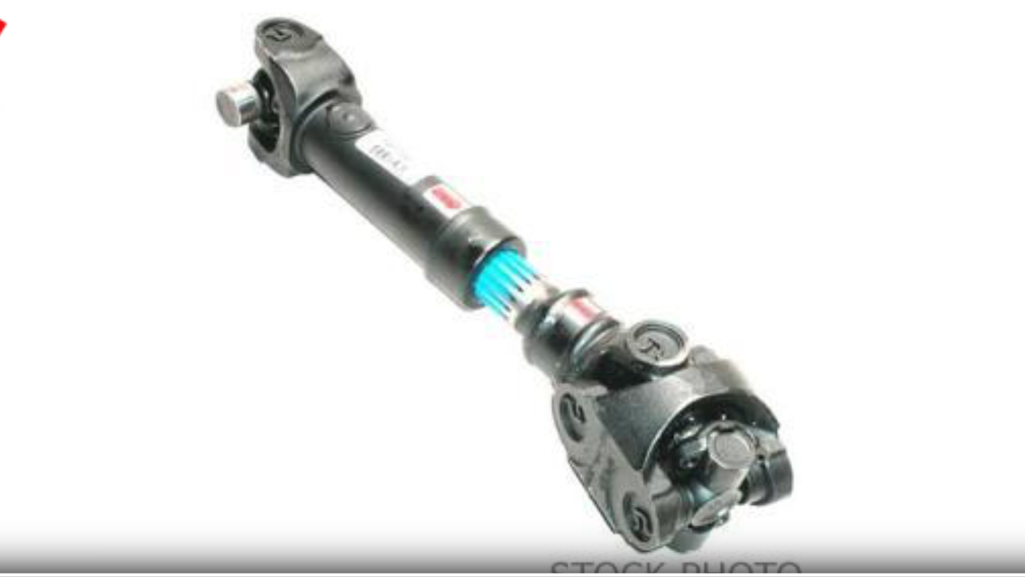

Hey guys. I just joined FTE. I'm about to start a sas on my 97 f250hd 7.3. I managed to find a d60 out of a 97 f350 dually complete with the springs, trackbar/bracket, sway bar, all steering components including the pitman arm and the front driveshaft. I have already confirmed my 250 hubs and bearings will fit right up to the d60 (thanks to fte and the local auto parts store) my only question is will the 350 driveshaft fit my 250 transfer case? I didn't think about that when I picked up everything else. I can't find a part number for the yoke on the transfer case on either truck. I did crawl under and measure with a tape measure and it looks like my yoke is the same size as the new driveshaft but I've seen posts saying I need the yoke from the 350. I would have pulled the driveshaft out but it's been in the single digits and windy. Is it possible the f250hd has the larger yoke that the 350 uses? I want to make sure I have EVERYTHING to complete the job before I start since I will be using a friends shop and can't take any chances of not completing the job within a weekend.

Street beast, start a thread on your truck. The 97 f350 has a 4407 transfer case. 96 and 97 has the 4407. If your front shaft has a single u ujiont at the case then you would want to change to a double carden(cv) to avoid vibrations at higher speeds. If this is the way you want to go then you can change the centering yoke on the f350 shaft to one from say a 95. Then get a yoke from a 95 f350(same case as yours now) for the cv setup

I have the complete driveshaft including the cardanic joint from the doner f350 already. I looked up the u joints for the doner truck and my truck. The doner takes 3 of the same demension u joints. It says mine takes offset u joints with different size caps but from what I can measure with a tape measure mine aren't offset or have different sized caps. I know it's the original driveshaft and u joints because I bought the truck off my brother who got it new. So no issues finding out any history on the truck. It's a balmy 20* and no wind so I'll pull my driveshaft out tonight so I can match everything up. If I have any issues I'll start my own thread. Thanks.

The ujiont are the same for both shafts,f250 and f350 . The yokes are different bolt patterns. Yokes are different and won't be able to unbolt and switch between the two because of different spline.

So if both the 250 and 350 use the same U joint, why will I need to replace my yoke? My yoke should accept the current u joint that's on the cardanic joint and already has the correct spline for my transfer case. Am I missing something? The 350 driveshaft that I have looks like this. If I remember correctly mine is held on with u bolts. Is there a clearance issue with my current yoke and mounting hardware and the cardanic joint?

The 350 yoke has a different bolt pattern , it's all by it's self in that aspect
