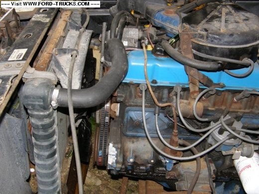

Your truck sounds like what mine started off as.
Ok here is a picture of what mine started off with.
I say started with as the radiator is not right for the year, it is for a later year like 84 or so.
Any way you can see on the far side the radiator/wiper wash tank, it is a 2 part tank. I don't think you can buy them new after market as I could not find any, so good use it will have to be.
As for the radiator you can just make out the over flow nipple just under the cap. A hose would go from that nipple across the top of the radiator to the over flow tank.
I have never seen a radiator with 2 nipples just under the tank.
I have see down lower on the radiator side tank a larger nipple you put the heater hose on. Heater hoes would go from water pump into heater out of heater to that larger nipple on the radiator tank as the return.
If that is how your radiator is and you have a heater return then yes you could cap it.
Also note if you just filled the radiator then started the motor when the stat opens or when you shut it off it could "puke" as trapped air comes out.
When cold open the radiator top off as needed, leave cap off. Start motor and run till up to normal temp. As said it may puke out a little coolant and that is ok as the stat opens & closes a few times. If a lot comes out top it off but if just a little keep an eye on it till the stat opens/close a few times.
When the level stays the same you can top off if you want or just put the cap on and top up the over flow and call it done.
Dave ----

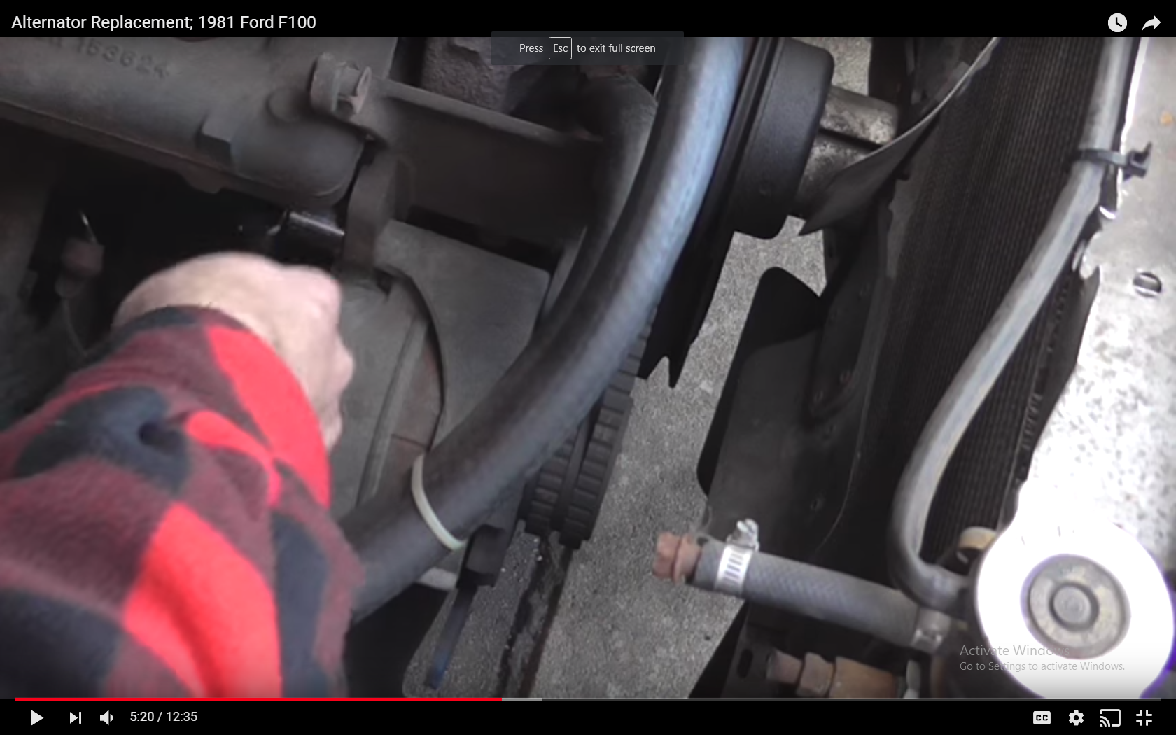

It's spewing from bottom tap in the close up picture with hose attached

What's wrong with that one? The washer fluid reservoir is the coolant overflow tank too, the hose hooks onto the rad. Looks like you need to run that line to the radiator and plug the other. You can see it run across the shroud (https://www.npdlink.com/store/produc...272-60243.html) in that picture.

That lower hose is below the radiator cap. It should be capped, it's for some other application. You need your tank hooked to the top port which is above the radiator cap. When the pressure exceeds the spring in the cap, it will then let the fluid flow.
You can run without a tank, just run a hose off the top port down to the ground so when it pukes fluid it will not get all over the engine compartment and make a mess. If you do not run a tank, you must leave a air space in top of the radiator. If you do not leave enough air space, it will puke out of the hose when the engine gets hot and make a air space by itself. If it does that, then on a really hot day it may puke a little more till it gets enough air space for the coolant to expand.
That is the only reason to run a overflow tank, so you can keep the radiator full at all times. When it gets hot it pushes the spring open in the cap, the fluid goes to the tank. When it cools off it sucks the fluid back out of the tank into the radiator.

Originally Posted by FirstFord1994
It looks like you have a later model replacement radiator. These were consolidated to fit 1985 - 1996 trucks.
The top nipple should have a rubber hose attached to it that connects to the coolant overflow bottle.
The lower nipple was there for vehicles with EFI. A rubber hose attached to it that connects to a metal bar that runs across the top of the radiator and attaches to another rubber hose that connects to the throttle body heater on EFI vehicles.
I you have a carbureted vehicle, cap it off, and put a hose clamp on it!
