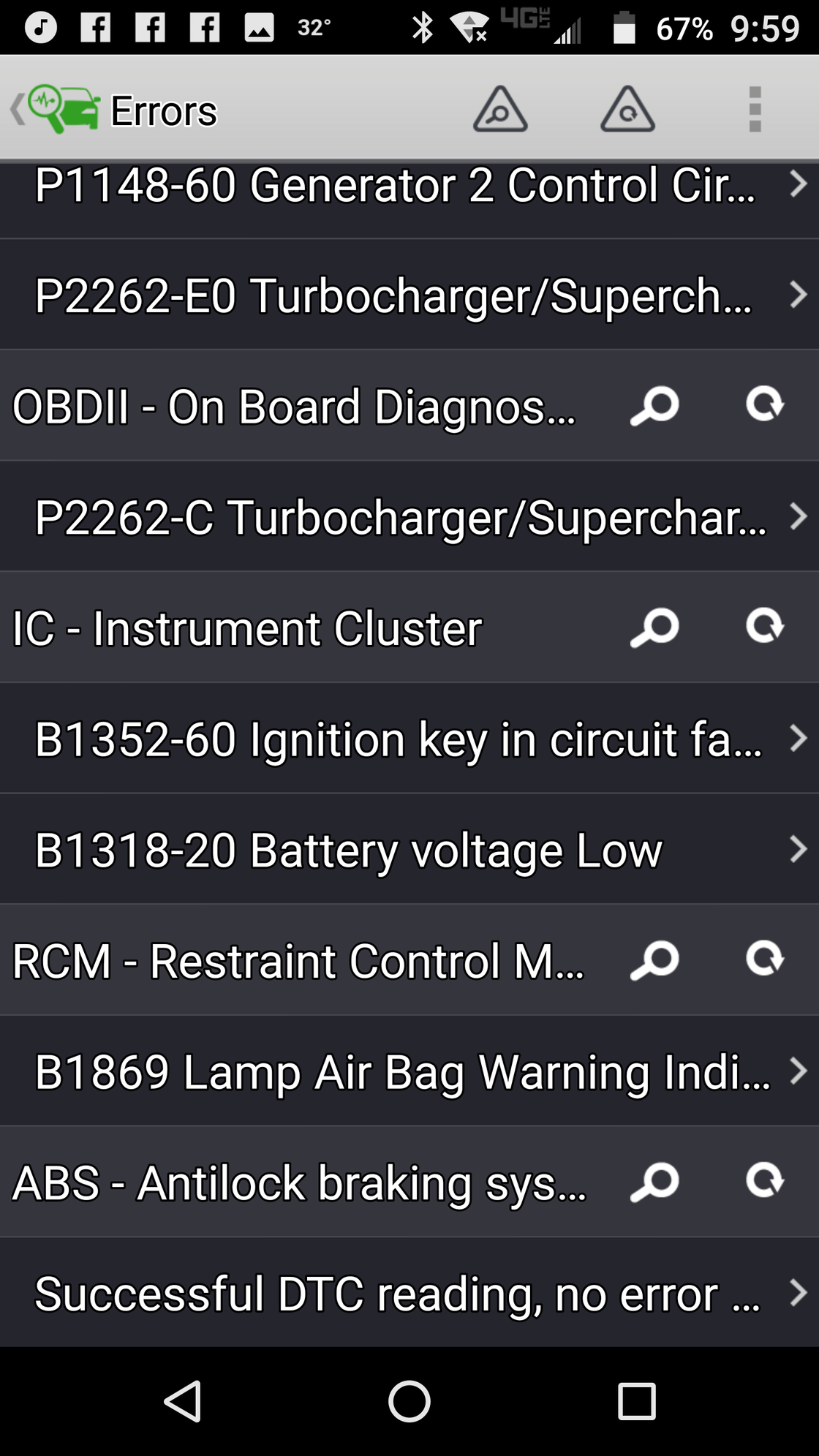

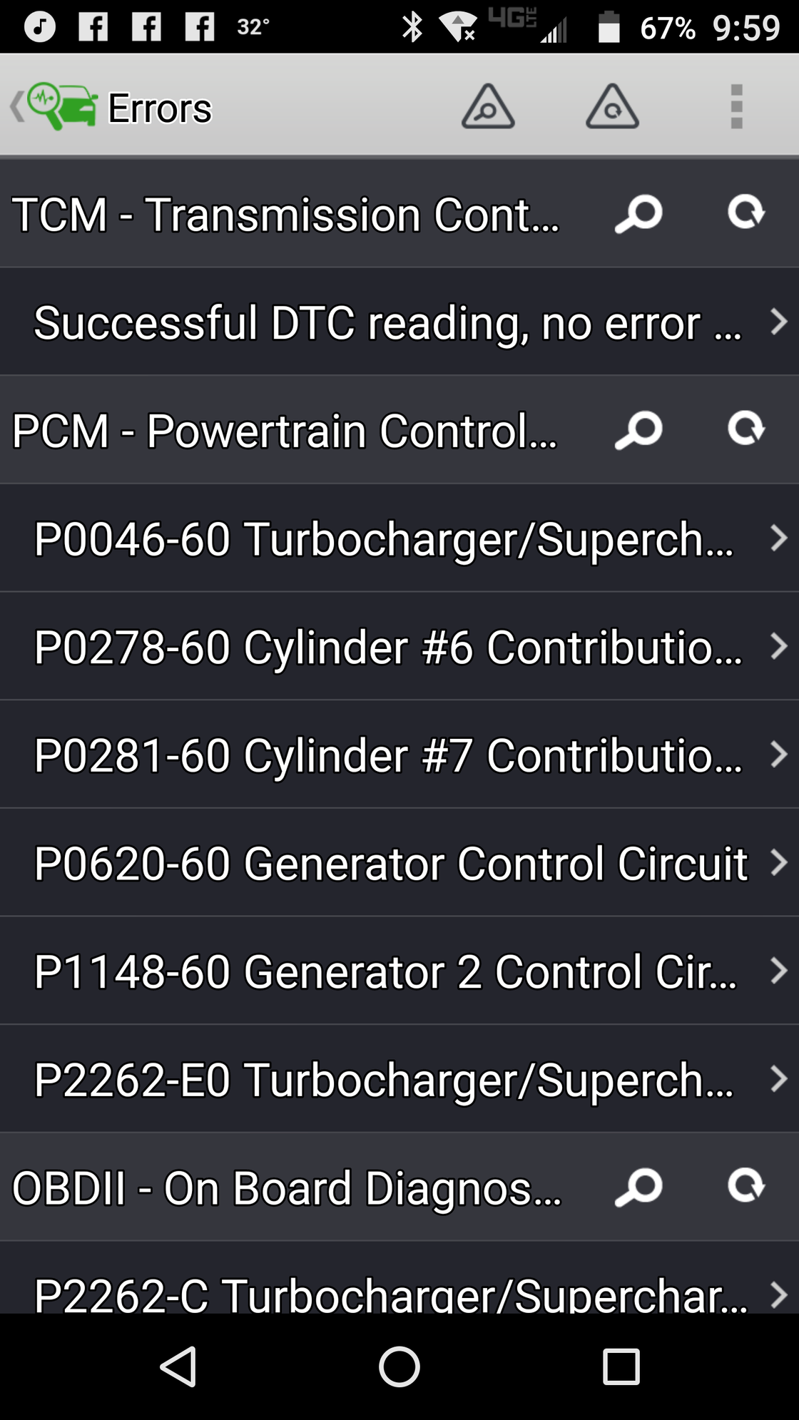

Also, it's been freezing rain here and snow but last night first time ever, I started it up and it was blowing black exhaust, after it warmed up it ran great. As I pulled into my driveway it started knocking and I pulled some codes. The new ones were
P0620, P1148, P0281 . The rest I've been trying to troubleshoot for quite a while.

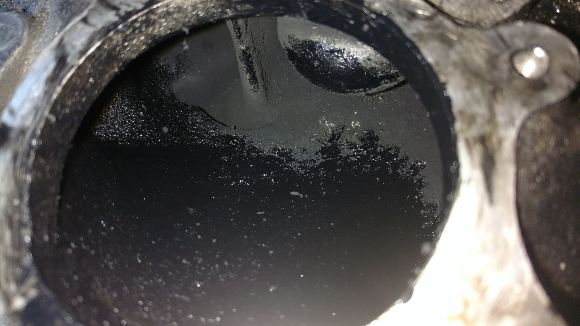

I've cleaned the EGR a couple of times but haven't done the turbo yet. Thank goodness for the late Diesel Ron who made the video on YouTube!
i guess doing that again and tackling the turbo is my next step.
Thanks Last time I cleaned the EGR
Underneath the EGR

Sounds like a bad injector at #7, possibly a cracked or popped tip. If you keep running it overfueled you can damage the piston

Might be making oil, something going on with #7 per that code.
