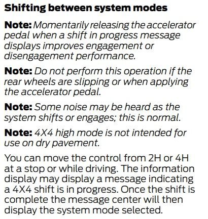

Just a correction, I was confusing transfer cases in my above post. The '11-16 models used a variant of the old NP273 that was made by Magna Powertrain. These used a synchro ring, which is similar to the synchros used in manual transmissions to match gear speeds, to spin up the front driveline. I believe the '17+ models use the same type of setup, but I'm not certain, and info is hard to find at this point.
From your owner's guide:

Yeah,I read that, just never believed it. I remember the ESOF F150's grinding when the vacuum system failed. My previous trucks were XL manuals. So I follow about the same routine with the ESOF on the '17.
