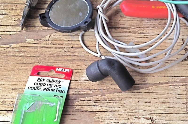

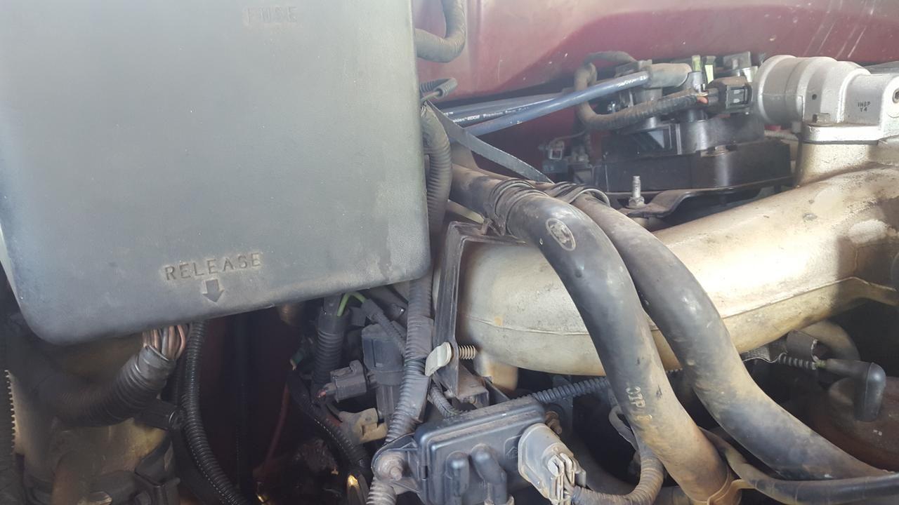

Ok, here's the location of that front elbow... the tip of the pencil...
On mine (1998), it's a hard plastic line with a little rubber boot at the elbow.. the boot is what wears out..
The rear one is harder to find, and impossible to see... You just have to reach waaaaay back there, behind the intake, under the firewall, and just feel around for it. It's very hard to reach, I hope you have long arms. When I finally found this one on mine, I knew right away that I found the problem. It was so bad, almost put my finger right through the elbow part.
Good luck man, I hope it works for you. It's actually a pretty easy fix, and cheap too, but it's just really hard to reach.

I'm not sure about the flying saucer, but you might be right ....
In any case, look close at the second picture, and Zoom in... The tip of the pencil is touching that front rubber elbow...
It's a hard plastic line, with a rubber elbow on the end. The rubber elbow part is small, it would fit in the palm of your hand... The other end of it goes straight up, (but you can't see that end in the pic).
To get at it, you'll probably want to remove the main air intake hose where it connects to the front of the manifold... and maybe unplug a couple other wires and hoses too... it's hard to get a grip on it unless you get some stuff out of the way...
The back one is much harder to reach, and damn near impossible to see, but it's back there, I promise... maybe you could stick your phone back there and snap a few pics, it might help.. That back one is a real p.i.t.a. to reach!

PS Tyrone, that little rubber elbow was available "off the shelf" at my local O'Reilly's Auto Parts..
I just brought the old one in, and matched it up.
