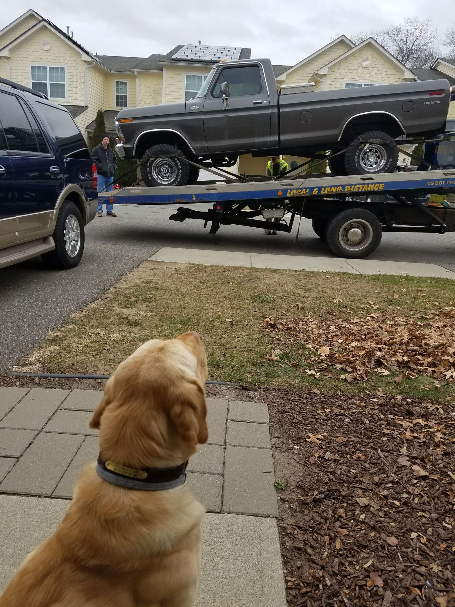

Yesterday while driving to work, I heard a terrible grinding noise in my front axle. I parked it immediately and got out to do some investigating. The driver side hub was cool to the tough. The passenger side was pretty hot. I stepped back and saw the wheel was leaning in quite a bit (positive camber). I didn't want to cause more damage than necessary so I got it towed home. I replaced the bearing four years ago and I noticed the spindle on that side was pretty chewed up but not really bad enough to get a new one. Now that I am going to be rebuilding that side anyway, I will be replacing it. So my question is, are the 1/2 ton and 3/4 ton Dana 44 spindle the same or not? I have a friend that has a brand new spindle for a 3/4 ton and he said I can have it.

But it has been running fine for over four years now, when I replaced all the front bearings. I did take it apart just now. The outer bearing's gone. The locking hub is all kind of fudged up, probably from the loose roller bearings eating it. The spindle is also chewed up even more. So my question still remains, is a Dana 44 11/2 ton and 3/4 ton spindle the same? I was hoping NumbersDummy would chime in on this one.
