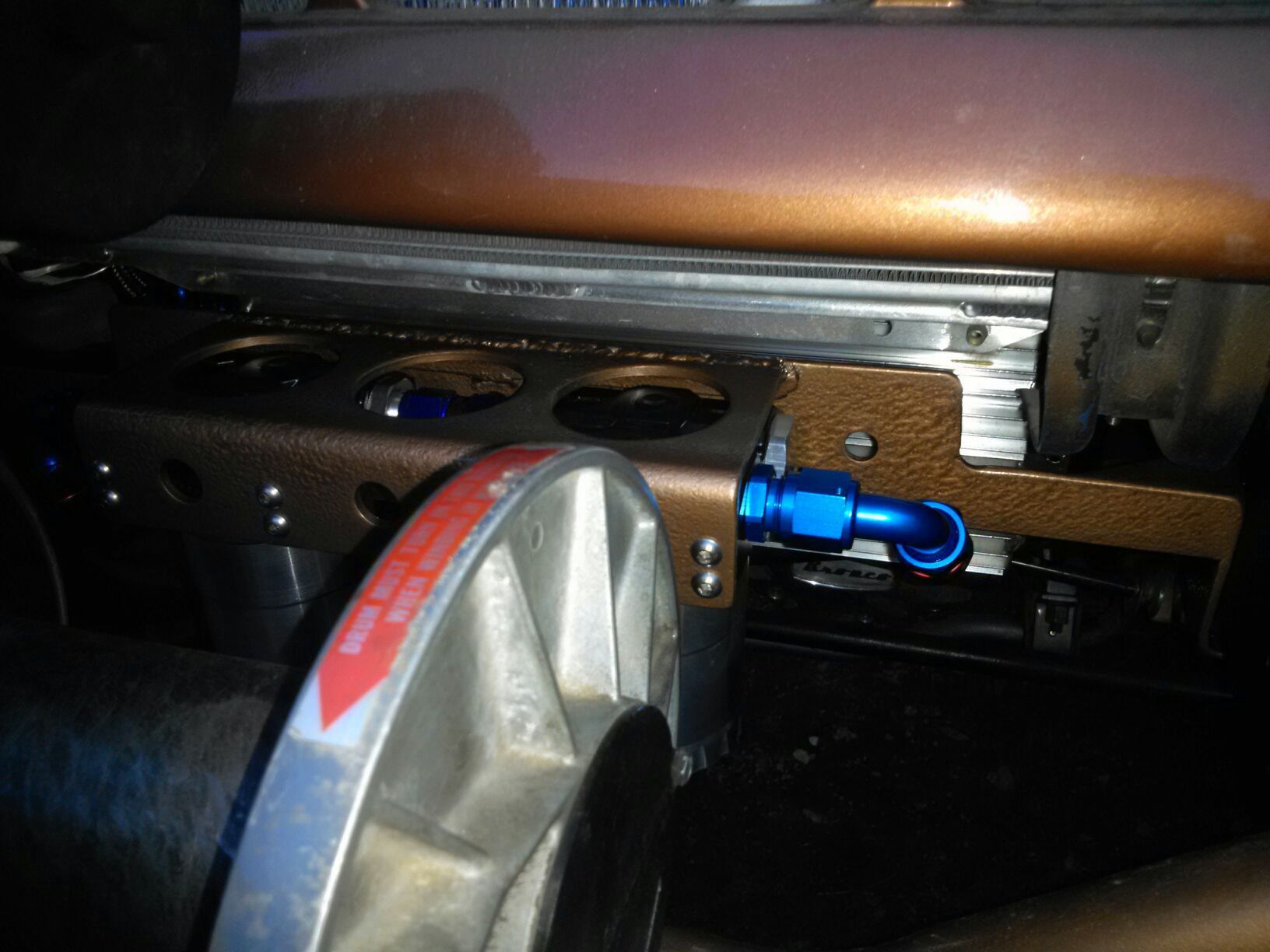

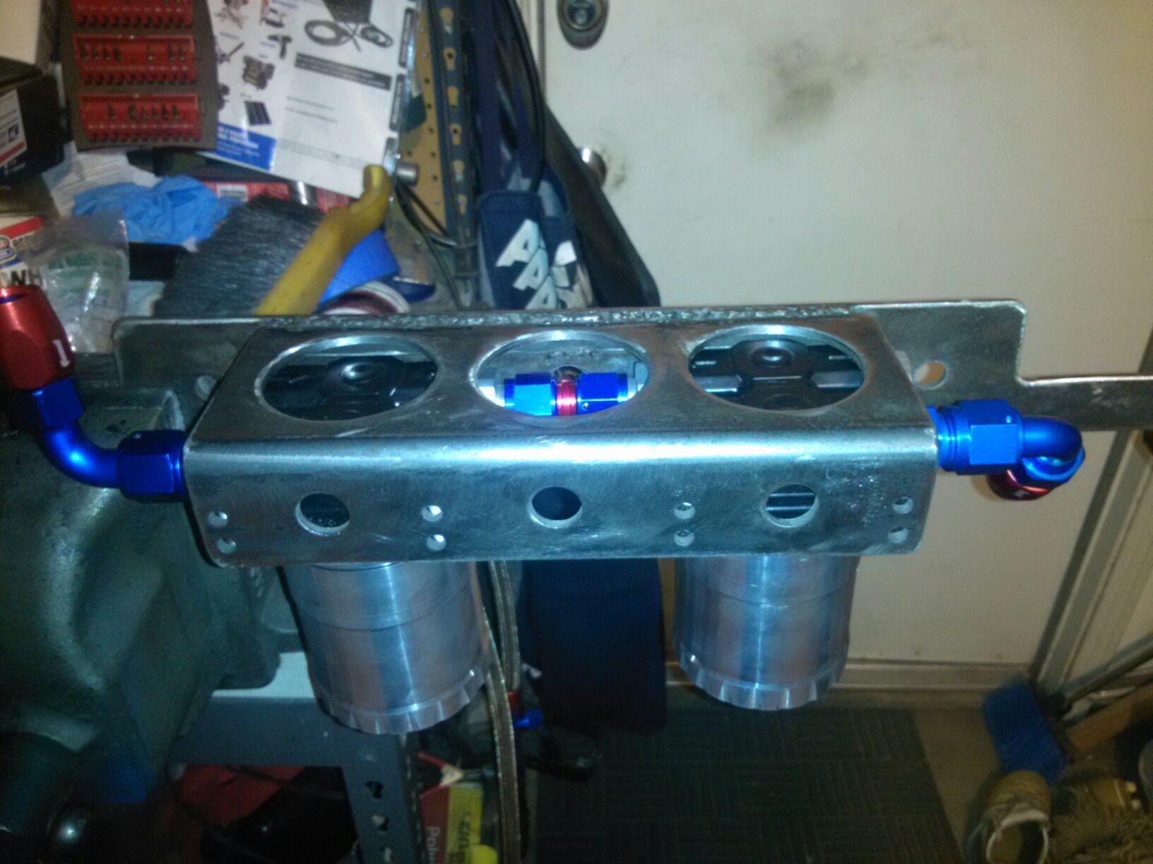

Here are a few images from my install.
The remote oil filter adaptor that fits on the block:
Note the labels indicating the direction of flow. It is important to run he oil through the filters in the right direction.
Here's why the curve of the lines was important in my case. Putting the filters further away would lessen this concern.
