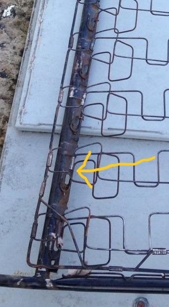

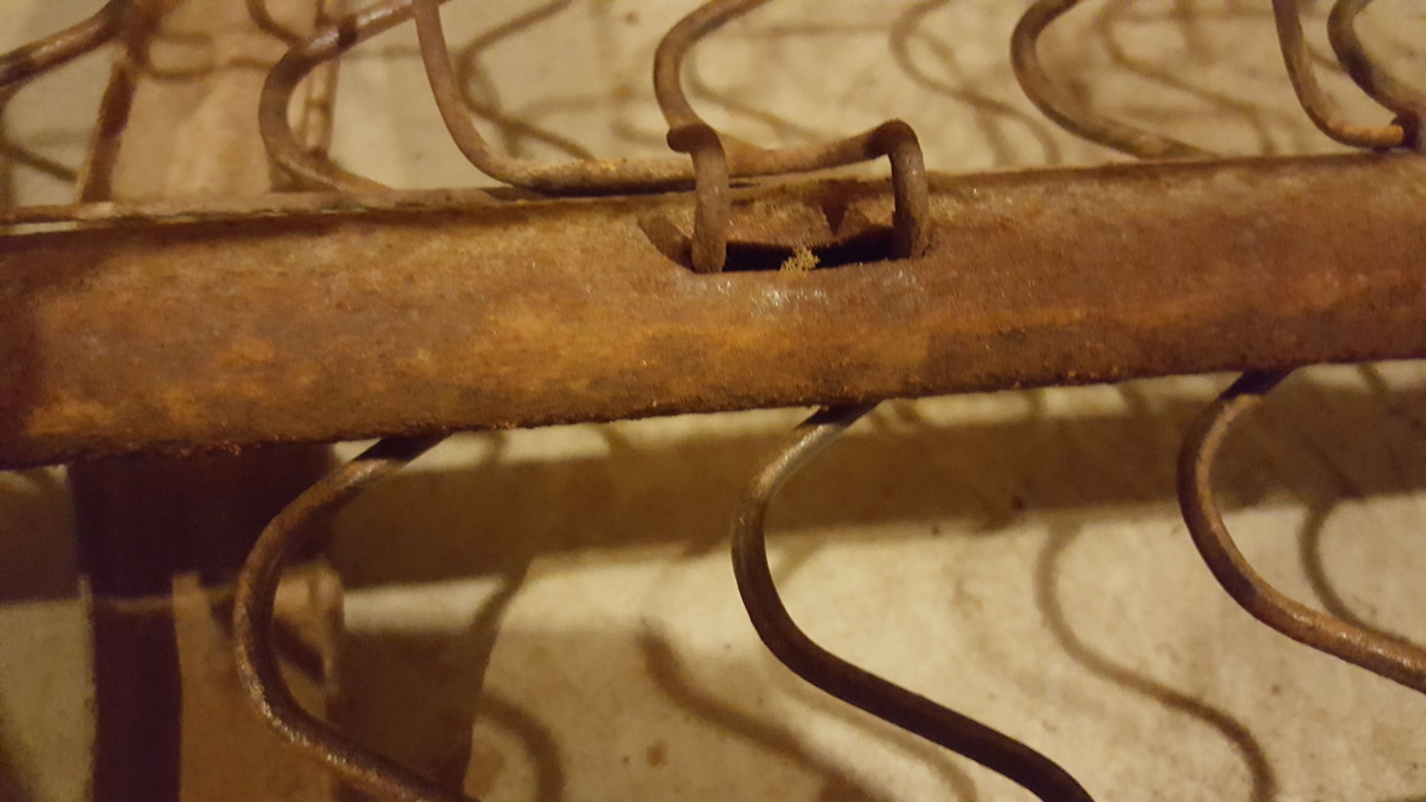

Are there differences between seat frames? "64"-"66"? I have seen a couple pictures and some look different than others. Was this a manufacturing difference. Or is it a incorrect seat frame for these years? Some springs insert into the frame, like the one in my "66". Some slip into a clip attached to the same part of the frame on another seat.

Are there differences between seat frames? "64"-"66"? I have seen a couple pictures and some look different than others. Was this a manufacturing difference. Or is it a incorrect seat frame for these years? Some springs insert into the frame, like the one in my "66". Some slip into a clip attached to the same part of the frame on another seat.I need to know why there is a difference or if it makes a difference. I need to buy a frame.

I think your difference depends on the cab setup. There is another recent thread on this forum asking for foam thickness and there's discussion there saying that the Custom Cab had thicker foam than standard due to spring design.
From your picture, that looks like my Custom Cab 66 seat, but I'm not an expert.

I have new upholstery and foam for a 66 Custom Cab seat, My frame is rusted enough I don't want to use it. I am looking at buying another frame. The guy sent pictures and the frame, at least the backrest seems to have a differently designed spring configuration.Is this a location of manufacturing difference? It is supposed to be a 64. Did they make 64 CC seat frames with this spring attachment design? I get pictures of the bottom seat frame tonight. I am assuming if it curves up. (Standard) Curves down(Custom Cab).
I have no idea.
Ford did not make seat parts or the upholstery, both were bought from outside suppliers.
Ford drew the blueprints, then asked outside suppliers to make bids. Usually the lowest bid won the contract.
Suppliers would sometimes make "running" design changes. Ford usually agreed with them in order to lower the price per unit.

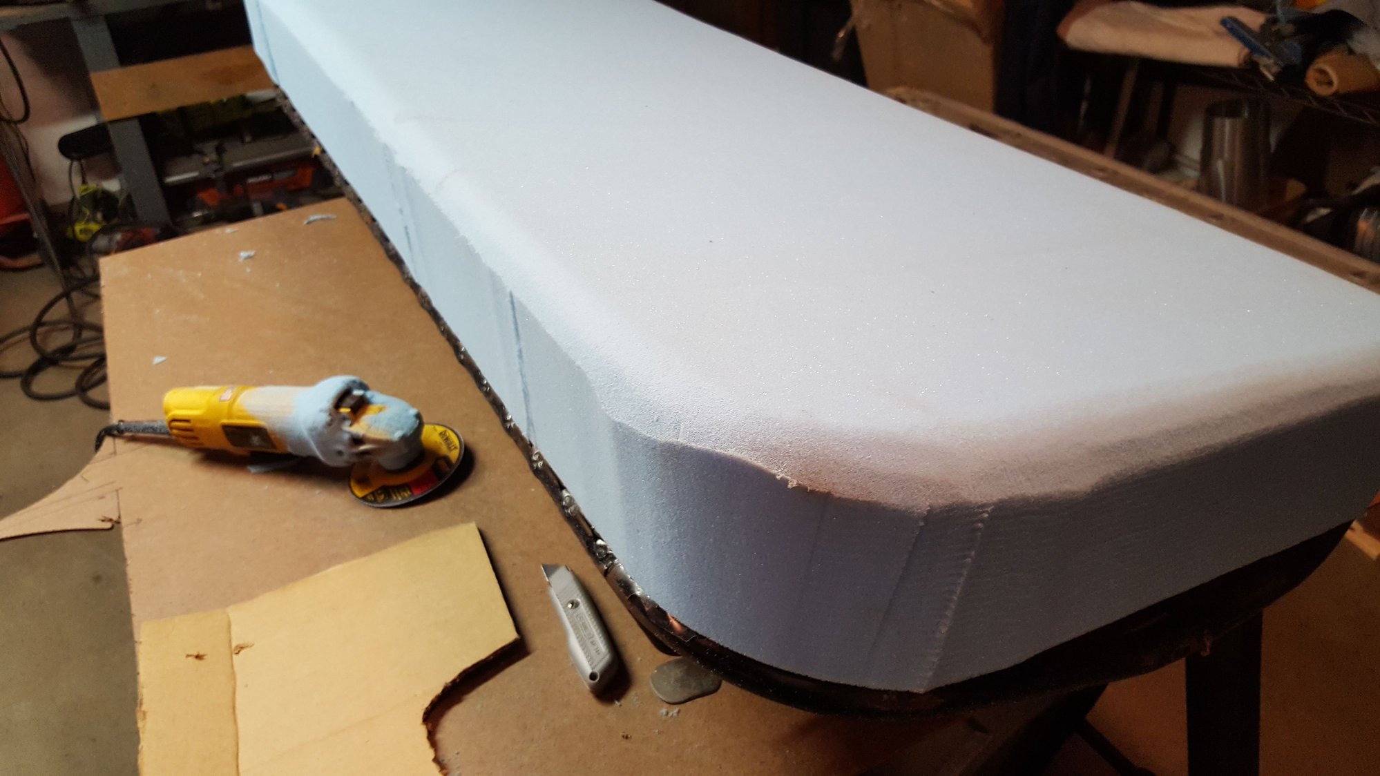

Made a jig to cut the foam with a electric knife.
It cut the radius and angle perfectly.
Tried a 36 grit flap wheel to cut the radius. That works well also.
