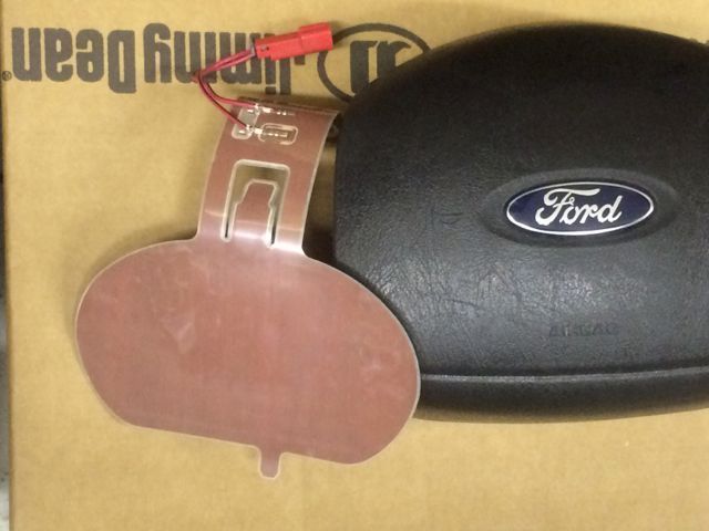

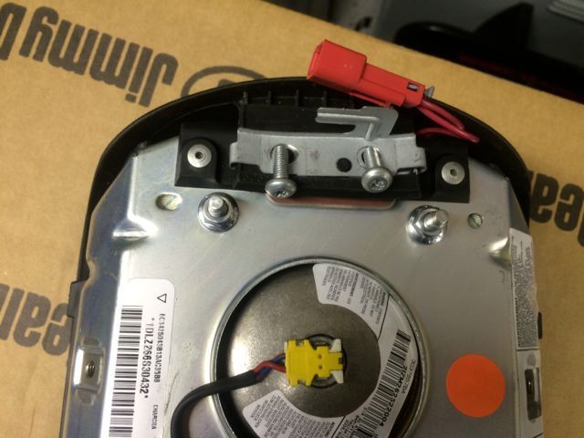

Same thing for me.
Here is the silly thing in my case full leather and controls in the wheel
Ford wants almost the same price as a new wheel for the switch. But
the switch tends to be backordered big time, So B&R Auto Wrecking
got me a new wheel with the air bag for $50.
One way to test for sure is to disconnect the horn switch and see
if it goes off or not.
Here are some photos of the switch and the torx bit you need.
Hope this helps. that switch just slips in if you can find a good one on a bad air bag.
