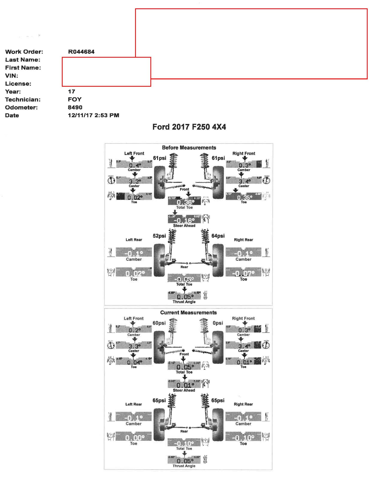

I installed the 2 inch BDS last weekend. Even though the truck feels good I still dropped the truck off at the alignment shop this morning. I'll know later today if its off or not.

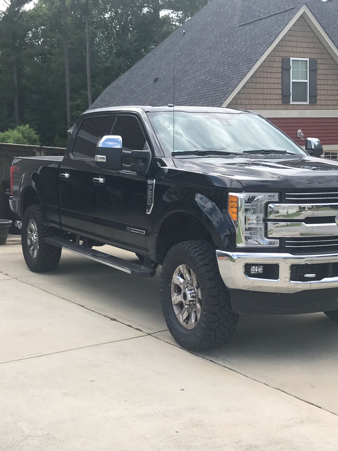

3 1/2" ReadyLift w/ Nitto Trail Grabblers 35 x 12.5 & Fuels 22 x 10 -13 offset

No alignment issues with my vehicle. I have 37’s with 3.5 Ready lift. You have to realign a vehicle after lifting.

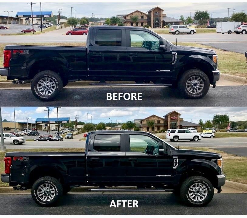

2.5” ReadyLift here. Alignment is spot-on and within factory tolerances. Some call for a castor adjustment, I spend allot of time on the road and don’t see the need. It doesn’t wear parts early or stress any parts, etc. All good. After ReadyLift visited the shop & trained the techs on Ford’s adaptive steering, they nailed my steering wheel alignment. It’s a good shop, they just didn’t know how to center the steering wheel properly. I really like the kit and the ride. Will keep the factory wheels and buy 35 X 12.50 Nitto Ridge’s in the summer.

My results from yesterdays alignment...

Looks like mine, toe was off from factory, lift didnt affect anything other than realignment of steering wheel. Did you put the caster shims in?

When ever you lift a front end 1/4" or 6" it will affect the tow in and you will need to center the steering wheel.
C_Smitty your #'s look good
Ya, I did install the alignment cams that were included with the kit. They were easy to install compared to taking the stock sleeves out.
