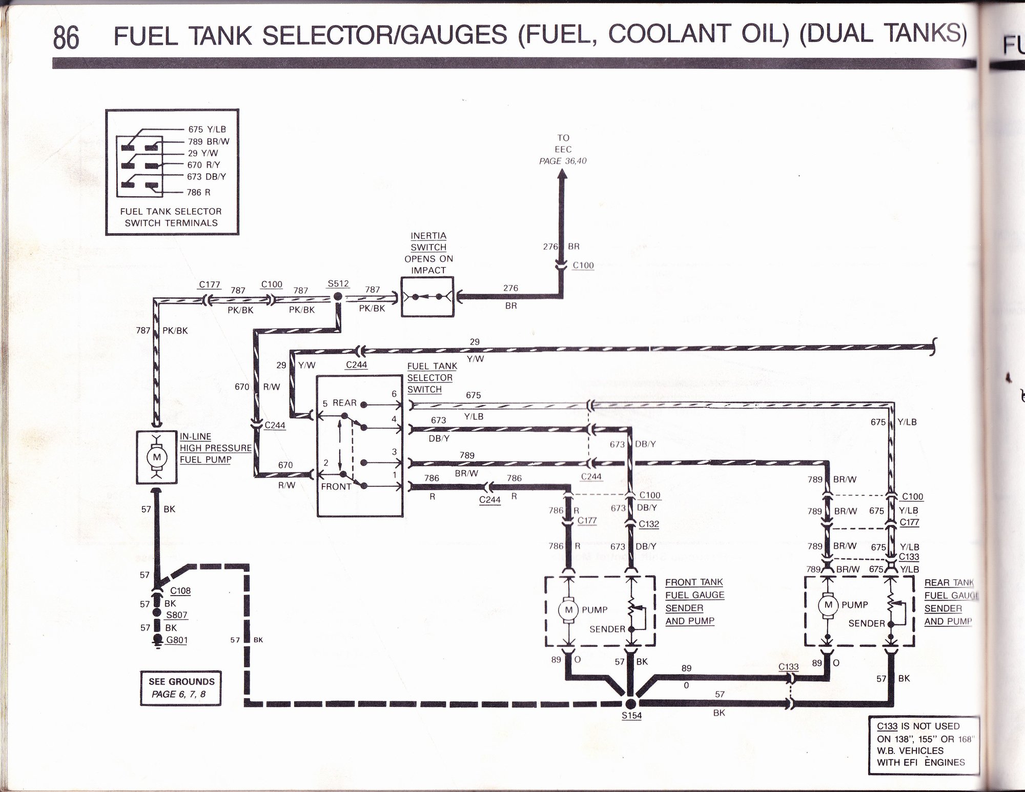

Thanks for that answer. Only thing I haven't tried is supplying direct power. I will try that to rule out the pumps. At least the high pressure pump, as that one is two wire, and I don't know which two, of the four wire connecter on the front tank are for the pump.

Your color code for your Front and Rear Pumps; R - Front; BR/W - Rear
