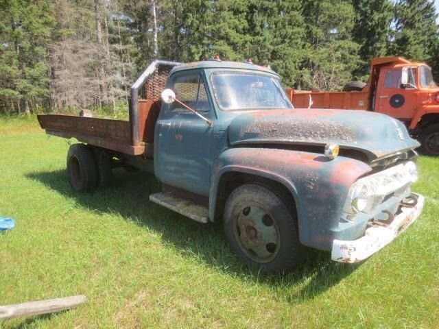

Got any pictures of your truck?

Only picture i have of it from 2 years ago when I bought it. The axles have tubeless 17.5 wheels so I'll be using them. Truck has widowmakers on it and Id rather have radial tires!
