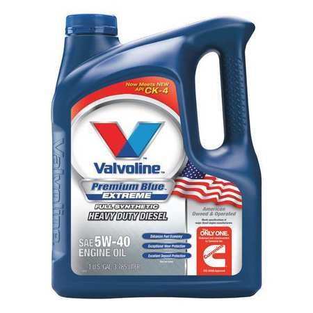

Valvoline premium blue extreme synthetic. Defiantly made the truck quieter too. I would run motorcraft synthetic but it’s impossible to find and expensive at the dealer.

Originally Posted by Timberwolf2017
I run Rotella T6, 5W40. Rotella is recommended by Cat, Cummins, Perkins, Mack, ETC
Valvoline PBE seem to be the only one for Cummins
That's because Rotella (called Rosmella by the Dodge boys) makes the Cummins smell like a polecat. I love Rotella oil, but quit using it when I had the Cummins. It smelled so bad that it was embarrassing to take my daughter to school.
The Powerstroke is a different animal all together. (definitely not a polecat)
