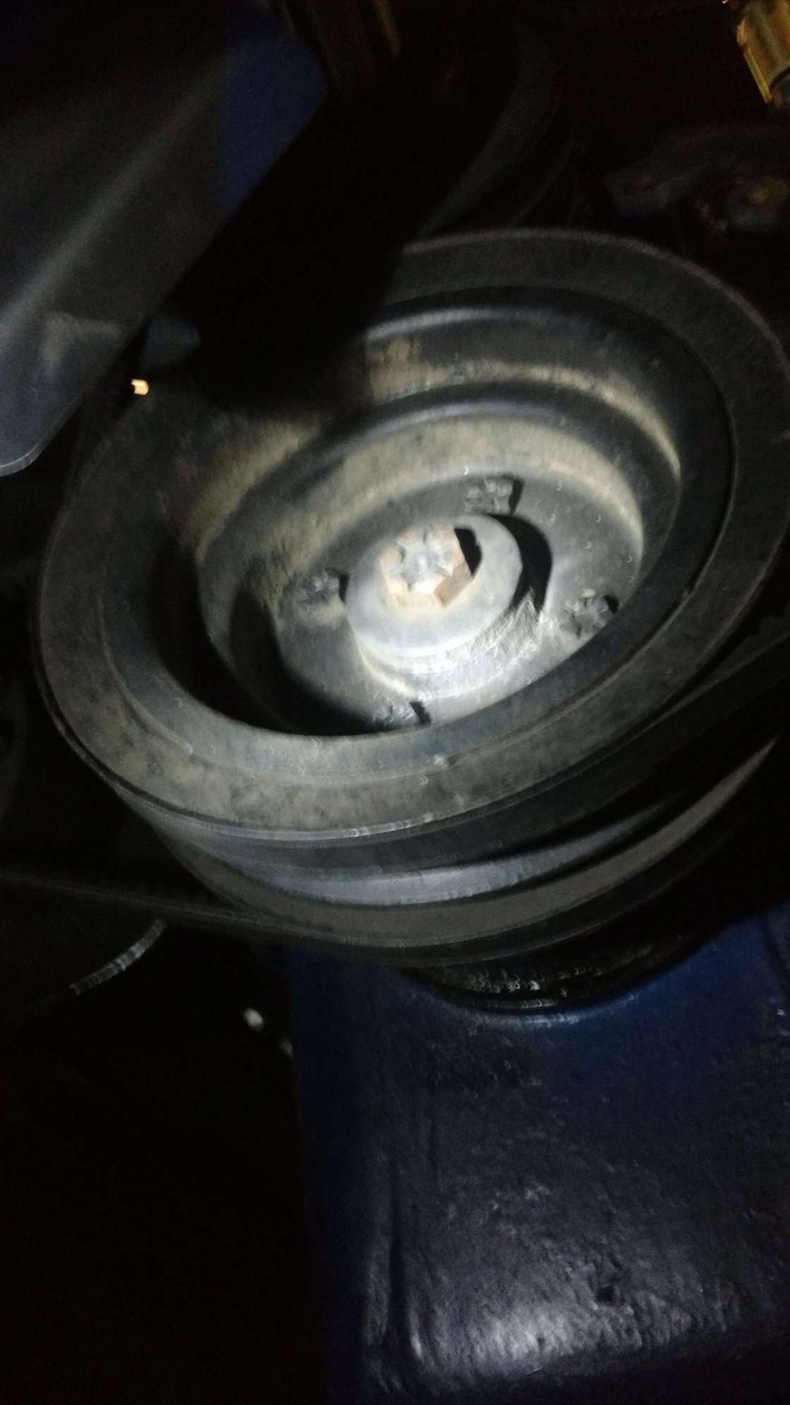

Now the harmonic balancer Might have came from the 1978 351m. Or it may have been stock to the original core 460 which if I remember correctly came from a '73 car engine. Or it was something that happened to come w that used 460 I originally bought. An I going to run into issues using it?

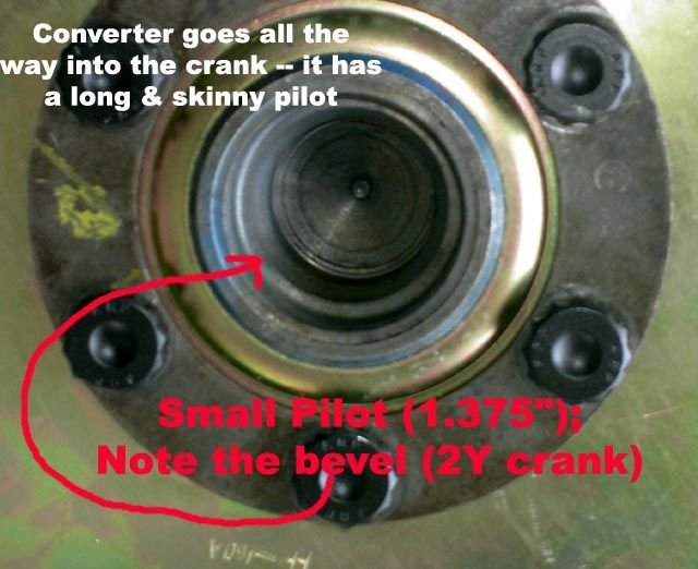

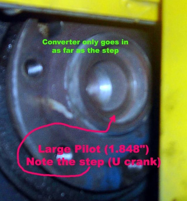

Ford changed crank pilot design on these in 1971. Each design used a different converter. The flywheels should be the same, but the converter must match the crank.(see pics)

Going to have to wait till the tranny is dropped to measure that.. I shouldn't have anything pre 1971 on that truck though. Maybe I didn't see that when I ordered the converter though.

Now I have the trans out. All of the bolts were tight. Flexplate is NOT cracked. The crankshaft pilot and tourque converter ARE the correct 1 3/8 match for each other. I can't find anything wrong.
