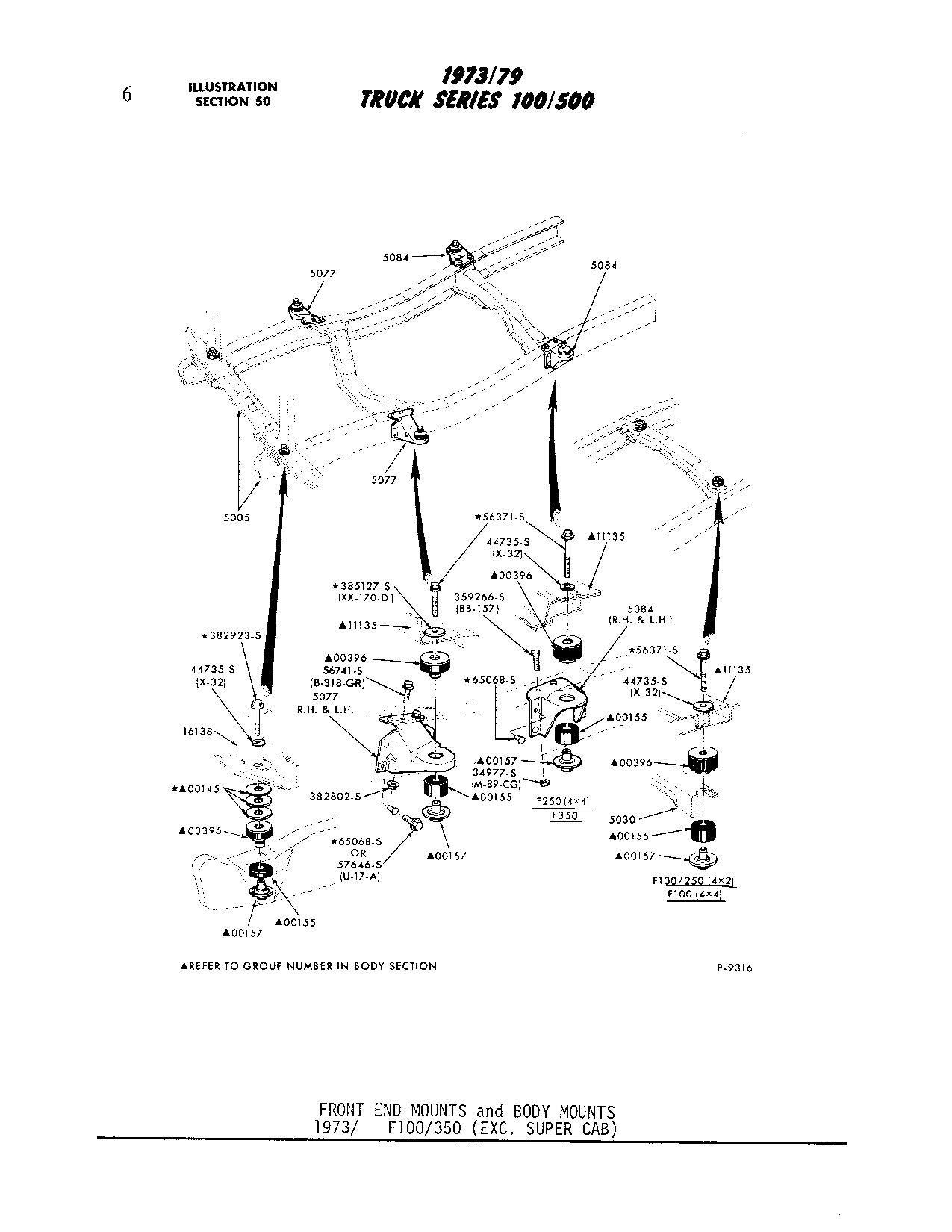

I have a 76 F250 highboy that had some nasty cab mount bushings on the passenger side of the cab. I bought the polyurethane set from LMC, got the old bushing and retainers off and apart on the passenger side. Resused the retainers, since the kit didn't come with hardware and was told to reuse the old hardware. My problem is the driver side is much more difficult, the hardware is stuck together and it ain't coming apart. It's looking like I gotta cut those suckers off but I cant seem to find replacement retainers. Any suggestions on hardware? Anyone who has used and replaced their bushings with the polyurethane set from LMC got tips?

Some stick pretty badly,,I had my cab off so I was able to cut out the bushing from around the hardware , and lucky enough the bolts came out , so I cut the top of plate off hardware and was able to drop it out and then used a torch to heat cherry red and was finally able to separate the sleeves and plan on welding the top back on the one sleeve to reuse,, other option is to make your own as you can buy sleeves and weld on top plates an lower nut and with the one you did get off you can use as a pattern ,,and you can buy the lower sleeves from 1973-1979 Ford Bronco and F Series Truck Body Mount Sleeve, Large Lower-Broncograveyard.com , there are 3 types front radiatorsupport front an rear cab but only the lower part , still have to make upper

Broncograveyard.com appears to have body mounts.

I did my cab mounts back in 2007 and i know i got them from LMC, they came with new (the bottom piece with the nut built in) but i think they were the standard rubber set. If i recall they did not advertise that they came with new ones, but was pleasantly surprised that they did. My issue was that the frame portion was rusted thru as big as the bushing was and i had to weld in some very large washers to fix it. Yay for salty northern roads.
