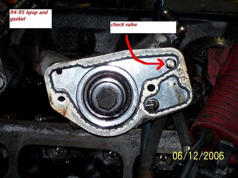

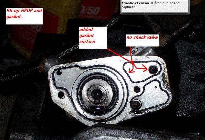

Old Nov 25, 2017 | 09:24 AM
fordman67's Avatar
fordman67
Joined: Dec 2005
Posts: 14,376
Likes: 605
From: evansville in
Originally Posted by blue66tang95f150
ok guys. What’s the difference between the gaskets?
A 94/95 gasket on a 96^ engine will let resivour drain back. Mine had an existing condition when I bought it. It took a bit with some smart people helping to figure it out.
